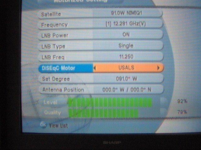

On your true south satellite, go into motor settings and select USALS. You need to enter your latitude & longitude and then the motor will move. You will need to change all satellites to USALS for the motor to move
