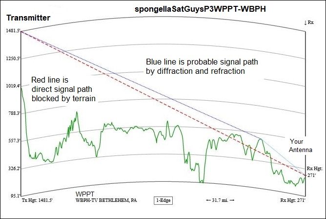

Temperature inversions do occur rarely here. Fading occurs only with distant stations such as WPPT. I use rabbitears as a guide, yes. I use one of those 150 mile (more like 50 mile) rotatable antennas. I know they have a bad reputation but mine works for me, with the exception of the aforementioned signal fade.
WPPT is a guest on the WBPH transmitter on RF 9.
The "150-mile" antennas do work, but they often break down. You only have a folded dipole for VHF-High and you are not LOS for WPPT/WBPH:
