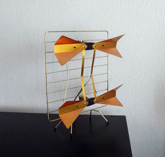

I called Dish tonight regarding my 211 issue and of course they had me do the same reboot , rescan etc that I have already been doing. They insist that it is something to do with the stations transmitting the signal and not the receiver. Would not let me return the receiver since everything else was functioning. I am using an RCA power antenna.
