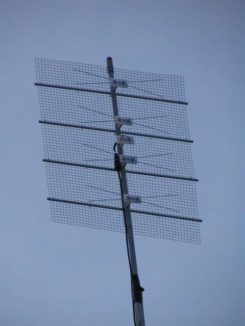

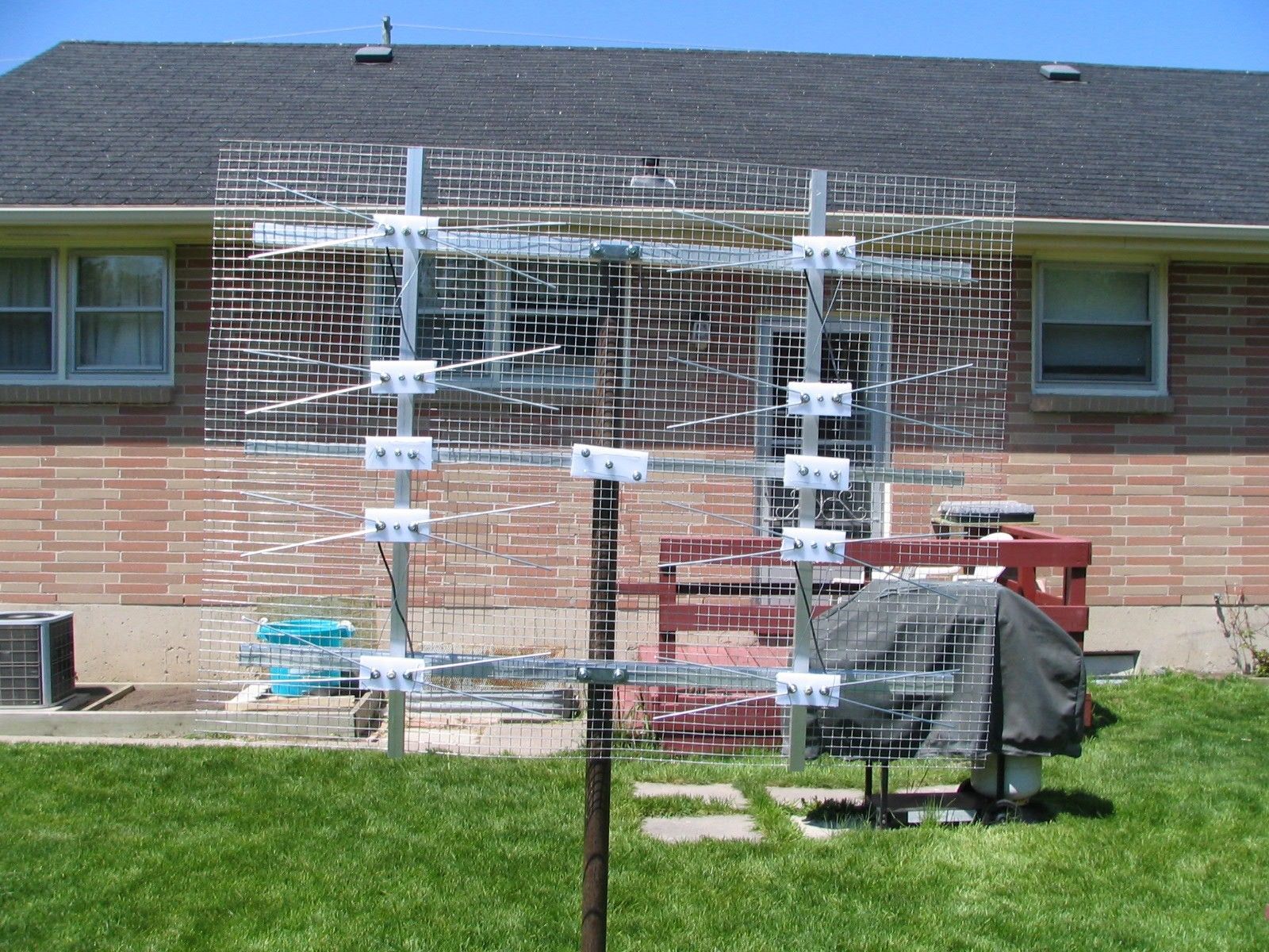

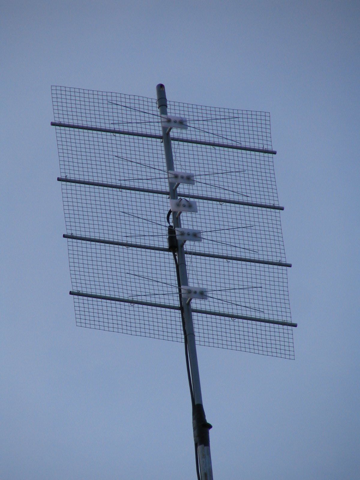

I found this thread somewhere on SatGuys. DIY HDTV antenna - Lumenlab
It is all about building your own HDTV antenna. It looks very easy to do and costs practically nothing. They are copying the DB2 and CM4228 designs. Very interesting thread.

Works great ... here are a couple I have made.
