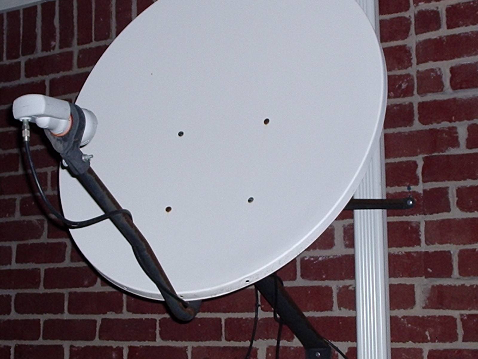

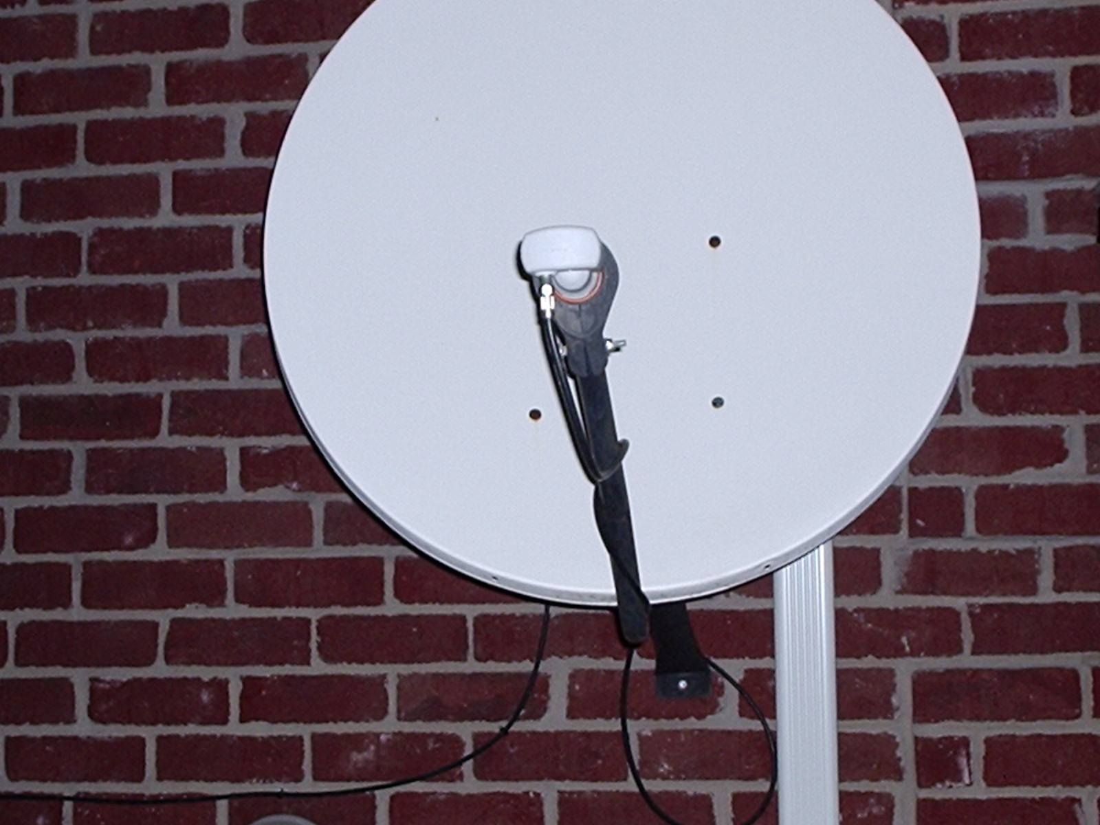

Here is a dish that for T5 and G3R. However, the signal quality is in the mid 40 only on both.

Sksatellite is a professional satellite installer with MANY years experience!
He is pointing out that with an Invacom LNBF it is possible to pick up two satellites, two degrees apart at the same time!
I have heard of this being done in the past, thanks for posting SK!
RVD420 said:
Re-peak your dishes and make sure you set the LNB skew properly.
In our location, 90% of the LNBF will set at 0 degree skew, this included Incacom LNBF, we can use 0*skew from G3R to AMC 4 without any problem.
With the two satellite setting, one / ten of degree off, you loss one side of the satellite signal, this make it very hard to work with. :eek:
