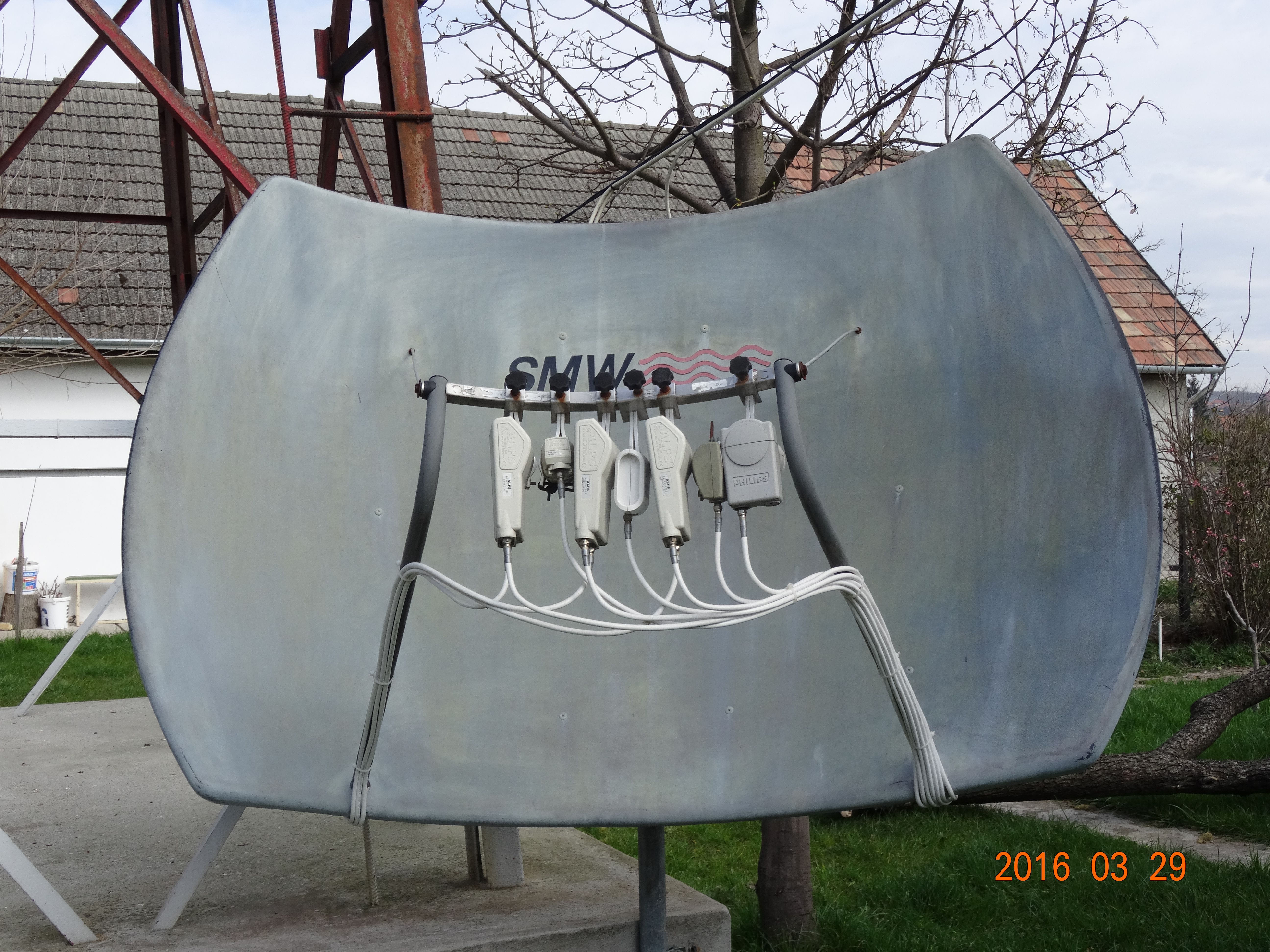

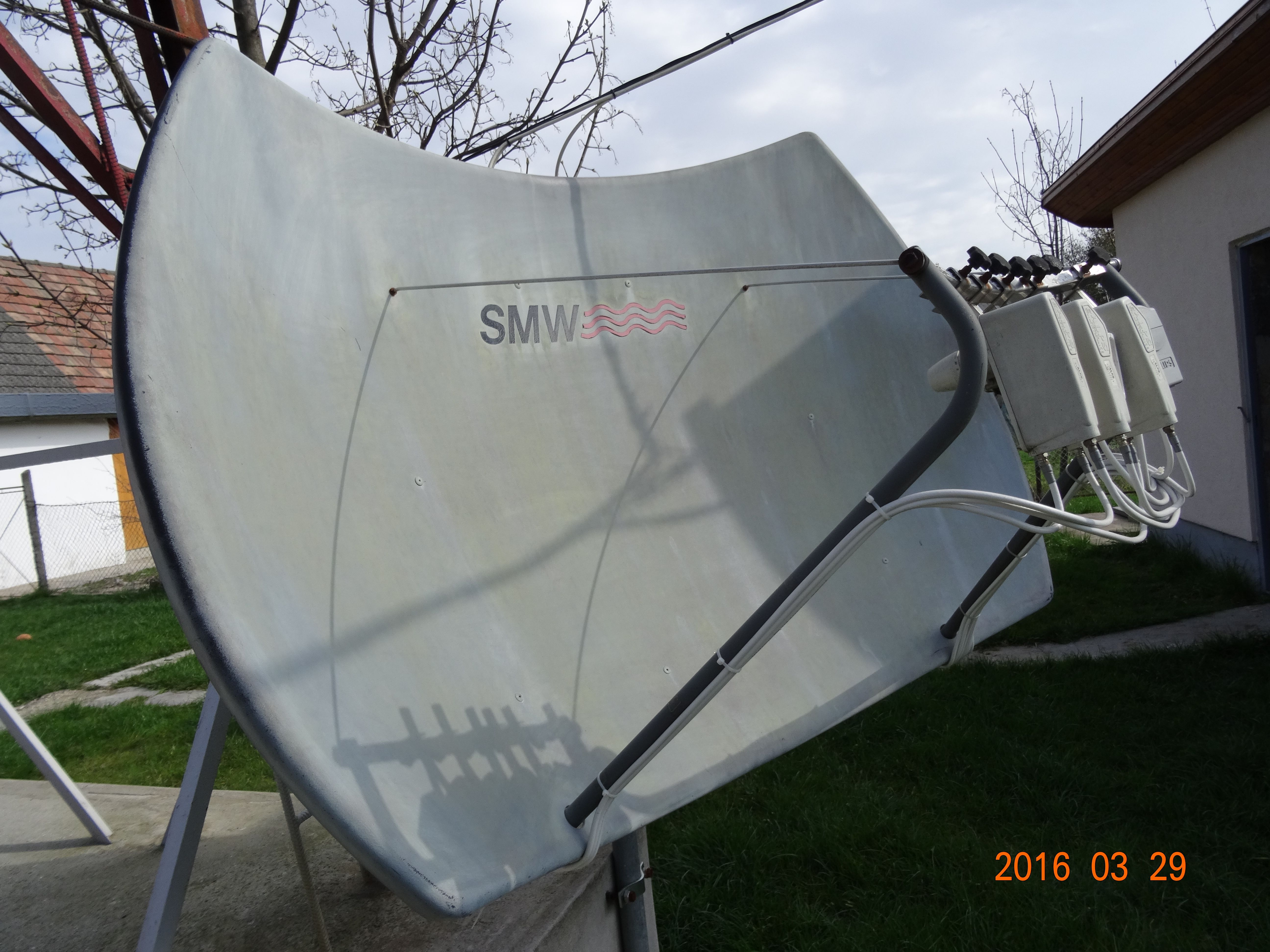

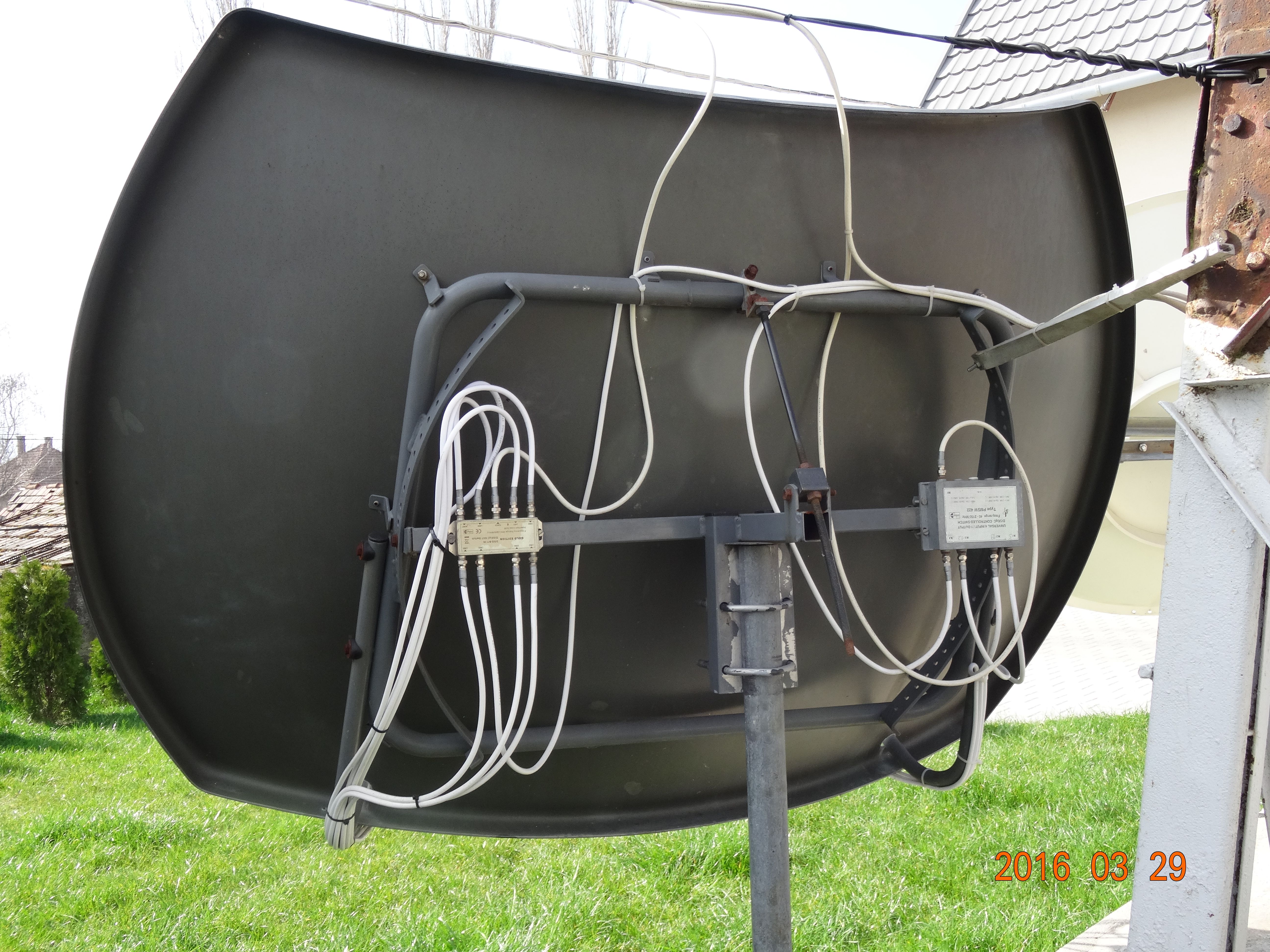

Could you show some pictures of your dish? Interesting to see..... there are not so many such a dishes around.
Thanks!
Here are some pictures of the dish. The forum wouldn't let me link them so I had to upload.

Signal strengths on the dish pictured above have started to fade and now are pretty much useless. If I pour water on it, signal strength jumps by about 20%, so I'd guess something has happened to the reflective layer.

I would not go for such a radical measures as re-painting the dish! From pictures you showed a year ago I see that surface of the dish is in good shape. TBH, I do not believe that something could happen to the reflective layer, cuz it is not surfaced at all. You better check maybe something is wrong with LNBs, connectors, Diseqss or all the wires. Try to retune antenna from "0". This dish is very robust and it will work for you long time, certainly longer than any other nowadays made of tin antenna.
