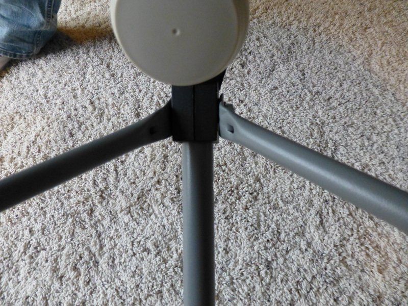

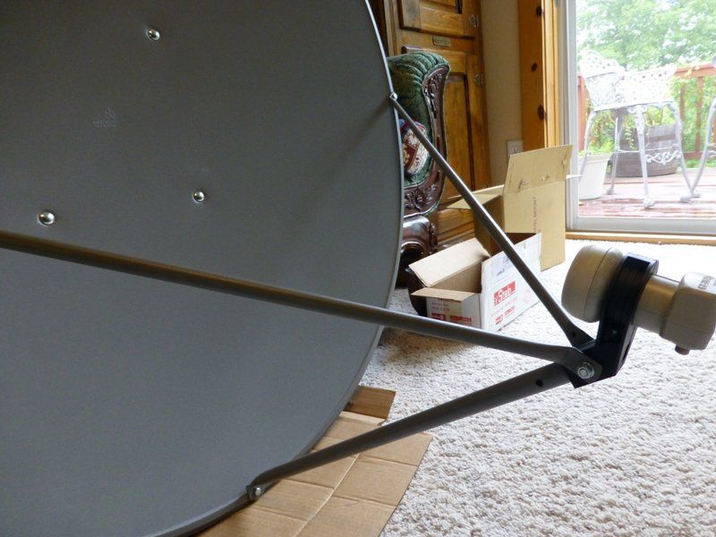

Question about the GeoSatPro 1.2 - It seems like putting those three bars on to hold the LNB is a bit sketchy. Does it tight down and align pretty good to where it should, or should i be doing some checks on that. (Which, i wouldn't know where to begin with that?)
It took me almost a month to get mine lined up. I now have 19 satellites I use. A few more I pickup with nothing to see. I was mad when I twisted the dish and told myself I give up and went in the house. I turned on the receiver and it was picking up 97w. I went to 95 next and everything came in better than my stationary dish. Keep on going
I see that you've attached the side struts at the LNBF holder. That is the way it is shown in the diagram. I've seen them attached in the lower position also. I tried it briefly in both places. I didn't note a difference after adjusting the dish elevation slightly. I just left them on the lower position to allow for easier LNBF holder swaps and because Titanium has pictures on Facebook of his C1-PLL C-Band PLL LNBF and CS1 Conical Scalar on a 1.2m using the lower hole. I am curious about the purpose for the lower hole if it isn't for the struts.
