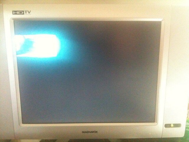

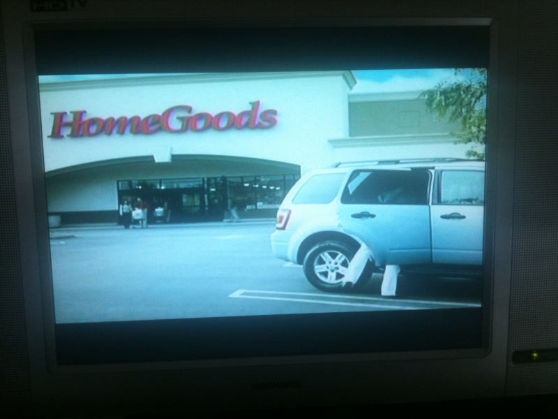

Scott do you know is this is a bad bug or something. I notice that when I go into sling and watch it or on my iphone mirroring something off of tuner one will not show the guide or anything only the picture here is pictures of my tv in the kitchen.
TV2/Sling does not show manus (or the guide) if you are streaming in HD.
If you are in SD the menus show fine.

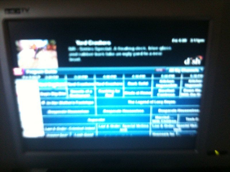

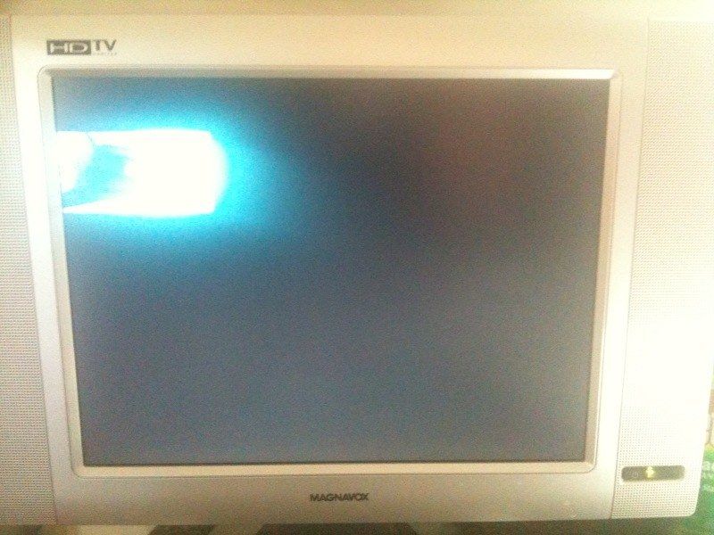

I am streaming in SD of the coax and to the tv's. If I reset the box I get the guide and everything back. when I go to view remotley from iphone or the website it goes back to the all black in other posts picture.
