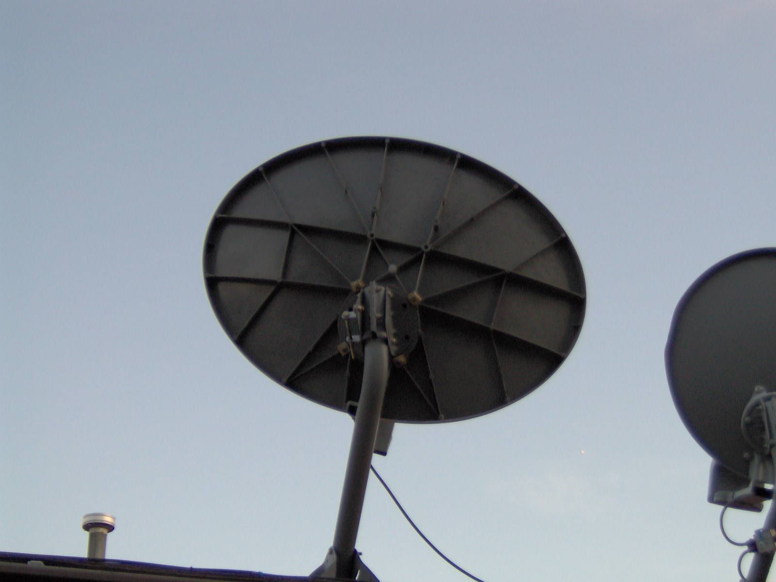

When trying to put the motorized on the deck railing, I had issues getting 101, 103 & 105
Figured out what it was...a LOS issue
But not a tree, the roof, or something like that...Here is what is giving me LOS issues (see picture) :)
I'm kind of like you with the setup on the deck
I can see from 58-97 no problems
101-105 nothing
121 barely a signal
123 nothing
My Dish500 is blocking the other ones! :)
no I'm not
Its the truth though...Spent 30 minutes figuring out why 101 didnt come in. I thought it was my motor setup...after talking to PSB figured out it was the SC dish
so the dish is back on the roof
As I told Cascade, if I could get 101, I’d leave everything where it was
103 doesn’t really have anything I need
105 is just a test card
121 is just a test card
123 I have a separate dish for
But after working with it for 3 hours in the humidity (damn it was humid Saturday) and busting the bolts, I put it back where it was (on the roof).
Had to move the dish to the east 2 clicks to get everything back to normal…and I actually gained some points on a couple TP’s :D

I have a DirecPC dish on my deck that shoots over the 18" dish on the roof :)
I was trying to get some of the dishes moved off the roof for easier access :)
I might take down the SC dish and use the 30" I have (had) up for G10
I measured last night and I need 3 inches to make the 36" work on the same setup as the 30 is right now :(
