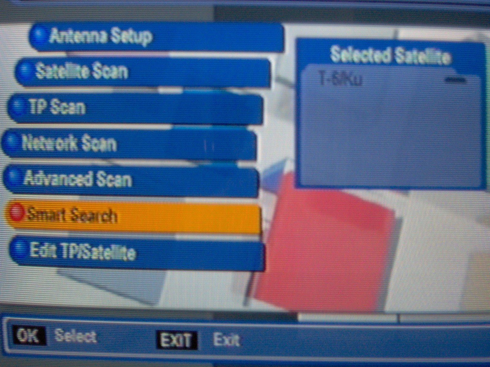

When I go into install (menu-install..(password) I get this screen
smart scan is the same as blind scan
different scan options
-satellite scan scans a particualr satellite (both Scrambled and free show up)
-TP scan scans a specific transponder on a satellite
-network scan I have never used but it has something to do with scanning like symbol rates
-advanced scan allows you to enter PIDS on a scan
-smart scan is the same as blind scan
-edit TP/satellite...self explanatoyry. Allows you to manually add or edit TP's
