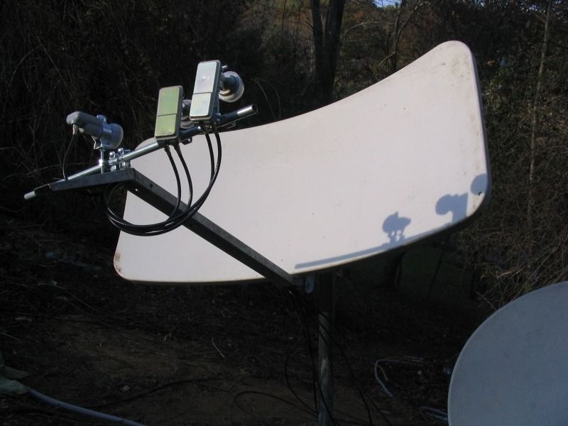

Have any of you ever seen a square c band dish,I know where one is and I will take some pictures and post when I get home.
It could be an Excalibur...they made a square prime focus dish. Pico made a rectangular C band offset dish. I have 2 Prodelin 1 meter commercial dishes that are rectangular.

no no no! It is circular! a parclipse is like a big ocatgon instead of a round rim. Also there is a few small wrinkles and dents in my dish will this hurt my signal much?
