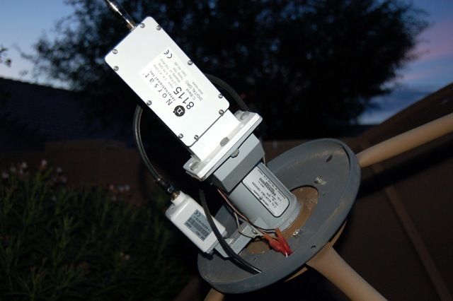

This pic is a pic of a waveguide I plan on comparing to my QPH-031 on linear Ku stuff. One LNB does H and the other does V. I have a multiswitch left over from my Voom install that will combine the H/V onto a single cable like a 'normal' LNBF.

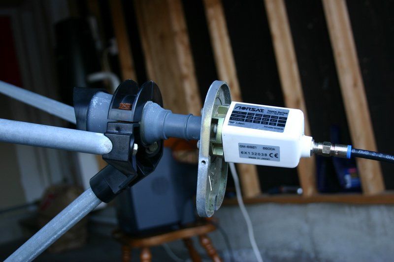

I'm not too familiar with all the terms but I will describe it as best i can.
The LNB might be WR75 (i'll have to look more closely when I get home) but it looks like it from the small pictures I can find on the web. The lnb is about 1.5x1.5x3 inch small rectangle with one coax output on the end. From the flange on it is basically a small tube expanding into a feedhorn with some plastic covering the end. The whole assembly rotates in a collar which is attached to the 3 arms going back to the dish.
I guess I will have to get a new lnb if this is the case.

Just looked at your link and it appears the small KU lnb on your feedhorn looks very similar to my NORSAT. Also to answer your question from before: NO, there is only the cabability to add 1 lnb to the waveguide/feedhorn.
That certanly sounds like single polarity then. You'll have to rotate the whole waveguide (if possible) to get the other polarity.

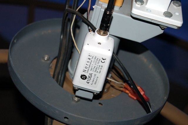

These Norsats are single polarity LNBs. Sounds like its on a Channel Master dish, from your description. Just un-bolt the LNB from the C-120 flange and rotate it 90 degrees for the other polarity. See pics...
EDIT: Attachments uploaded... This assembly is currently mounted on my 1 meter Channel Master aimed at G-10R :)

I took the LNB off the flange last night and indeed I only saw one probe in there. Because I don't have any other waveguides and don't want to spend too much money on this dish (you are also correct, it is a 1.2M channel master) I just installed my Invacom lnb on the dish (it has a 40mm clamp so it fits nicely).

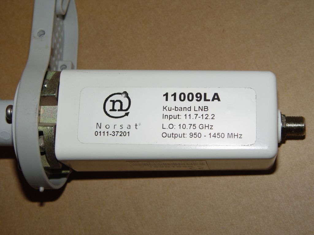

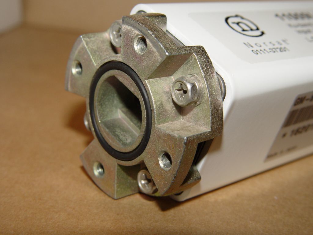

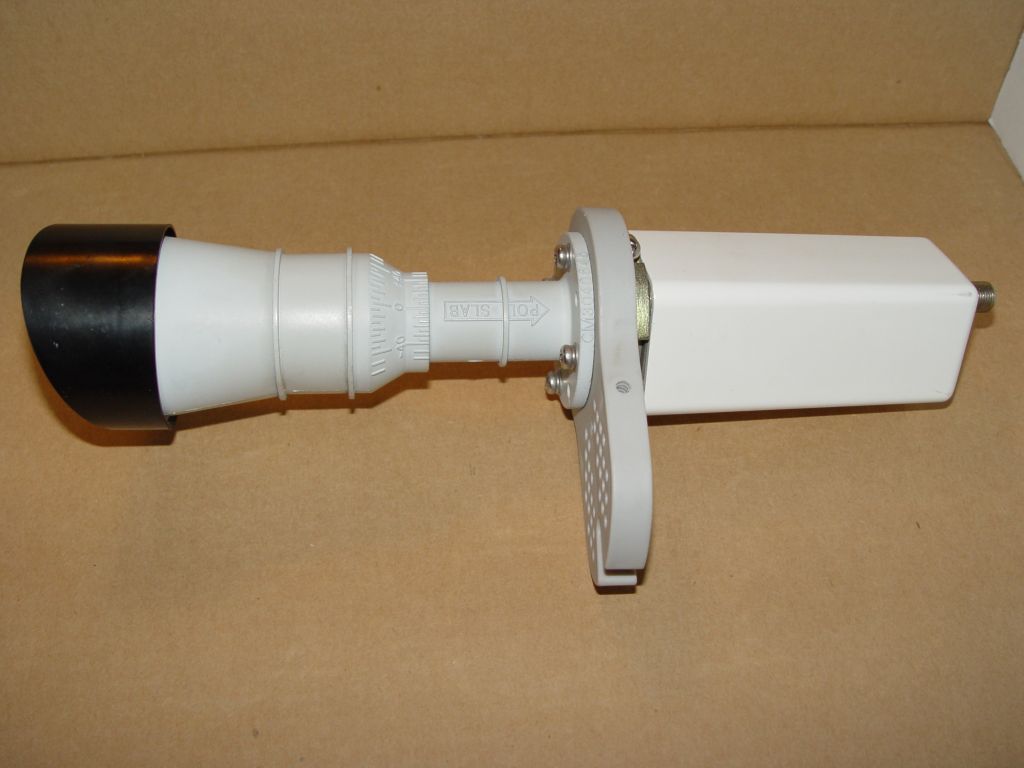

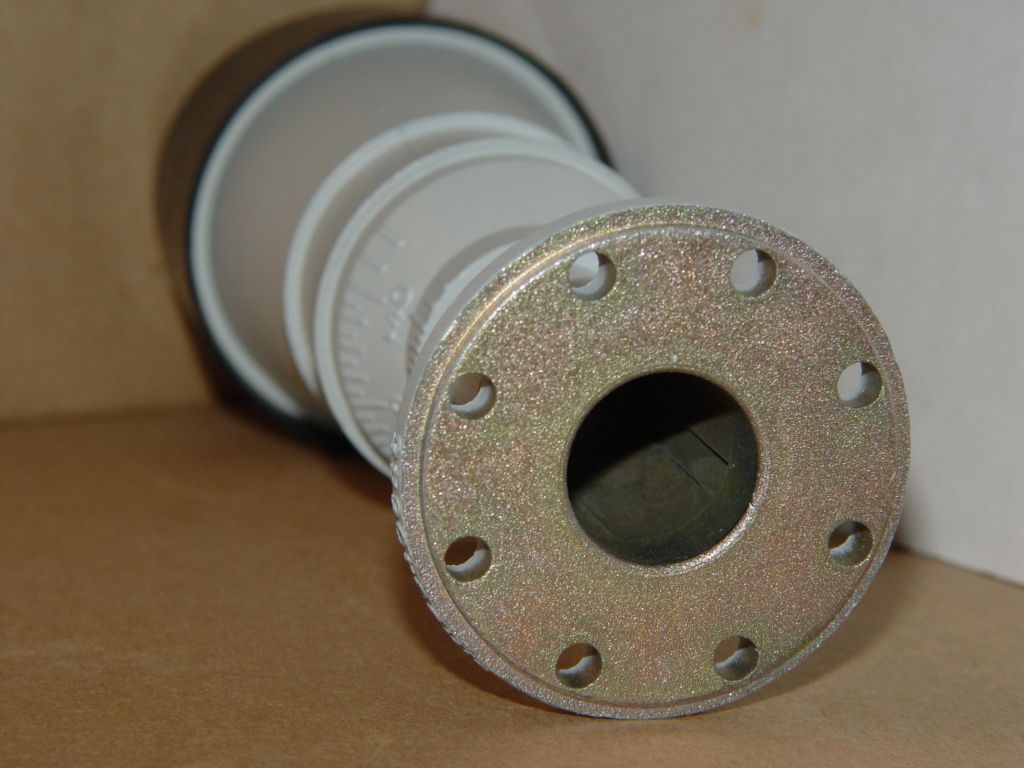

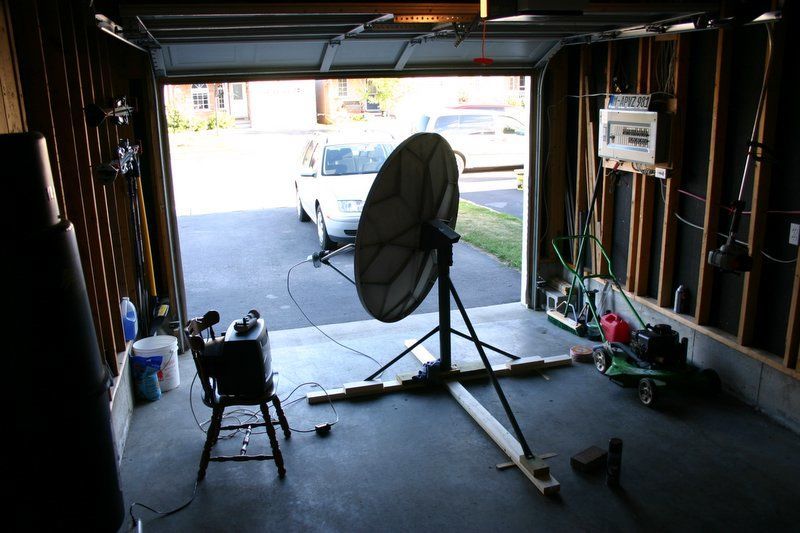

I've tried to attach (hope they work) an image of the norsat LNB i have plus the waveguide/feedhorn assembly attached to it. I've also attached a pic of my current setup which supports the dish in my garage.
I had to set it up this way because the one side of my house is where I have all my satellites mounted to see from 61W to 148W and unfortunately to see from 12.5W to 61W I need to mount a dish on the front of the house, which the old lady says is unacceptable. So I have temporarily setup the dish at the front of the garage to see what is out there on the atlantic sats and when I am done with it I will probably give the dish away on this forum, and if there are no takers, I'll part it out, failing that it'll be getting cut apart and taken to the dump.
So Far I have been able to tune (with great signal quality), Hispasat @ 30W, mystery sat ( NSS7 or I905 ) and Telstar12 @ 15W. Will try to get T11 and PAS3/6 tonight, and if I get ambitious I will try to shoot for atlantic Bird 1, which is quite low for me (4.5deg elev). BTW I am near Toronto.
