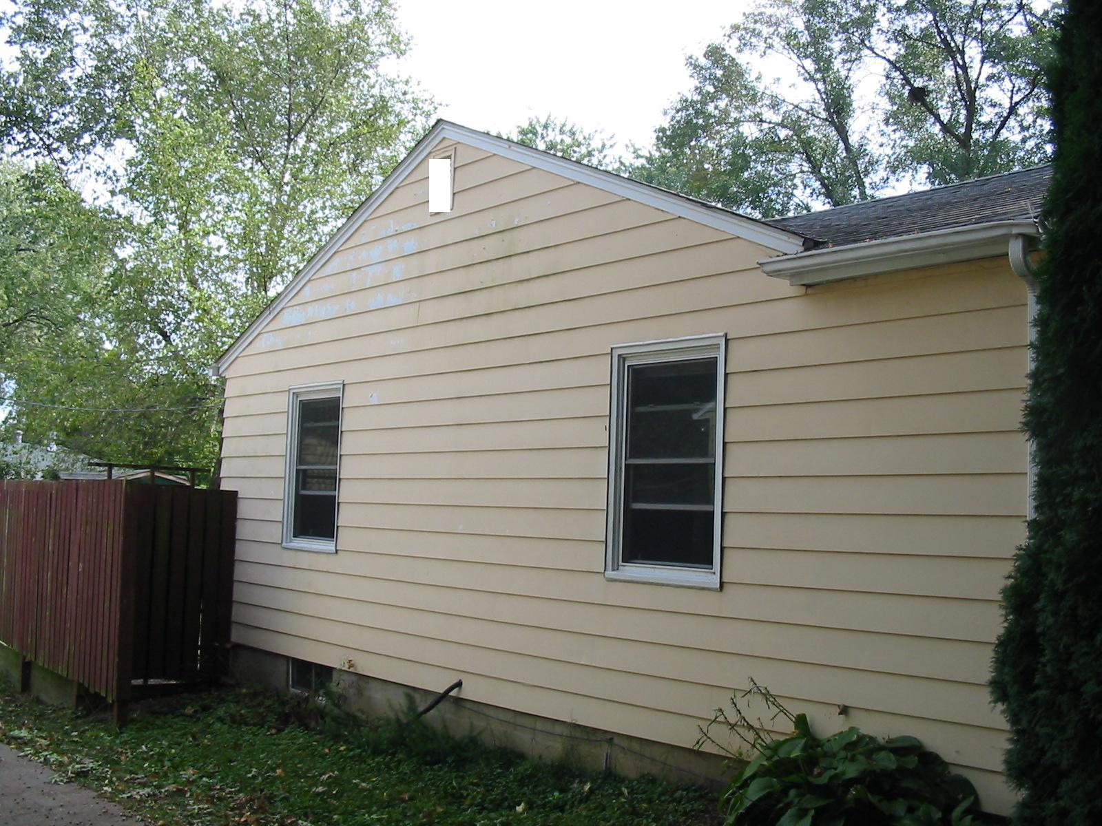

Hi. Well, I'm going upgrade to HD soon (currently using a ota antenna), also directv customer for about 5 years or so. Was wondering if it is possible to mount a hd dish on the peak of a north facing wall (still trying to avoid roof), so the dish is above the roofline (my sd dish is in this area so LOS should be good, new dish will probably be same height). Is it possible to mount the monopoles back to the side of the house (north side).

You MAY be able to mount your dish like you want to. It depends on how deep the eave is. Can you post pictures?
Sure. My house is just like this picture, WITHOUT the vent. So basically, it would mount where the white rectangle is in this picture (no vent) . This wall is north facing. My concern is if the monopoles can also some how be installed downward mounted into the house while the dish is facing ssw (overlooking the peak of the roof) . Thanks so much for any help.

Shouldn't be a problem ....
Make sure you hit at least 1 solid piece of wood, hopefully you can get 4 bolts into the wood. (for the dish footprint.
The monopoles should work ok as well.

Ok Thanks. I was a little unsure of this, since I havent seen monopoles mounted downward into the side of the house before. I was looking for a picture somewhere online to show them what I wanted.

With the monopoles what you are looking to create is a very stable tripod type mount. Doesn't matter what direction they go, as long as they form a very solid base for the dish.
