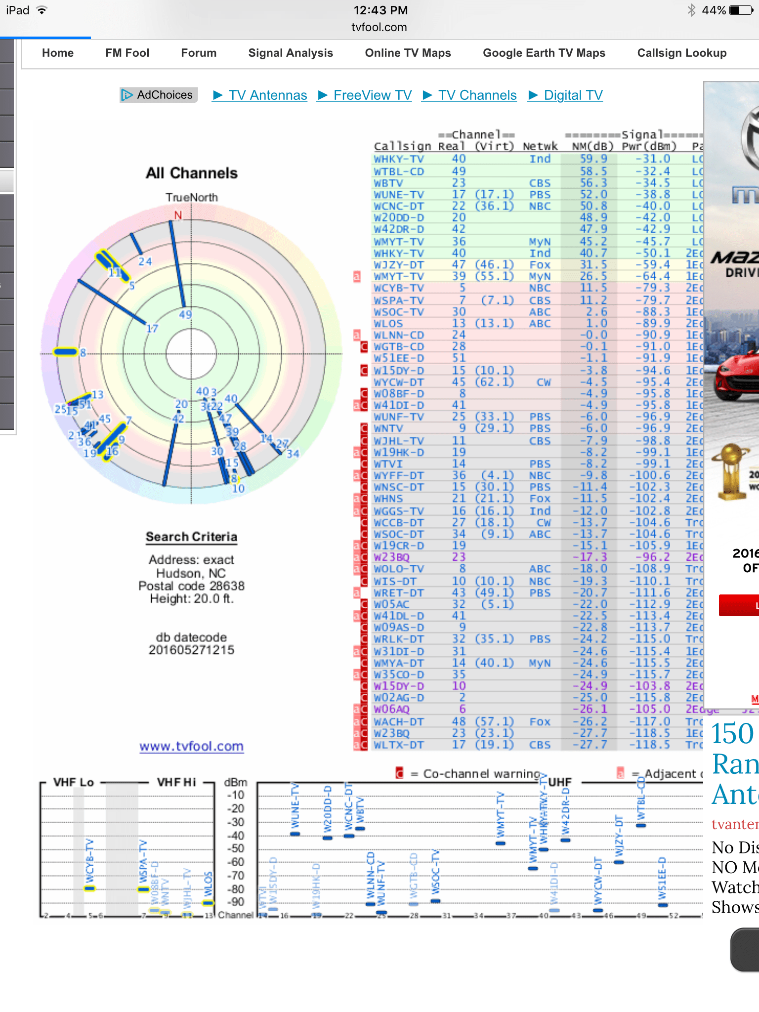

I am thinking of ditching Dish and am not quite sure which antenna I should try. It will go on the roof about 20 feet off the ground. Here is my tvfool report.
I hope the pic works. The ad on the right is blocking it a bit. The furthest station among the green and yellow channels is no more than 40 miles away. I am mainly looking for the main networks. Any advice is greatly appreciated.
Thanks!
-Jason
ABC is the tricky one. Not sure what is carried on the low power translator channels in the green. Is one of them an ABC feed? If so, you could probably get away with a modest suburban antenna in an attic and pointed SE. If not, you will need some height and a fringe antenna.
I don’t think you need any VHF capacity.
I think it is an exceedingly poor idea to advocate any UHF-only antenna solutions at this point in time. We're staring down the barrel of the repack and the likely simulcast of ATSC 3.0 (or some other virtually incompatible standard) before that happens. I this particular case all but at most three of the OP's "easy" channels will be moving down in frequency and the co-channel warnings make the table look like someone spilled the red ink.
As the OP intends to commit to cutting the cord, I submit that they need to plan ahead further than four or five years when things will surely start heating up.

Two Thirds of those channels are in the red, and coming from various directions. Are you expecting only the green channels or the red ones as well. For the red you should have an antenna outside, above the roof. Inside an attic will cut your signal. But first, what channels do you want to receive?
Just looking for the green ones. The main networks - CBS ABC NBC FOX and CW. I get all of those with the Mohu, but the signal strength is on the low side. Signal quality is showing as 100% for those.
