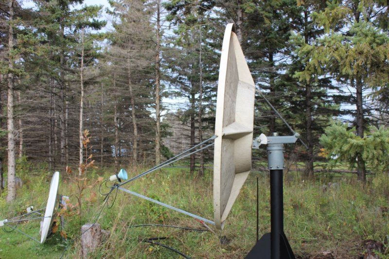

My mini-bud is an 8-footer... even that's too small much of the interesting "stuff". It might be big enough to pick up one or two of the channels mentioned in the opening post, but not with a lot of headroom signal-wise. Pic below is my mini-bud. To the lower left you can see the 1.2m channel master Ku dish for 103w.
