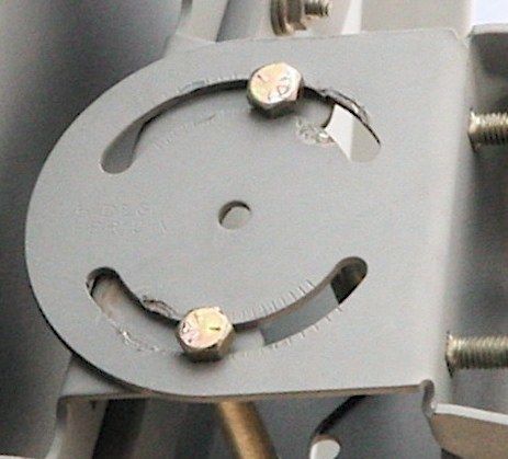

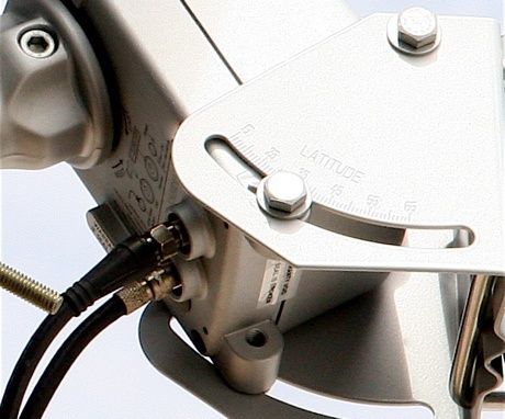

Another new SG2100 installation
Ok, so I finally acquired a SG2100 motor and a used 1m Winegard offset dish for my micro BUD adventure. According to the printed manual that came with the SG2100, the motor should be set to my latitude (27º N / 63º elevation), and the dish to 30º minus declination angle, which is listed as 4.526º. This translates to 25.5º (dish angle). By the way, the downloadable manual states 40º minus declination angle (instead of 30º), so I also have doubts as to which is correct.
Now, setting the motor latitude angle was no problem, due to easy to read marks on the mount as shown in the first picture. But what about the dish? It only has set of marks with a faint legend that reads: "5 DEG PER DIV". Now, looking at the second picture, could any of you give me an idea on how to correctly set up the 25.5º dish angle? The current angle dish is just a random position.
Thanks.

Looks like you have to judge it by the middle of the bolt head and let the signal quality meter be your guide!
Use the 30 degree setting -- newer units use 40 degrees - meaning that yours has been sitting around for a year or so. (Probably!!)
Personally, I would try my best to get the dish parallel to the axis of the motor arm and then use an edge of the bracket as a reference to move the required distance. Looks like a tough mount to adjust :-(
PSB, I think I am the psychic now... somehow I knew the only way to aim this dish would be by trial and error with a sat finder or the receiver's signal meter. :(
Craig, thanks for the clarification regarding the 30º/40º degrees issue.
Now, one final question before I get back on the roof. I want to be sure I understand this correctly. I will try to get the dish parallel to the axis of the motor arm and then try to adjust it 25.5º higher, right? Sorry if this is too obvious for most of you, first timer here. :hatsoff:

NO! -- You are setting a "Look Down" angle because you are not at the equator. Please check the manual again as the 25.5 doesn't sound right at all -- and I don't have my manual here to help. Here in Albany at about 43 degrees North the lookdown is ( if my failing mind is still working) 8-10 degrees (maybe) -- and that is down -- ie. lower. Yours should be less, but is DOWN - not up.
Sorry I can't be more help.

Do what L Alex says -- I seem to be getting confused as it is clear that my dish is RAISED from parallel with the axis of hte mount, just as he says! (sigh)
