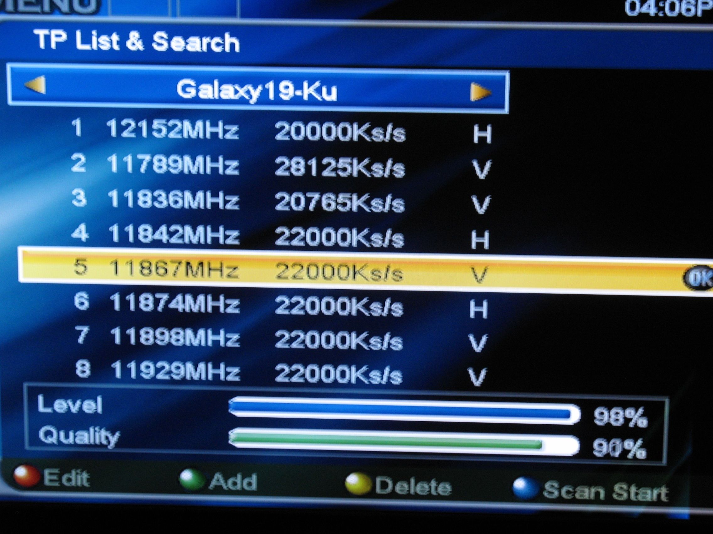

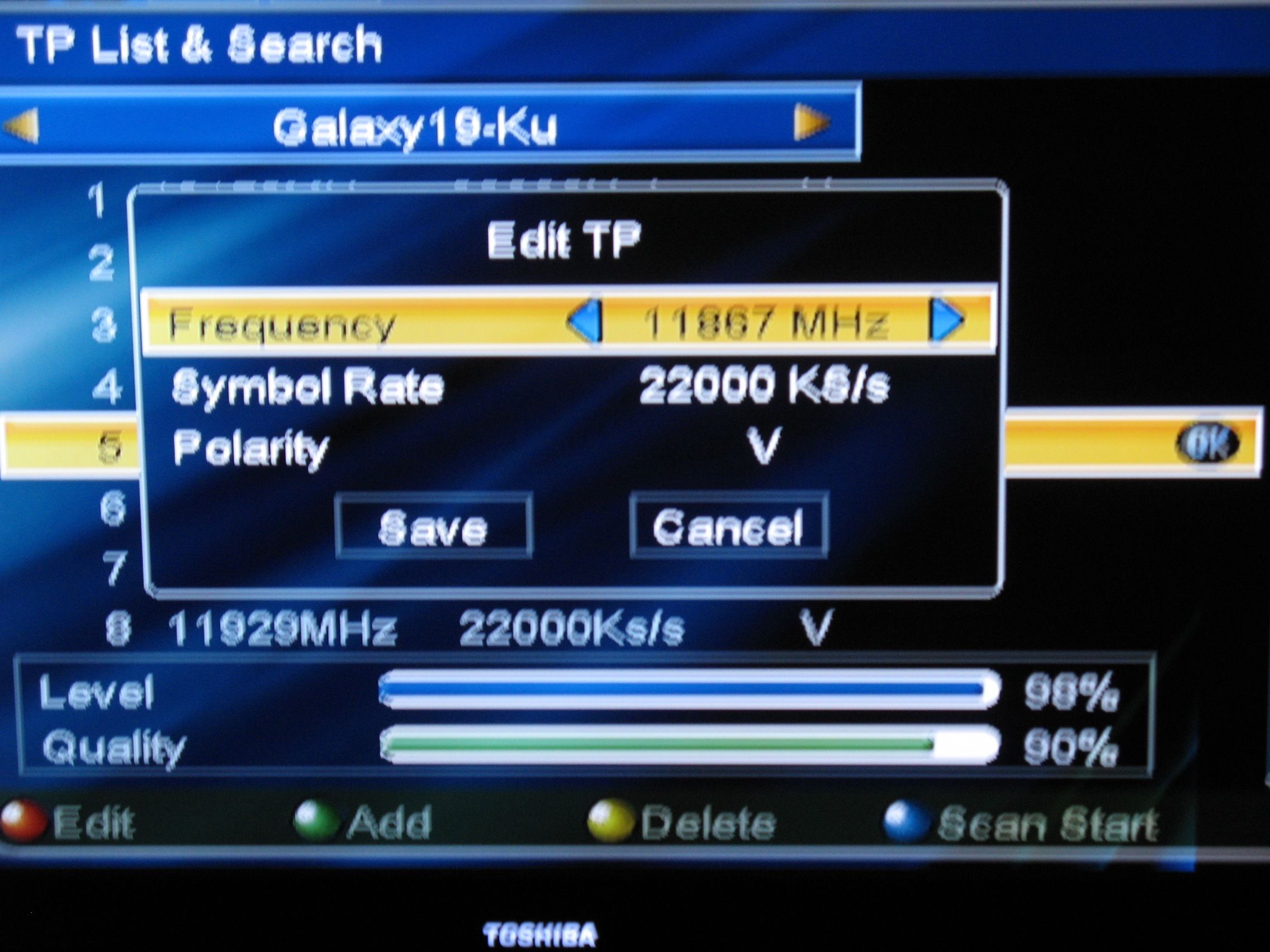

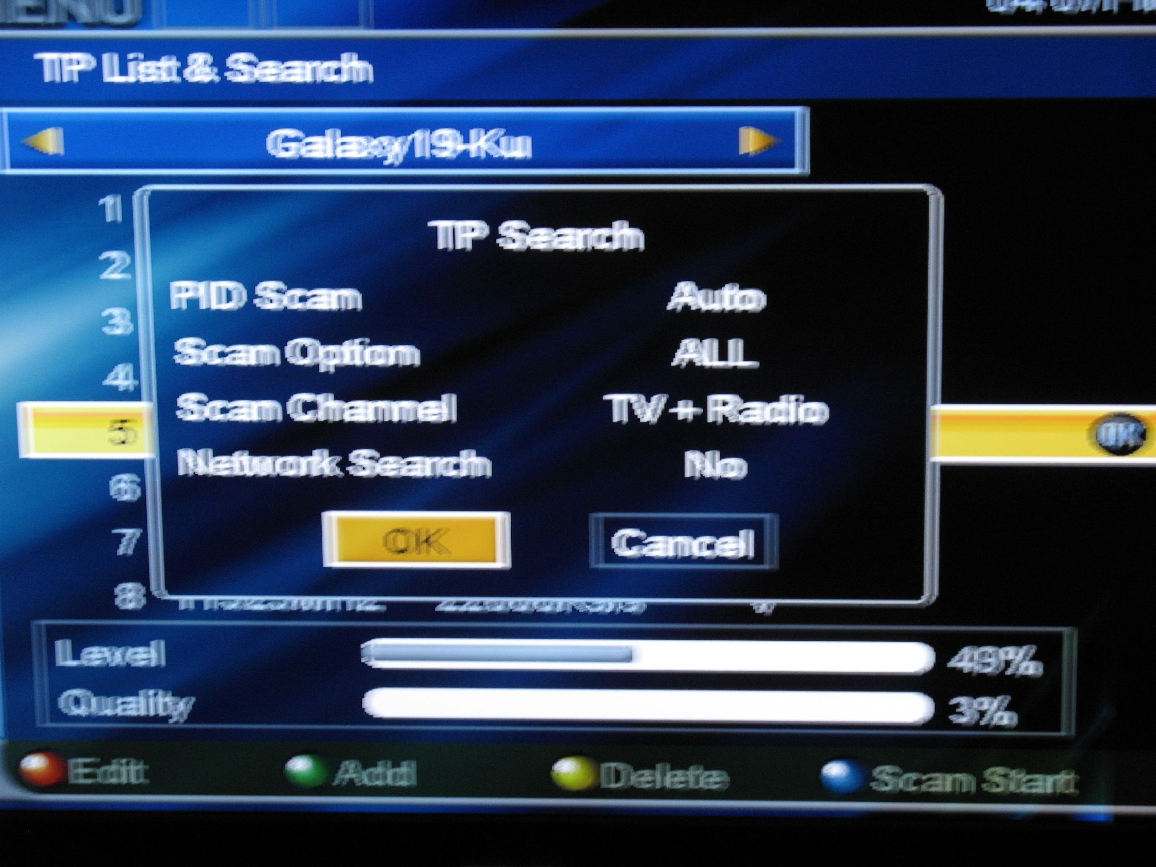

I have one and have to disagree. It does have manual pid entry. Go to TP search, then highlight pid
scan and use arrow keys to change to manual scan.
Found it. Few more steps though.
Menu>Installation>TP List & Search>Highlight the desired TP>Press Blue Scan Start>Go up to PID scan>L or R to Manual>highlight the PID entry to change & enter value>down to OK>Press OK
