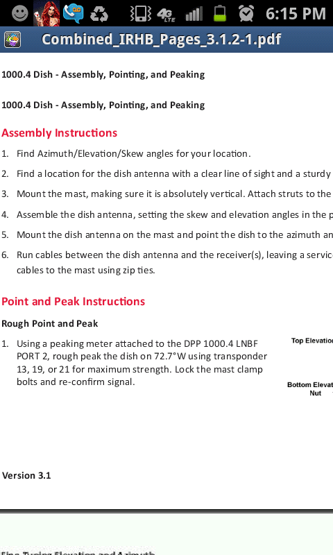

The only instruction I found was for the 1000.4 eastern arc and that said to connect the meter to the 2nd port and rough.point it to the 72.7 on page 7 of the installation reference handbook. But nothing for the 1000.2
