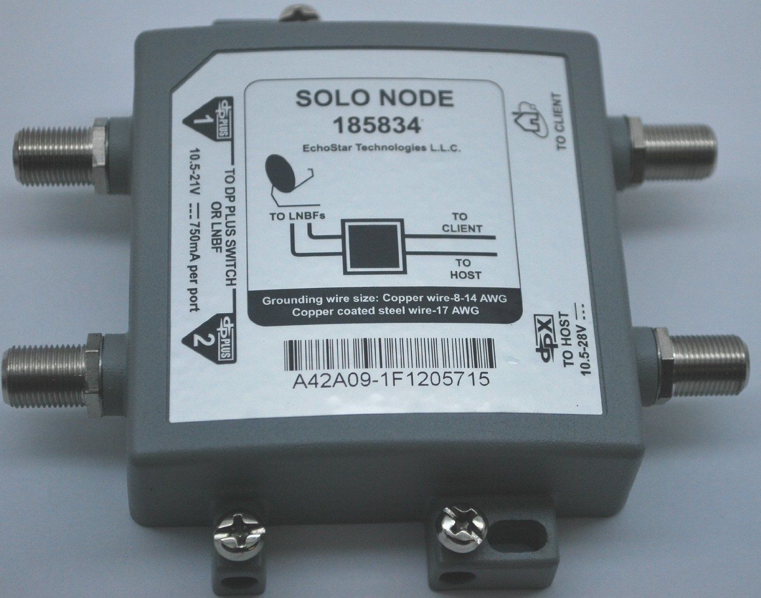

Yes, thanks... I got the Node. The node is standard right? (same for Eastern and Western?)

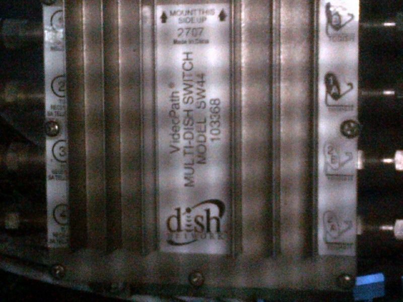

I also have this SW44 switch + the Power inserter currently connected... what is that for? Will I need that or shall I just discard those?

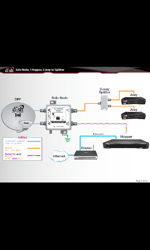

SW44 won't work with Hopper. You won't need a switch anyway as the 1000.x LNBFs have built-in switches. All nodes work on both arcs. What matters is how many Hoppers you want. If you only want one, then you will need a Solo Node. If you want two, then you will need a Duo Node.

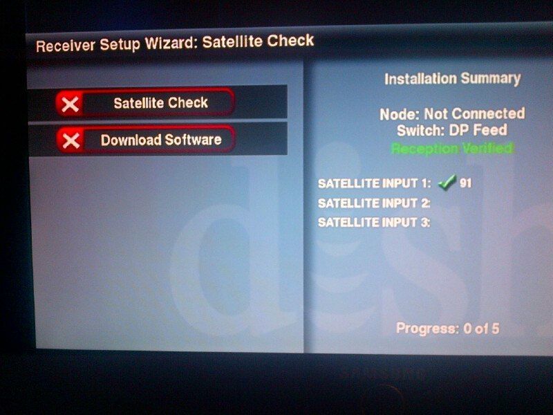

Hi Guys, additional question... I already got all the elements requires (I believe). Hopper, Joey, Node and order my Dish1000.2 antenna, which I am waiting to arrive to be installed...
The issue I have so far is this... while I wait for the new satellite to arrive I have a Dish500 antenna connected... but the only thing I get so far is some music, and a menu showing the promo channels (no actual channels... just the promo). Also I got a message saying Node: Not connected
I wasn't expecting to get signal until the new antenna arrives but...the node not connected message looks weird? Is that correct? Perhaps old satellites like Dish 500 do not recognize nodes... not sure what to think now... thanks.
(Basically I connected the Satellite to the node and the node to the hopper)
Looks like the old dish has DP equipment. The nodes are only compatible with DPP equipment.
Also... I'm sure you already know this but... 91 is not a Dish satellite.

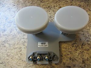

Hi Guys, so I got my 1000.2 EA Satellite ... now have a question...
I connected both of them and received the Node not detected message... perhaps I am doing the connection wrong (or node is damaged)...
Just to confirm... which one of the outputs from the LBNF go to the HOST on the solo node? I assumed like in the western arc is theoutput to the far right...but still get the node not detected... the eastern arc lbnf does not show clearly which one is the output to go to the Host....
Any direction will be appreciated... thanks
