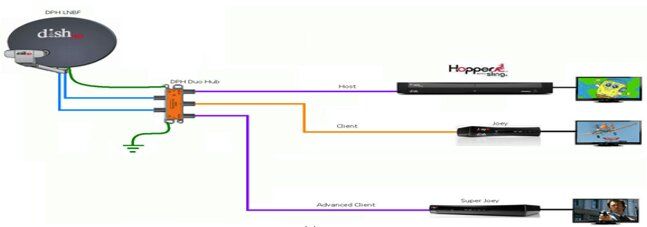

Do you have any pictures or screen shots of documentation, either written or wiring diagrams?
Hubs and hybrid tap

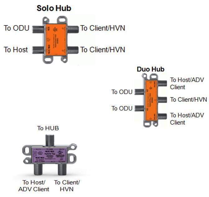

Hubs and hybrid tap

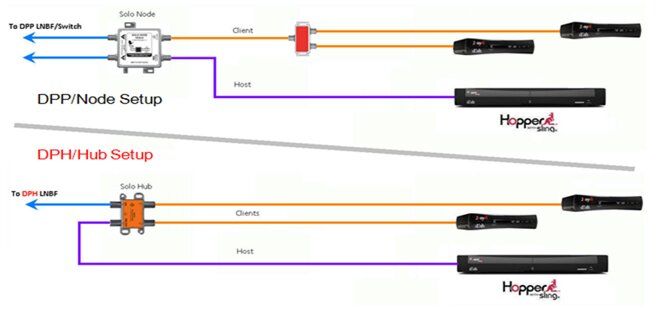

Awesome, thanks. This makes so much more sense, and is what I was expecting. They've put all of the logic and stacking circuitry into the LNB itself, and the hubs are simply taps with multiple ports on the client side. And the duo hub internally is likely just two taps, with the client side bridged between the two.
I've only been on a Hopper setup as a new Dish sub for about a month, but I already want to add a Super Joey, and this is perfect and will allow me to add it without having to do any re-wiring at all. Just swap the LNB, and put one of these hubs in place of my current solo node.

Why would you need to hook up the hybrid solo node directly to the hybrid duo node if both are hooked up to the hybrid LNB itself? That seems redundant.
It appears that the MoCA signal doesn't go all the way to the LNBF. The Hubs likely block the MoCA from going back up the "To ODU" port(s). Using the hubs bridges the MoCA frequencies on the client/host sides of the hub.
I'd be interested in learning if the official documentation says to use a hub even if the only set top box being installed is one single hopper, no joeys.
