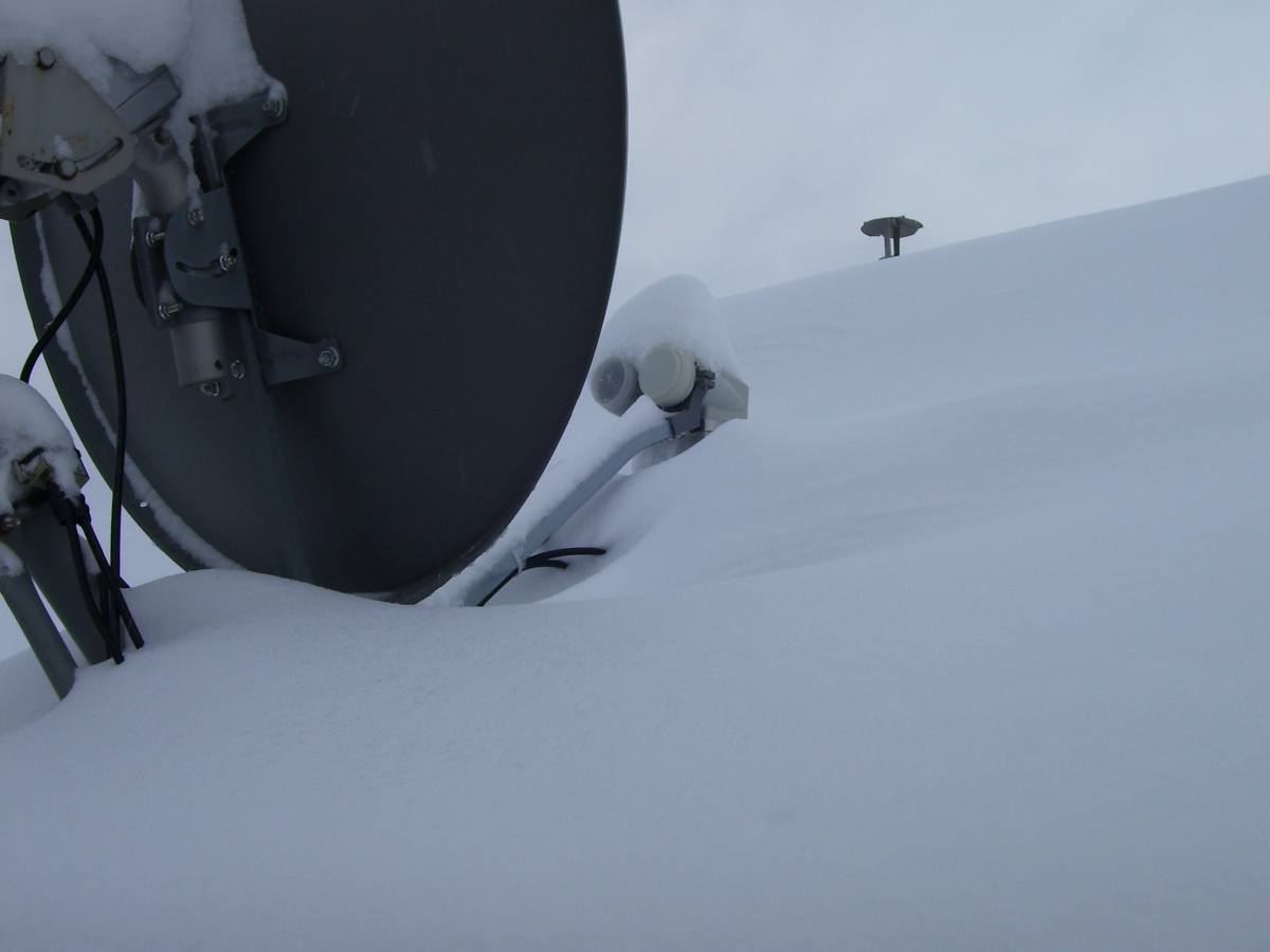

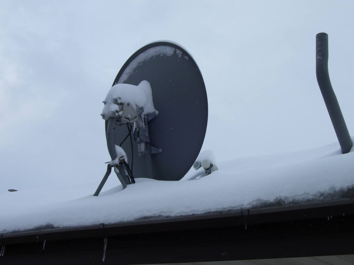

On another track, do I need to keep the dish clear of snow for reception? We can get some heavy snows in the area. Just currious.
yes. snow kills reception especially heavy wet snow. Make sure you have access to the dish to clear it off...dont want something like this to happen (this is from 3 years ago)

So, I guess I won't be watching fta tv while I'm snuggled up by my wood stove, eh? BTW, that's a nice looking dish farm you got there FA. Thanks again.
Yea, I can see that snow could certainly dampen your fta tv viewing. I think my dish location will be manageable. Thanks for the feedback Iceberg.
