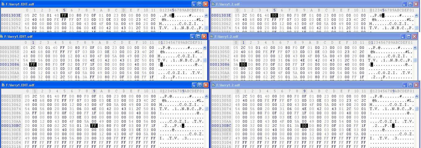

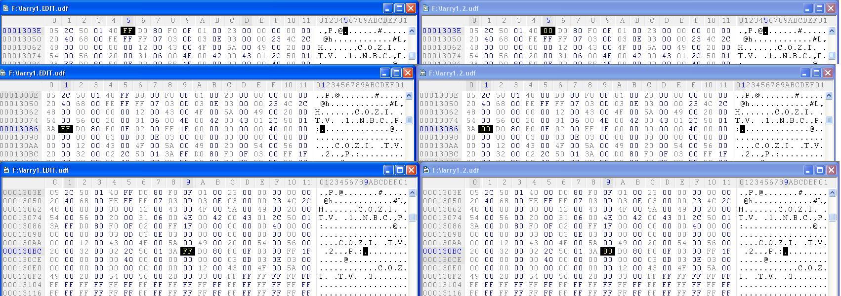

Your newly uploaded file works fine. I have edited the previously uploaded file and tried changing the video to MPEG and I get a file that is the same except for 3 bytes difference. When loaded back into ALiEditor it appears fine, but does not work in the microHD. Your newly uploaded file works fine in the microHD.
A hex edit of the two files reveals the differences.
So now for me to find out why the editing on my computer is producing a file with different output.

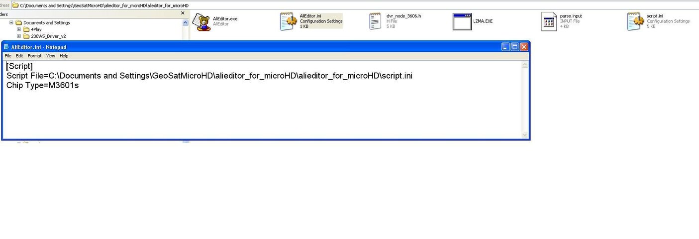

Larry, is your editor set to match the exact processor chip used in the MicroHD receiver? I haven't used an editor yet, but I remember reading a bunch of posts saying to set that properly before working on a file
I am using the one from the download link in the thread FAQ: microHD Channel Editing Software . I have now tried the one from the link to purchase the cable in the thread First Aid: Serial Update via Internal TTL Header and it works. (the file link is directly above the video on how to use the cable) The ALiEditor.exe files are the same size, the info lists the same version but do not compare the same.
(I did add the LZMA file from the link to buy the cable for I would not always have to click ok to bybass the missing file screen.)
Yes, my ini file has been edited to match the processor and file path.
If I copy over the ALiEditor.EXE file from the link to buy the cable (and only the ALiEditor.EXE file) it works fine.
