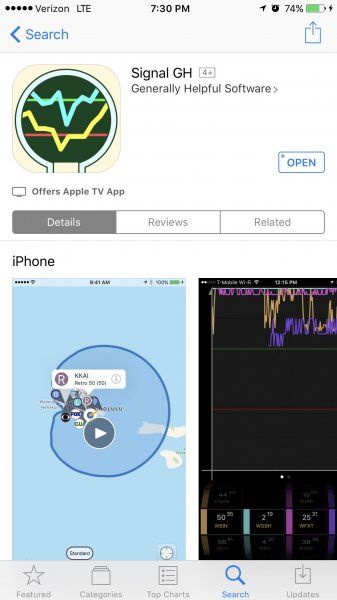

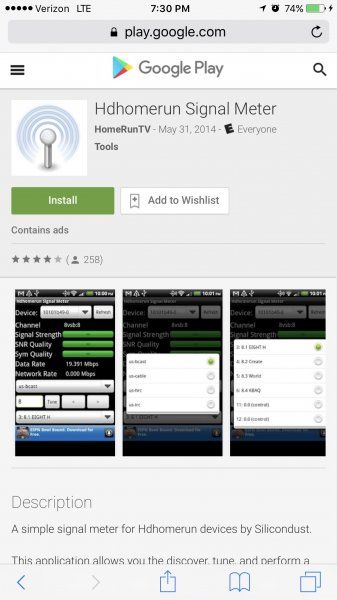

I have one and use Plex to record/view tv with it. It's a great little tuner and cheaper than a Tablo! I tried to find the app you're referencing to help aim the antenna. Do you happen to have a link? The only one I found was one called "channels" that was 20 bucks in the App Store. I'm not sure if that's the one that you were talking about.
It's called "Signal GH" for Iphone and Ipad. The one for Android is called "Hdhomerun Signal Meter."
