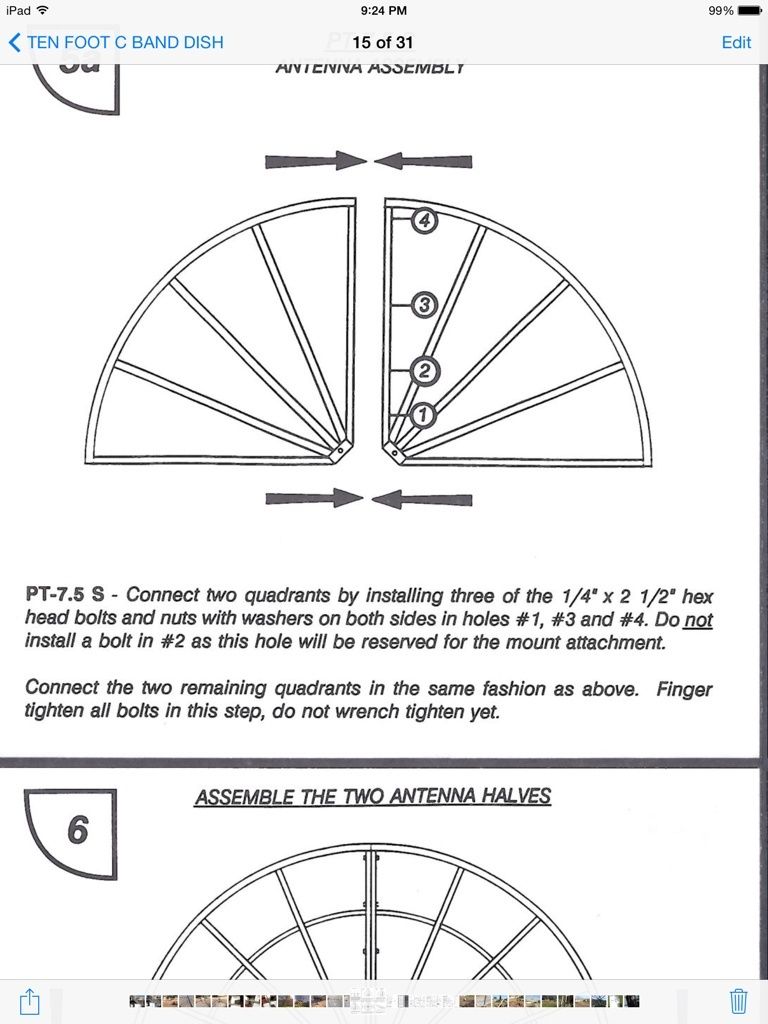

I have a Perfect 10, and didn't have any issues with installing the arm. It's not that close to the mesh. I uploaded the full assembly manual for all versions of this dish, and it's 11x17 size pages. Follow those directions TO THE LETTER (NO "doing it your way" with these, it won't work, I found that out myself, lol), and you won't have any problems.

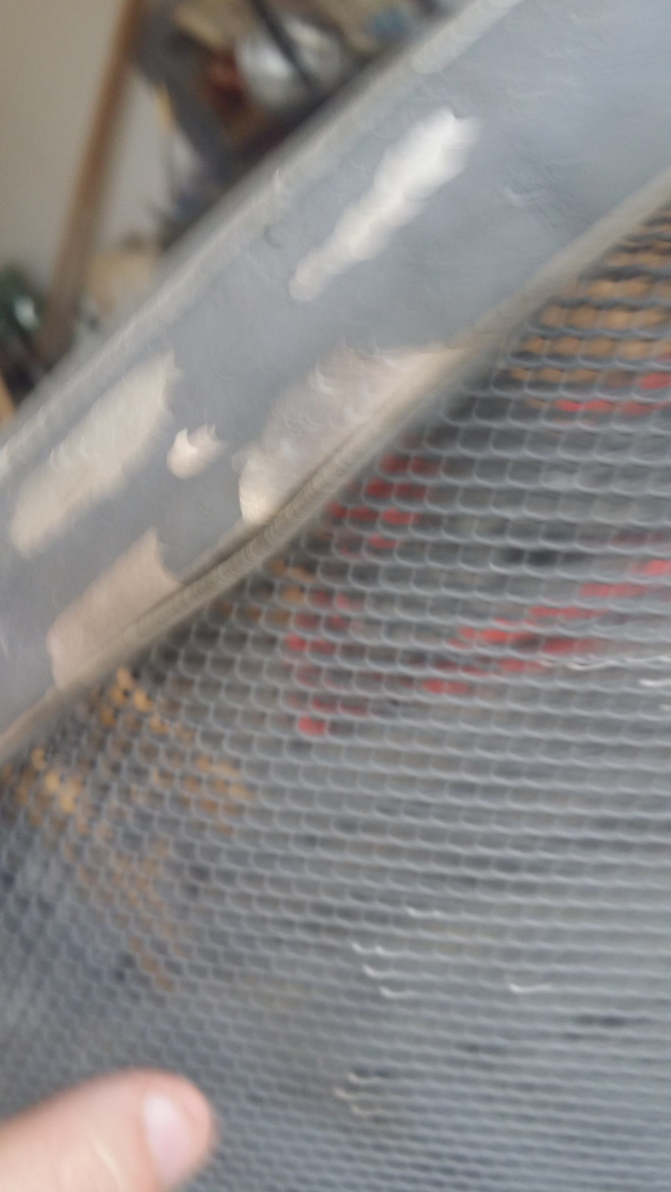

just brought the mesh panels home and noticed the outer frame has a bulge and coming apart a little on one of the panels will that hurt the integrity of the dish ? pictures to follow
Yes. BUT, ... It would be wise to do an extensive string test on the dish before going too far.

this is a picture showing the damage i was asking about i will assemble the panels in my spare time and do a string test before going further

I would just see what you can get I think its more fun that way. Not saying anything bad about a string test but I would much rather be blinding scan then playing with string :)
Looks like water got in and froze,you might want to drill some weep holes so it doesn't occur again.The split can probably be welded up to restore strength,but overall it's most likely not that big a deal.
That's what I thought to as we have had some weird winter weather this year as you know
Mine has the same type of 'injury'. As long as the parabolic shape hasn't been altered it will not affect performance.
Does anybody know the length of the bolts need to assemble a perfect 10 dish all the instruction say are the quality
Download the manual. Print it. Then review it. Looks like the bolts to hold the four sections together are all the same.
