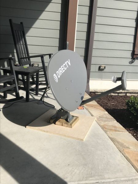

Thanks everyone for chiming in!! Another lesson learned: I will not spend HOURS trouble shooting the inability to get a signal again. Just call DirectV! I think I have the dish alignment down just fine.
I'm glad you got it fixed. I'm guessing it was the elevation that you couldn't adjust that was the culprit. It's hard to believe someone would tighten them so much that they couldn't be loosened.
Reactions: SoNCSU95
So again, a Directv technician came out, looked at my setup and said "oh you've got it set up correctly"... but he could not lock into a signal, either. Could not find any explanation for its. Did feel the tightly locked-in elevation was a couple degrees off but he couldn't loosen those dang bolts either! Ended up rebuilding a dish set up, used the same LNB and all was golden! Not sure what is going on, but after having the previous dish damaged (slight dent in the rim) I was extra careful with this last one.
DirectV guy's wife is an NC State fan so I've invited them to our next big tailgate against Clemson. We'll be covered with text support, LOL! Dude also hooked me up with a stubby mount which is interchangeable with the hook mount I had purchased, and he finished my drilling and mount set up! I hate the tripod!
I'm going to move it all around my yard and driveway to test getting the signal multiple times.
Learned something new: low signals (we tested at 54% on the 101) will get you SD channels, as long as setting is such that SD channels aren't hidden.
And the weather is good with no obstructions.
It sounds like your issue you had figured out right away, but couldn't resolve with the overly tightened connection on the dish.
Changed to a new dish and your golden, had you been able to change your setting on the one you had, you would have been good as well !

I asked the Tech about the smaller round dish, more so for ease of moving it around. He implied they weren't even available anymore. I see old ones out there on older homes. He says a lot of people don't care to update. I didn't know they'd be easier for finding a signal.
Is that why the king quest can only get SD directv? I assume it's a small dish inside that thing???
A 101/110/119 "oval" dish is a better choice. It's not "official" but is 10000000x easier to aim than a slimline, and "good enough" for tailgating.
