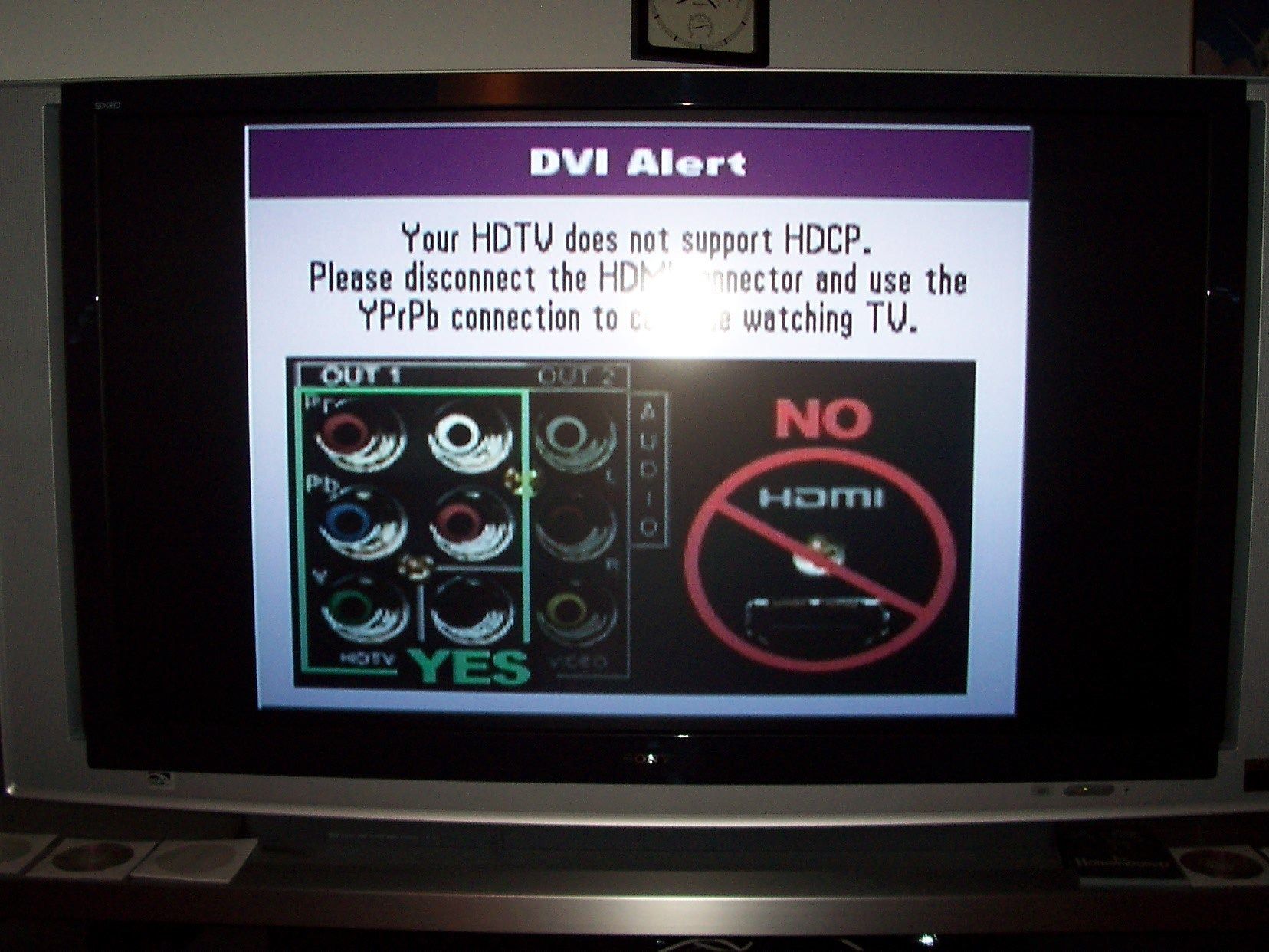

Hi, I'm not sure if this is the right place to post this, but I have a recording problem with either HBO, C-cast, both of them, or is this a joke??
I bought a Sony HD TV 6 weeks ago. I have HBO and an SA-8300 HD DVR from C-cast. Sometimes I'm too tired to watch shows so I record the movie or show from HBO on Demand onto a Sony RDR-GX7 recorder. I have 2 of them and NEITHER have inputs for componant cords. I have componant cords in the OUTPUT jacks to the TV on one of them. The other is the standard hook up- yellow RCA for video & red & white for sound. Neither recorder has an input for a HDMI connector. I tried playing the recorded film in both recorders and 2 Sony play back decks and got the same strange message. I'm also unable to set up a recording with the SA-8300/DVR from any On Demand ch. I also tried pressing the record button on the DVR when starting an On Demand film and it doesn't work. I could swear that a few weeks ago I could do that.
The on screen message reads: "Your HDTV does not support HDCP. Please disconnect the HDMI connector and use the YPrPb connection to continue watching TV". What the heck is this? I never heard of HDCP until I saw this message. The film plays with sound, but the picture is blocked with this idiotic message. Can someone who knows what this is and how to make recordings play properly please give me a hand??
I do have players that are hooked up exactly how this message states and they don't lose the message. I am sending a picture of this message. All help is appreciated.:confused:

Your Sony RDR-GX7 recorder has component out (YPbPr)
http://www.laaudiofile.com/images/rdrgx7b.jpg
Your SA-8300 HD has DVI out (electrically the same as HDMI, sans sound).
Can use an DVI-HDMI cable.
HDCP is High-bandwidth Digital Content Protection
High-bandwidth Digital Content Protection - Wikipedia, the free encyclopedia
What is the model of the TV set you bought? Is it a CRT?
I have not seen a TV in few years that had not a component input.
If you TV set is CRT, it won't have neither HDMI nor DVI connectors and you would have to use component.
Component is not protected by HDCP and should work.
If your TV is digital (LCD/Plasma/LCoS, Sony doesn't do DLP), it must have DVI and/or HDMI.
If the TV is over 2 years old, it might not support HDCP.

I have a Sony KDS-R60XBR2 LCD TV. I have an HDMI cable going from the SA to the TV's input. Both DVD recorders are connected from the SA (B) outputs to their in's with yellow/red/white cords. One has componant cords going to the TV & the other has the yellow/red/white setup. The TV is brand new, and my SA has a DVR . The cable co. provides On Demand @ no charge with HBO & Starz. I do remember recording things from O.D. a while ago to the DVD recorders with no problems. This crazy message screen started popping up about 3 weeks ago. However, they are selective. Tonight I recorded some trailers from HBO O.D. and NO message showed up. I also notice that if I press the record button on the DVR while in O.D. it won't work. I called the cable co. and nobody knows anything about that message, but the last rep told me I can't record anything onto the SA's DVR from it.

As Diogen stated, you are probably restricted from copying this program...and if it can be seen on your tv, you "could" copy it.
Check out this link concerning HBO on demand.
HBO Online: Corporate Info : FAQ - HBO Application of CGMS-A Copyright Protection<br><br>

Thanks. This explains why I have the problem. Like I said many times: Big corporations are NEVER satisfied- they always want billions of $$$ more. GREED is a most undesirable & disgusting way to fleece honest hard working Joe's who only will use copies for their own personal use. HBO should be ashamed!:mad:
Yeah... DRM sucks...
But it doesn't look like it is going away any time soon...
I thought that even premium channels had the copy flag set to "copy once". Guess they switched to "copy never".

I unplugged the HDMI cable & plugged in componant cords. No more nasty little message, all is well.:) My recorders aren't HD anyway. It's in the TV & that expensive HDMI cable.

I'm from Canada too... My TV set is a CRT (tube) and it has a HDMI connector. I have the Rogers HDPVR SA-8300HD, it has a HDMI connector, not a DVI connector. If I try to record from the analog video out without the tv on, I get a similar message. If I push the ok key, the message goes away and all is fine. If the TV is on when the recording takes place, the video is fine. If the HDMI cable is not plugged in then the recording is fine. This is due to the HDMI handshaking proceedure between the cable box and the TV. When the cable box is turned on, it senses the TV connected to the HDMI port and wants to handshake. If the handshake fails, the video to the TV is blocked. Unfortunately, the error message is displayed on the analog outputs of the cable box as well. Sometimes if I power my cable box and TV on in the wrong sequence, I will not get any signal from the HDMI port. Turning off and on again or unplugging the HDMI cable and plugging it back in again gets the signal back. If you do no not use the HDMI port, then there is no digital connection, just analog connection and then there is no handshaking.
