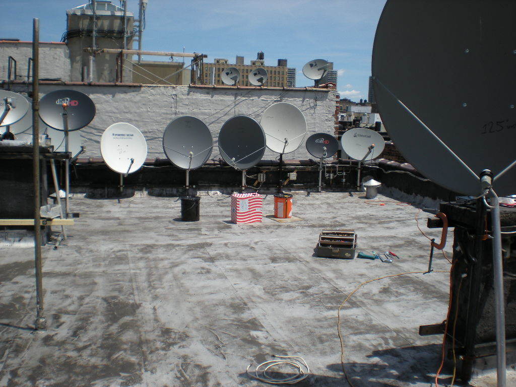

After reading about 103 West I decided to give it a try.Some time ago when playing with second LNB on 97W I saw a pretty good signal from 103W.
Idea was to get 97 and 101 from one dish but my original LNB for 97 is too big and dont leave me enough space to get 101.Space is only 4 degree.
Instead I got 103W.Its 6degree from prime LNB.Take a look on pic 1.DSCN2361.JPG

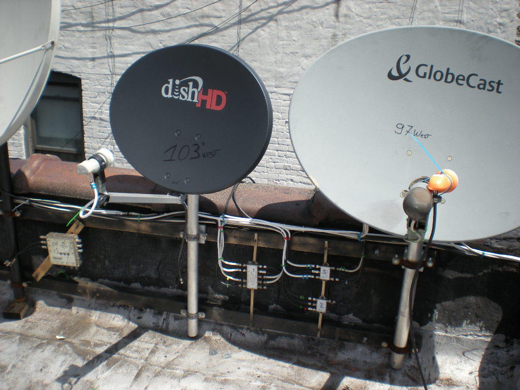

Then I set up a dedicated dish for 103 and will try to get to NBC signal that have that odd skew (20-25 off)

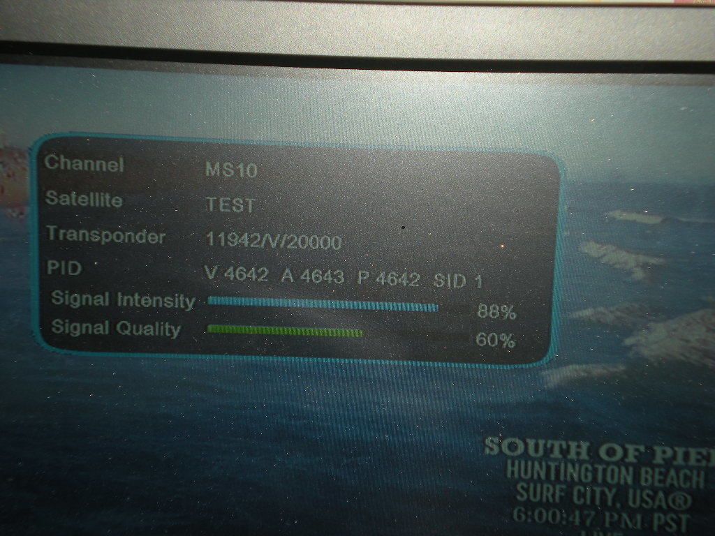

If you're only getting a quality reading of 60 on 103W, I don't know if adjusting the skew will get you the NBC HD channels. I suspect that your Dish dish might be too small. As for the dish that has 97W and 103W, I suspect that your second LNBF isn't aimed correctly. Before I got a motor, I could get the NBC HD channels on a 30" dish with a secondary LNBF, but it took a lot of time to get it right. Now, on my 36" motorized dish, I can usually get at least one of the NBC HD transponders without modifying the skew at all. Your location may have a weaker signal, but it should still be higher than 60 on the non-S2 transponders even without accounting for the weird skew.
Thanks Jim S for replaying.You may be right about size of my antennas.Don,t have more room for bigger size so my only choice was to use DBS dishes.Was thinking if I have watchable signal on Huntington Beach and Microspace Bar then obtaining NBC will be a piece of Cake.Not Really!! Was rotating my LNB like an Idiot for left and right and...Big NOTHING. Looks to me that one day I am going to make more room for FTA size dish.Anyway its a fun to use small antenna for our weak signals coming from Clarks Belt.Remember my first days when Could get NOTHING on 1 Meter dish even from 97W.Heaving experience only from DBS installations is not enough for our play.Today when do DBS don't need any meter at all.For FTA I am using ONLY $ 6.00 signal meter and by looking around on neighborhoods roofs I already know How to do it.When was young never believed my father that used to say practice make a champions....

If you want to try with your Globecast dish, you really ought to take a TV and receiver out to the dish. (A lot cheaper than buying a digital meter!) Even if you don't end up getting the S2 transponders, I would've expected a better signal on the other ones. For one thing, I think your LNB isn't even pointing toward the center of the dish. It looks like it's pointing far away from it. I'd expect it to at least be parallel to the main one for a decent signal at all, and pointed inward slightly for the optimum signal.
Thats OK.2nd LNB on 97W dish cannot be centered because Main LNB is.Of course I,ve got portable monitor but my question was:

Skew for 103 Ku is approximately 25 degrees clockwise, when looking at the face of the dish, from where dishpointer says it should be. 60 Q on the beach channel is what I would get with the skew set as dishpointer had. twist the lnbf CW and Q = 73.
And then I could get the NBC Tp. (But not dependably on the 30 inch)
To visualize; On a clock, each hour is 15 degrees. So the skew correction is almost 2 hrs.

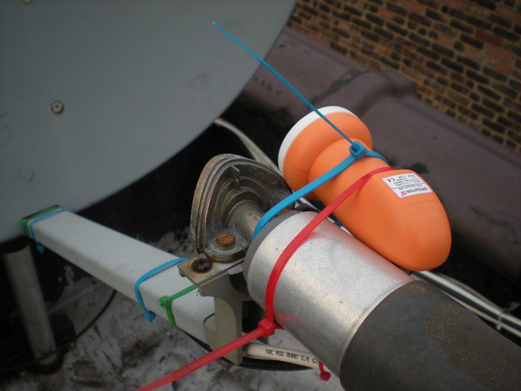

If the orange LNBF is on 103, twisting it CW 25 degrees looks impossible. But 180 - 25 looks do-able. (rotate it CCW ~155 degrees)(weather proof cable/F connections as the F connector will be about 2 o'clock)
May also improve if the offset LNBF were aimed closer to the center of the dish. (Spacer at rear of LNBF?)
The DishHD dish may be too small, for NBC, but improvement may be possible by adjusting it's LNBF skew CW.
