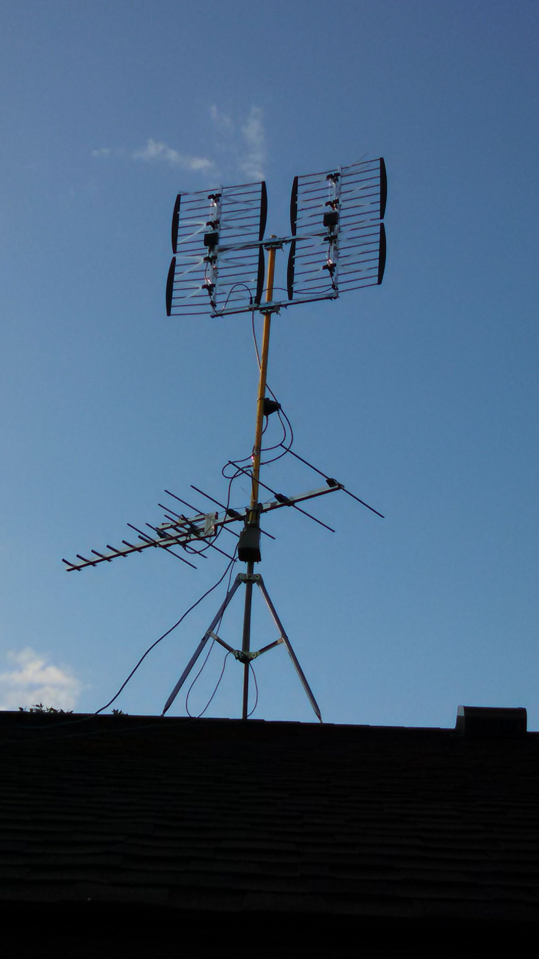

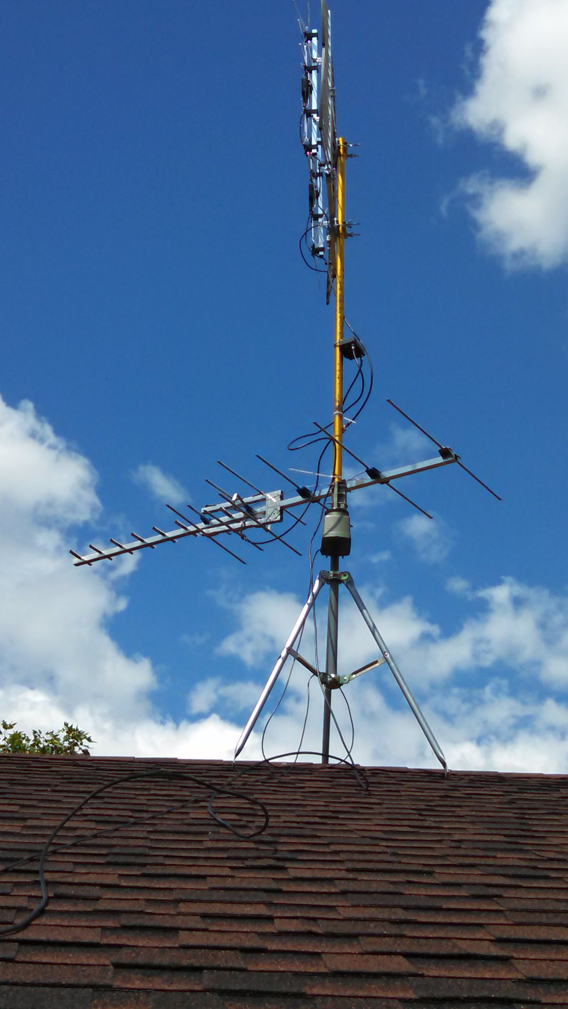

I have the shorter end facing east toward Delta Media and Baton Rouge stations. Most of the Baton Rouge amd Lafayette real channel are from 13 to 55. When i get the new one i will put the shorter end facing the 283° azimuth (KPLC) 10 shouldnt be a problem to pickup. The UHF will face definitely between 73° and 107° which would point in between the KXKW and KLAF points. All of Baton Rouge is in between those. We'll see come the first week of August
Well lets just say since i had an antenna whether it was Carencro or here i had trouble catching 9. 7 Comes in descent eventhough the boom end is facing east. If the 8 bay catches the ones i mostly get niw then kplc will come in alot better pointing the short end west.
sorry I have more pics but can't access them right now
couple more pics. If you blow them up you can see the coupler. Like I say this setup is just ghetto rigged right now

The vhf antenna, what is the distance it can get the locals. Looks like a nice lightweight one that you can easily put up. That jetliner I have i am afraid its too heavy and will eventually break off or something...

That antenna is actually a combo unit. Antennacraft HBU22. I had the UHF elements folded down as I was just using it for VHF. I have replaced that with a Y5 7-13 which is a VHF only antenna. Antennacraft made them but they were part of Radio Shack. So when Rat Shack went belly up Antennacraft did too. Only way to find them is ebay, craigslist or possibly a Radio Shack that is still open. The VHF only ones are gone. I saw a HBU22 at a franchise store a couple weeks ago
Specs say "up to 50 miles"...but your mileage may vary
Thanks I'll be looking into buying it later
Looking at the specs the weight is minimal between them. Your existing one says 6 pounds and the HBU22 is about 4 1/2 pounds.
The bigger the antenna....the more it will weigh ;)
As long as its secure properly you should be fine. If you can fold down the yagi (the "Y" portion of the antenna (like I had done in the HBU22) that would help.

Yagi must be what i call the wings. Yeah i can do that for now
I called Solid Signal and the lady said they were out of the combiner with the vhf and uhf on it. They been out for a month. The one they sent she said its just as good. Well I definitely take your word over her. After about 3 times of her saying the one they sent is just as good she finally took my email address to let me know when they get more. So I'll have to wait.
hmmmm odd
The SS site shows "Availability: Usually Ships Same Day" on the site.
Did you try to bypass the combiner to see if there is better reception?
you could even try a splitter in reverse to see if that works.
The combiner I posted is a unique one as it blocks specific frequencies. One drawback of a splitter in reverse is you can get some interference if the antennas arent aimed same direction. Thats why I use the UVSJ combiner (the one I've linked to). It forces one antenna to only get the VHF frequencies through and the other to get UHF through and has very low signal loss (.5 db) which helps when trying to get distant stations. Any splitter/combiner will have signal loss which the higher the number (a splitter is 3.5) the less chance to get a distant station.
hmmmm odd
Yes i did all that Yesterday in the 100 plus degree weather. When i put the line straight into the 8 bay i got most the same channels good. Oh the preamp will not ship till the 28th. I am waiting for the weather to cool off before i go back on it
oh yeah it has been rather warm down there (from what I have seen on the news)
Sounds like a winner
