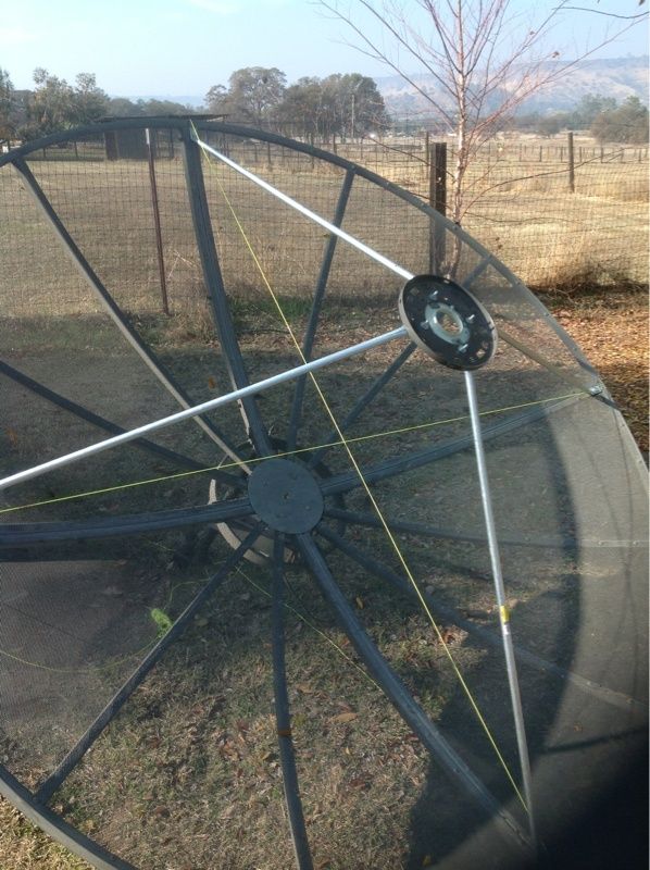

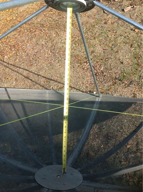

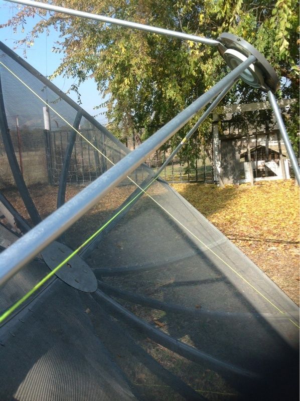

Okay, it passed the string test this pm. Taping two strings perpendicular to each other they touch and maybe 1/4" plus or minus, I couldn't tell as I used old duct tape and it kept coming loose.
New issue. I think this dish is different depth than my other one. I forget what the other one measures and I of course did not write anything down...
This dish measures 90" diameter outside edge to outside edge and 14 1/2" depth ( easy measurement with the string in place).
QUESTION:
Shouldn't I measure from the inside edge to inside edge? Which is the actual reflecting surface...?
Pictures attached
QUESTION:
Pictures attached
Another question: does the dish mesh reflect where it is on the 1" end edge also? Or just the mesh inside the outer frame? Stupid question?
Never mind it must reflect the whole 90" width as I have a solid metal dish with no dish that reflects quite well.
