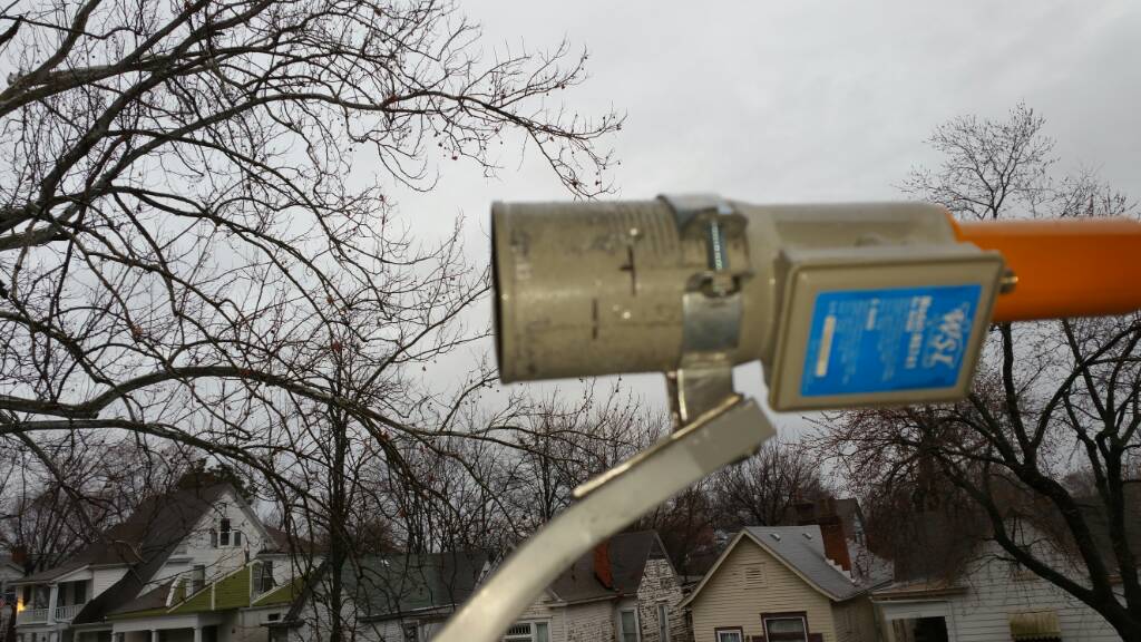

My new 76cm c band
Soo I get up and fixn to play...and notice no signal anywhere...not even ku..knowin my motor elevation is strippd i assume the motor dropd a hair..so i looses the bolts watch the meter in the tv and nothing..east and west nothn...hours later i find a bisket inside my lnb...yup a bisket...fit perfect...guess i should buy a cap

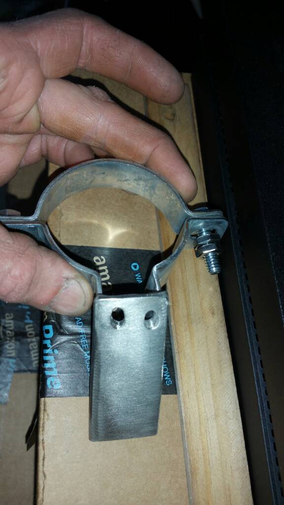

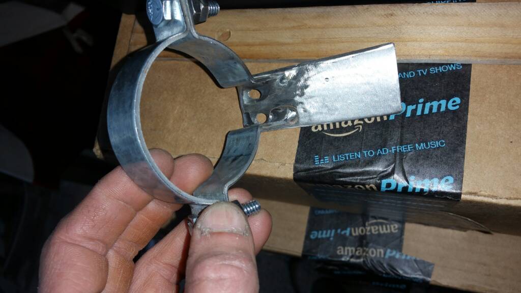

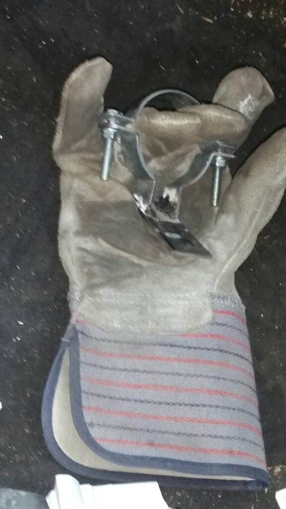

Makeing a new lnb holder tomorrow at work..measured everything..im pretty sure it will be just right...it will fit the lnb arm and bolt holes of my winegard 76cm and hold the lnb properly..no more wood blocks and hose clamps and angle washers...i like switching out and watching ku band also..itl be simple now..

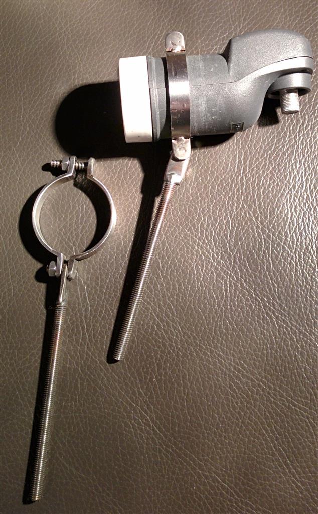

good job k.r. what kind of welding is that? TIG? How are you going to change direction of the LNB? And at which point on the surface of the dish your holder will be pointing LNB?

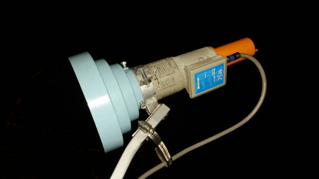

I have made couple of LNB holders out of 42mm INOX pipe. Such a construction allows to adjust LNB in any direction. IMG_20160310_192521 (Custom).jpg

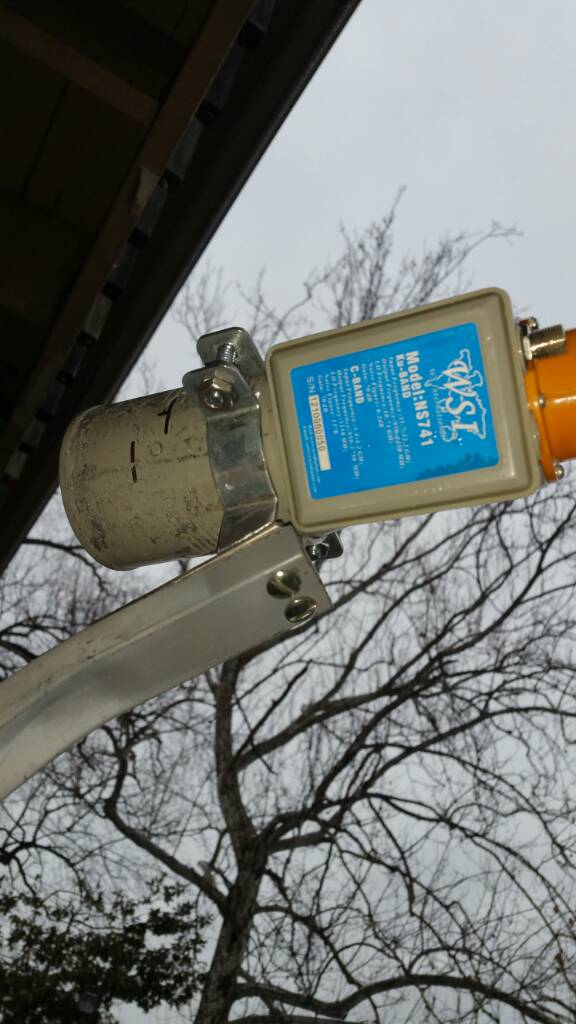

It will bolt right into the origional holes for the factory lnb holder...tig welded..and no adjusting..i tested and measured my best angles and built it to just hold it there..il send pics later tonite of finished and mounted...weather permiting

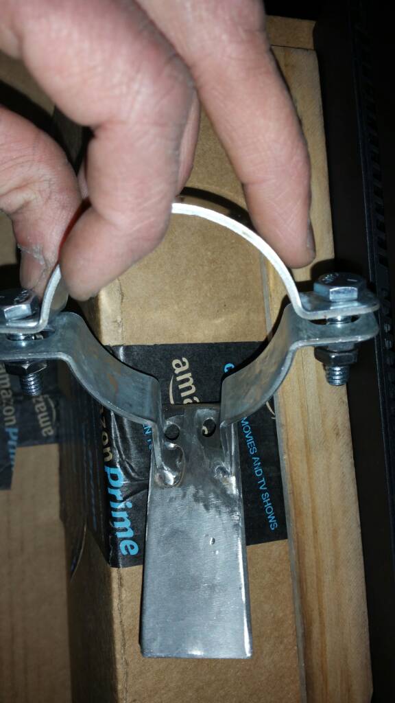

Almost coffee and surfing time...cant wait..hope these pics help someone wanting to play mini c band..

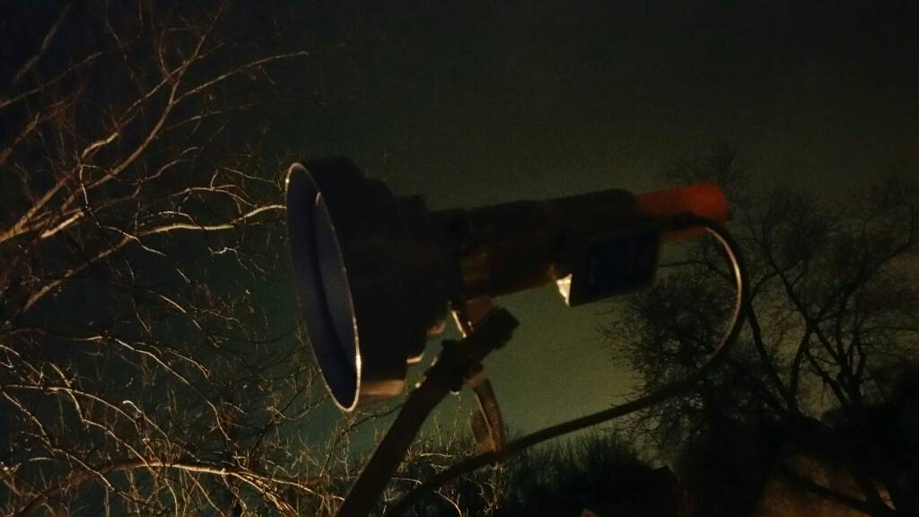

Found 91w...everything i had before...found 97w. Working on tweaking it..its raining..but im on the 2nd floor padio dry..just hurting the signal..I did away with my motor..It was getn sloppy..I think i did a pretty good job on this holder
