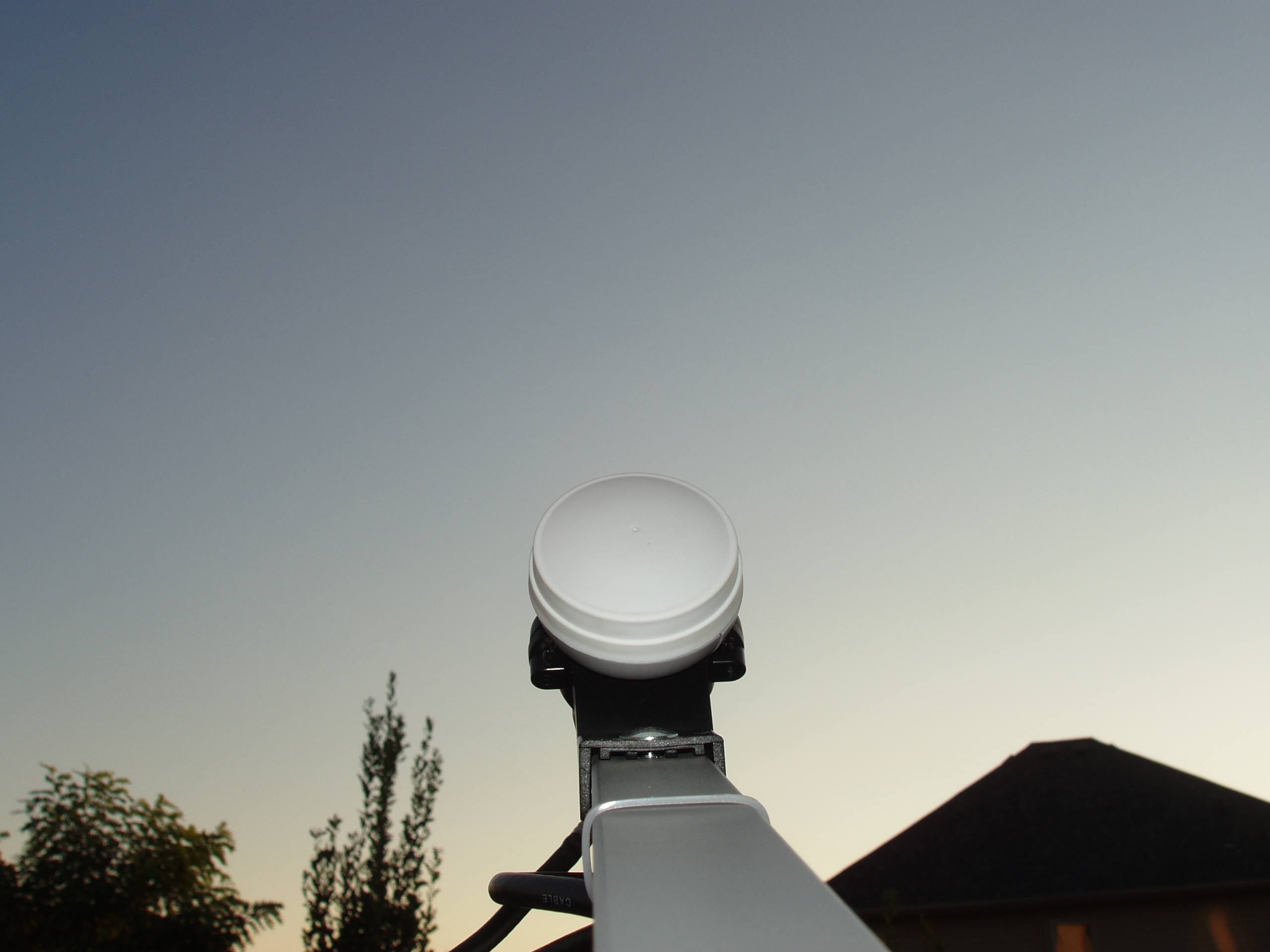

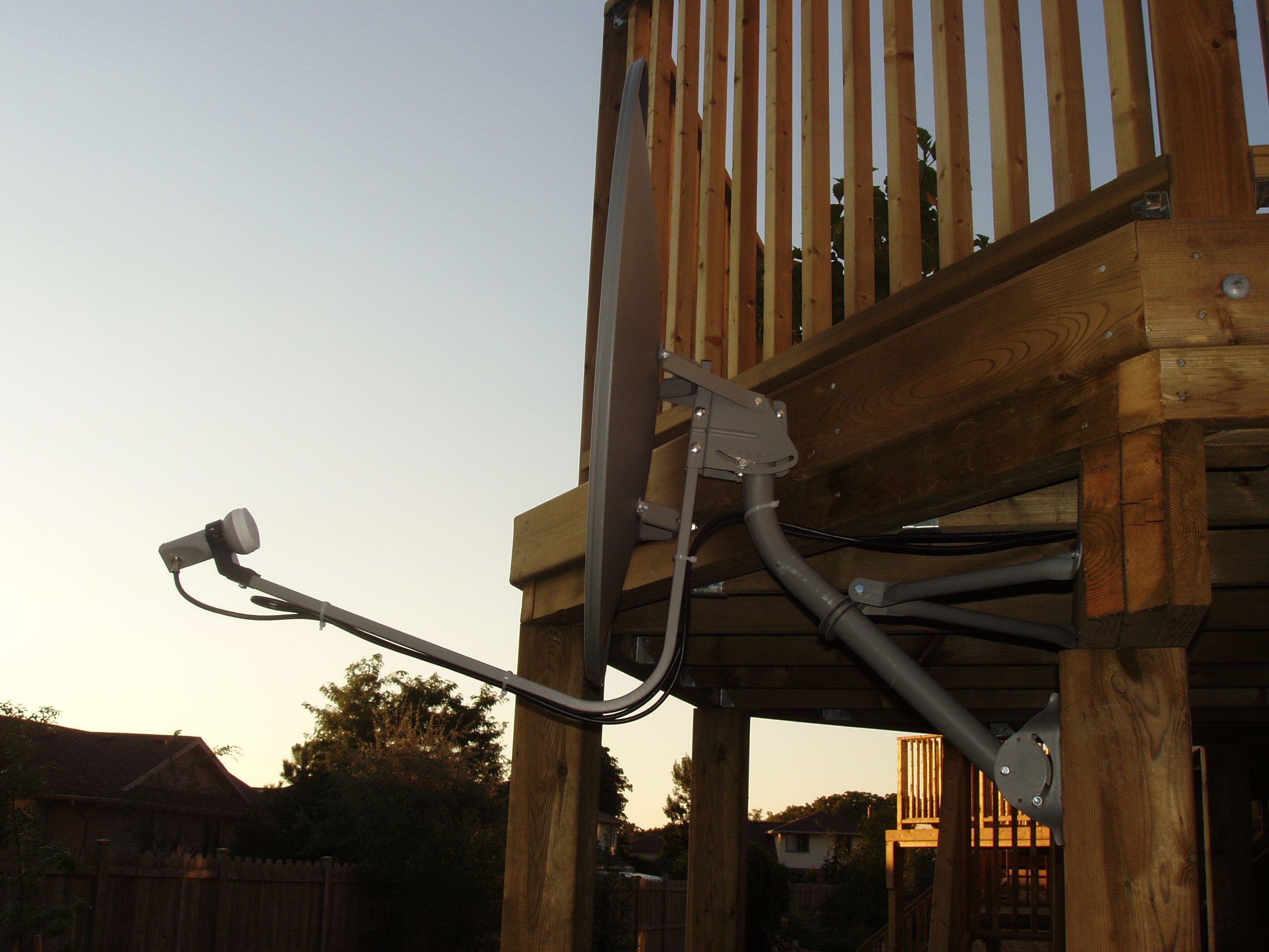

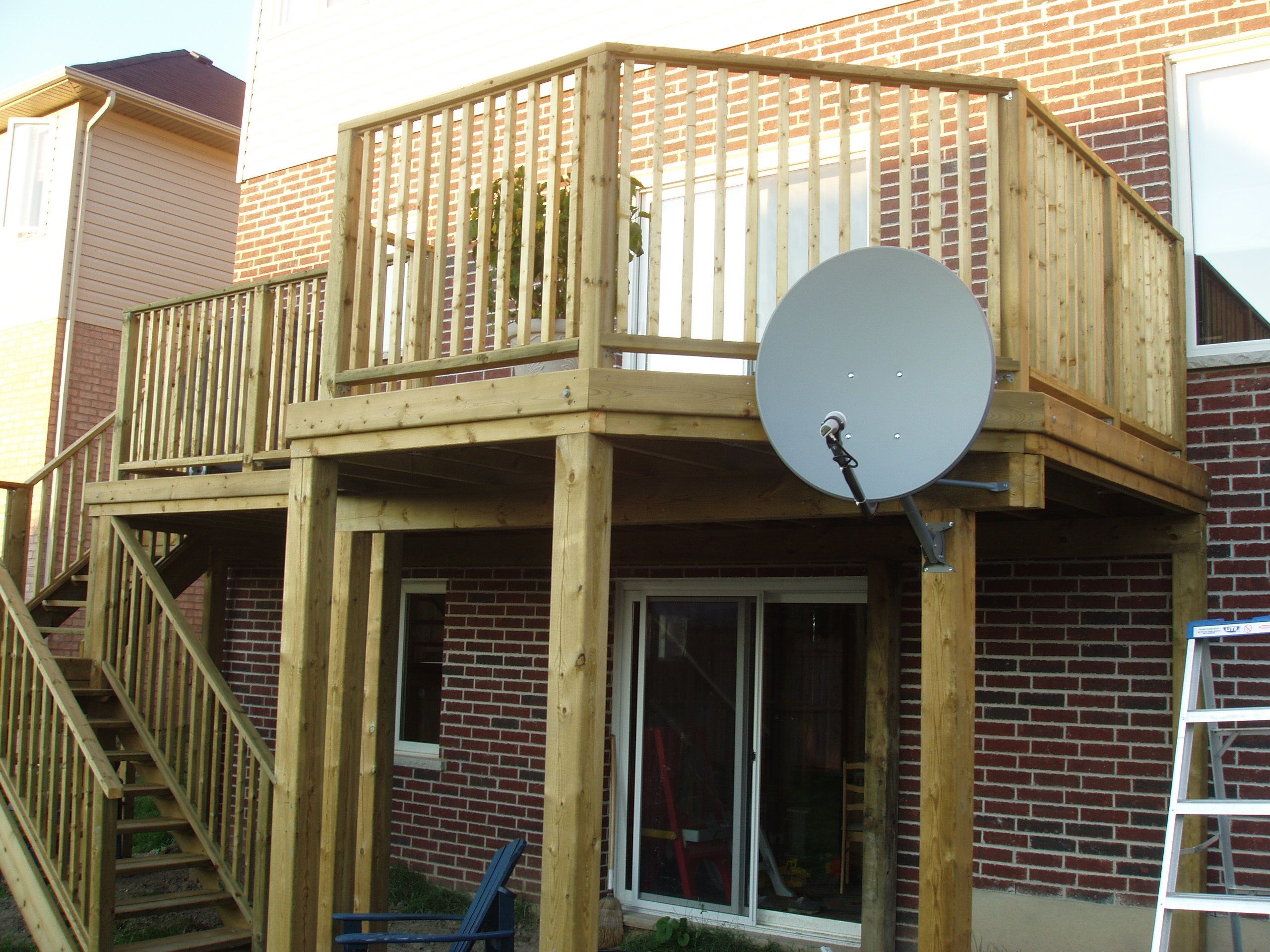

I've included some pics of my setup. I hope they help others get into the hobby. One thing to note is the elevation of my dish. The calcs on the net all said I should set it to about 25. But you will notice its set around 35...which is a pretty big difference. Maybe that has something to do with how far above sea level you are...I dunno. Just something to keep in mind.

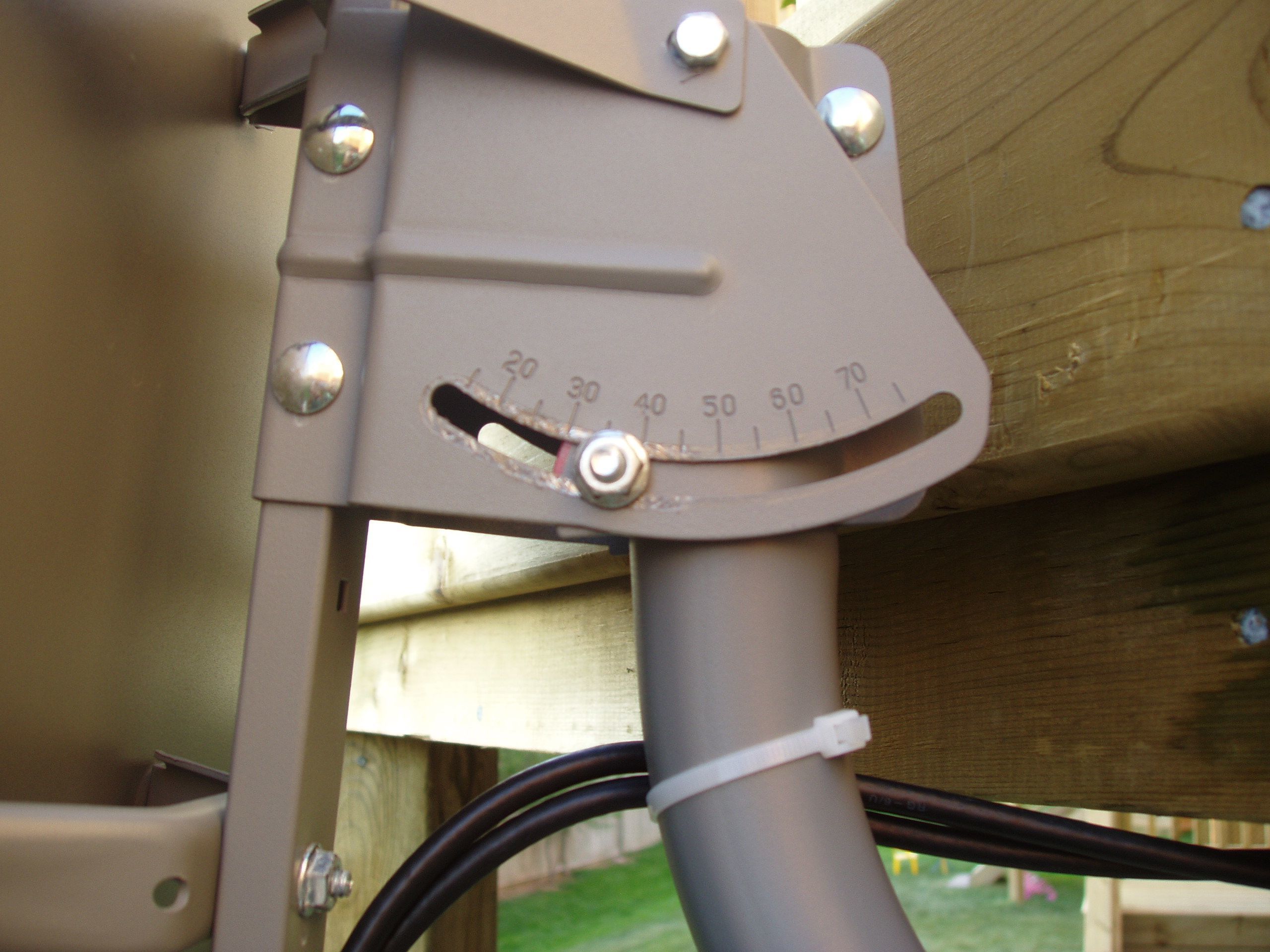

actually its how far north you are, which is weird because for G10 my elevation is about 30 on my dishes. (and I'm at 45N 93W)
Thanks again Iceberg. I really appreciate your work here.
Based on your experience, I think one of my next moves is to go with a .3db LNB. As for the NHL, that's good news. I can live without commentators, no problem. And for the photo, I don't think you should change it. I think its great!
That's very interesting about the elevation. I guess its possible my mount is not plumb. I thought I got it spot on, but who knows?
Some elevation mounts were goofed so they are off. I have a Fortec dish that is off by about 5 degrees for some odd reason.
