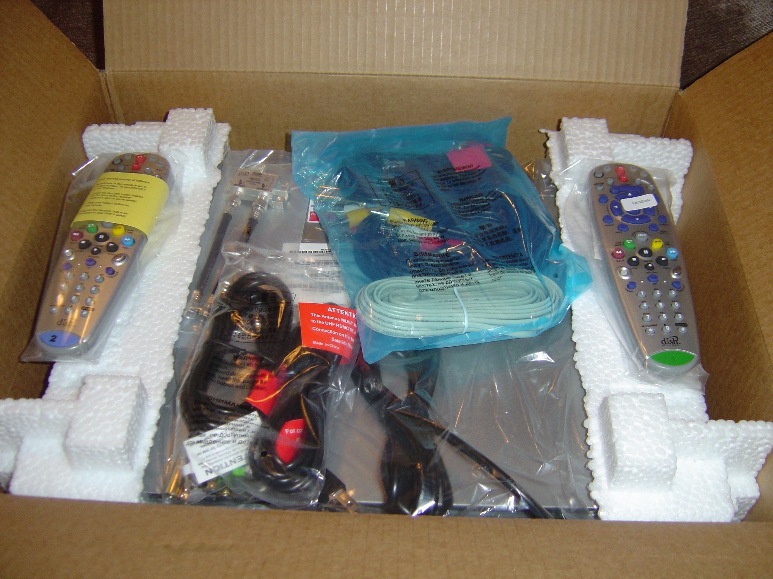

Just Received my 622
I came home to a nice surprise. A 17 lb. box with a 622 inside.
I placed my order on day one, 2/1/06 and given an install date of 2/25. Besides the receiver, here's what was included: remote 1 and remote 2; package 1 - with coax cable, composite cable (not component), phone cord, 4 AAA batteries; package 2 - with S-video, coax, UHF remote antenna, attenuator, 4 AAA batteries; package 3 - splitter.
Any extraordinary cable will be my cost.
Here's my equipment setup: 61.5 119 110 DP34-500, Dual-1(1), Feed(2), Twin-2(3). My TV is an LG 52" DLP with a 'DVI with HDCP Input'.
Obviously to those who know, one sat dish pointing to 110 & 119 while the other points to 61.5. In addition, I've got an antenna for OTA. My programming package is All Everything, HD and VOOM.
I intend to use the receiver in single mode for PIP and recording while watching a second program. Fairly standard stuff.
I believe I'm ready to plug and play without an installer. Am I missing something?
