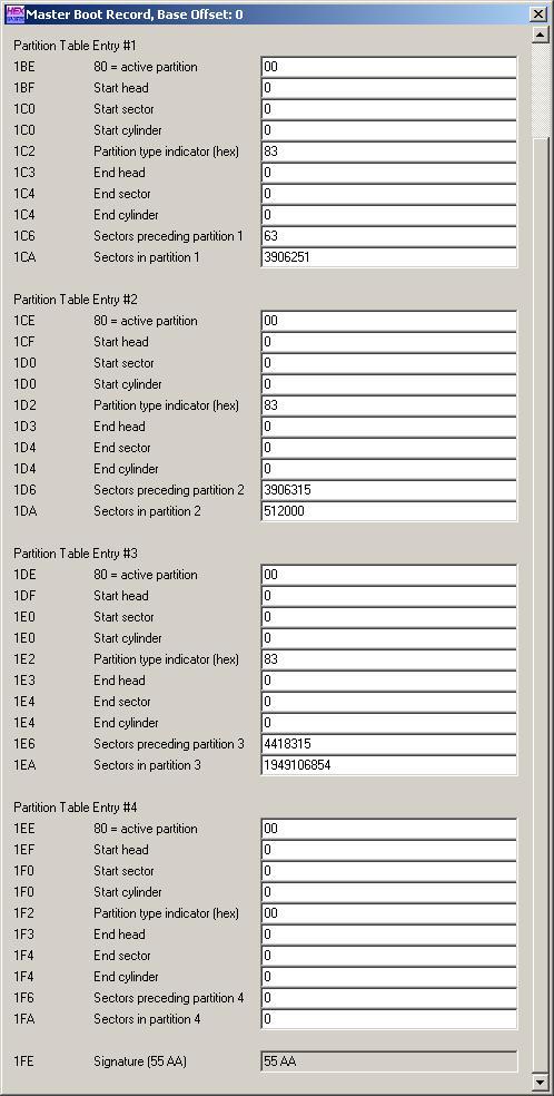

L524 on ViP211 does support 1TB disk, tested.
There is log:
[DBG_GRP_MW]<mw_hd_device_select.c:249> <02/21 09:01> open :/dev/sda
[DBG_GRP_MW]<mw_hd_api.c:901> <02/21 09:01> get_drive_capacity: 1953525168 sectors
[DBG_GRP_MW]<mw_hd_api.c:904> <02/21 09:01> Size in Gb: 931
[DBG_GRP_MW]<mw_hd_xmd_format.c:49> <02/21 09:01> HD: Reformating External Main Hard Drive.
[DBG_GRP_MW]<mw_hd_xmd_format.c:75> <02/21 09:01> Going to format partition 0 and command is mke2fs -m 0 -q -jF /dev/sda1
[DBG_GRP_MW]<mw_hd_xmd_format.c:75> <02/21 09:01> Going to format partition 2 and command is mke2fs -LEHD -m0 -b4096 -TLargefile4 -i7626752 -jF /dev/sda3
[DBG_GRP_MW]<miniwatchdog.c:809> <02/21 09:03> Reformating of external hard drive done ....
[DBG_GRP_MW]<miniwatchdog.c:810> <02/21 09:03> Reformat finished at time ..................
And a partitioning scheme. Compare to MBR what I posted before when 211 didn't use it after formatting, there is no change.
