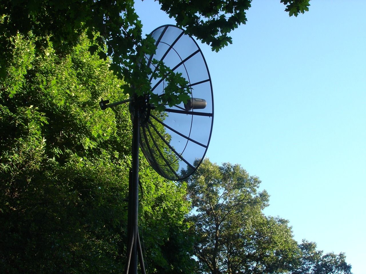

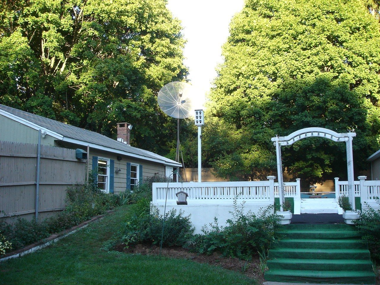

Under the pole facing south? Ok... seems to be pointing more west than south right now, but I'd need to use my compass to be sure. It's a pretty massive pole with supports struts in a nice big concrete bed. I might have been wrong about the initial pole height, I'll try and get some measurements of that today. Hoping to find some part numbers somewhere on it.

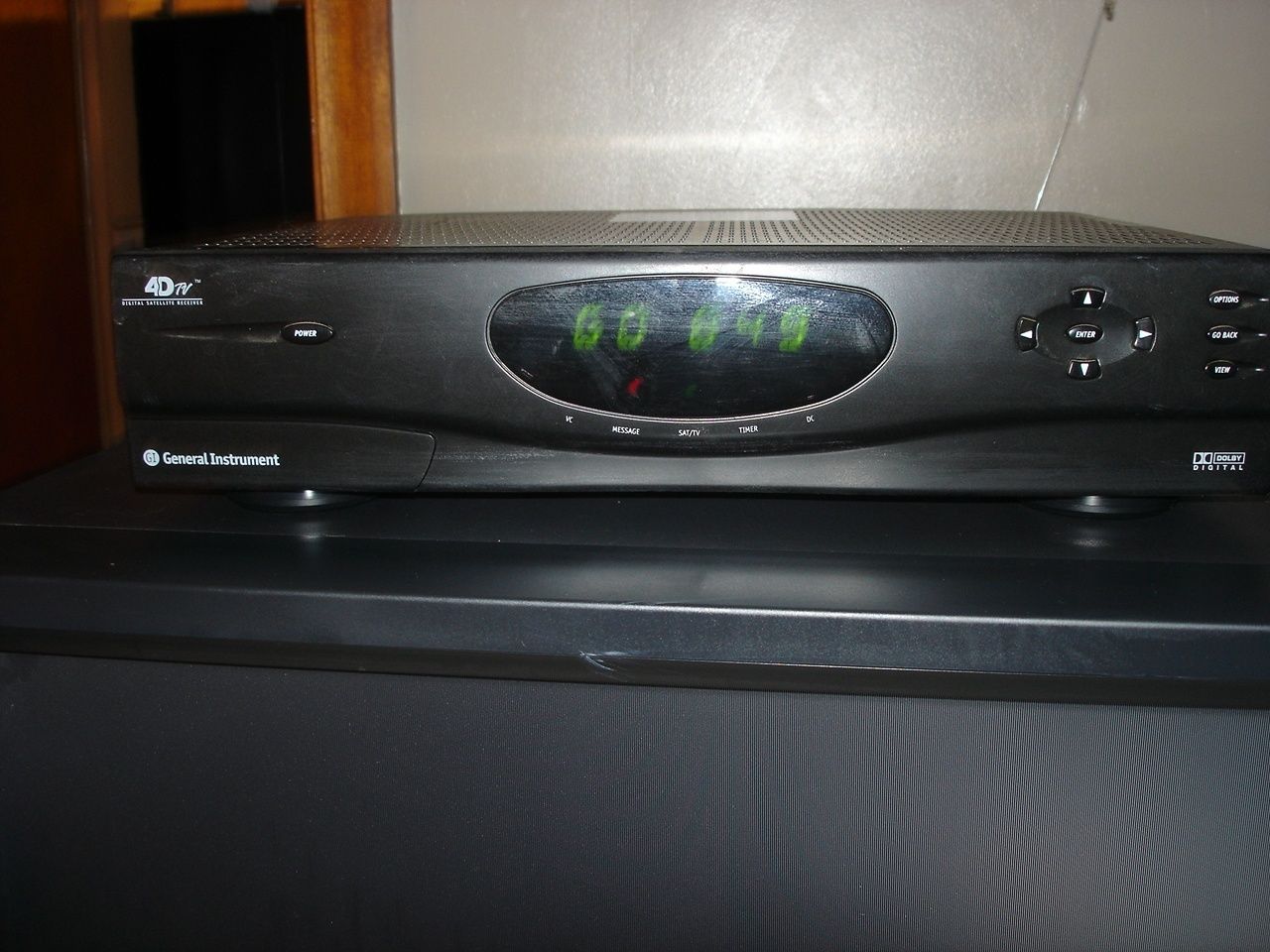

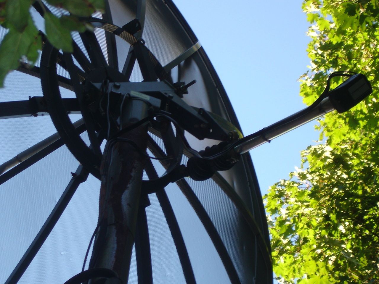

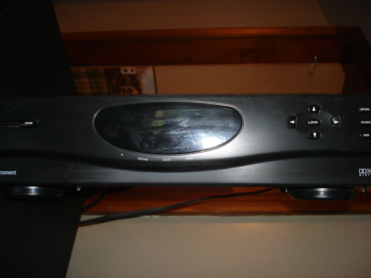

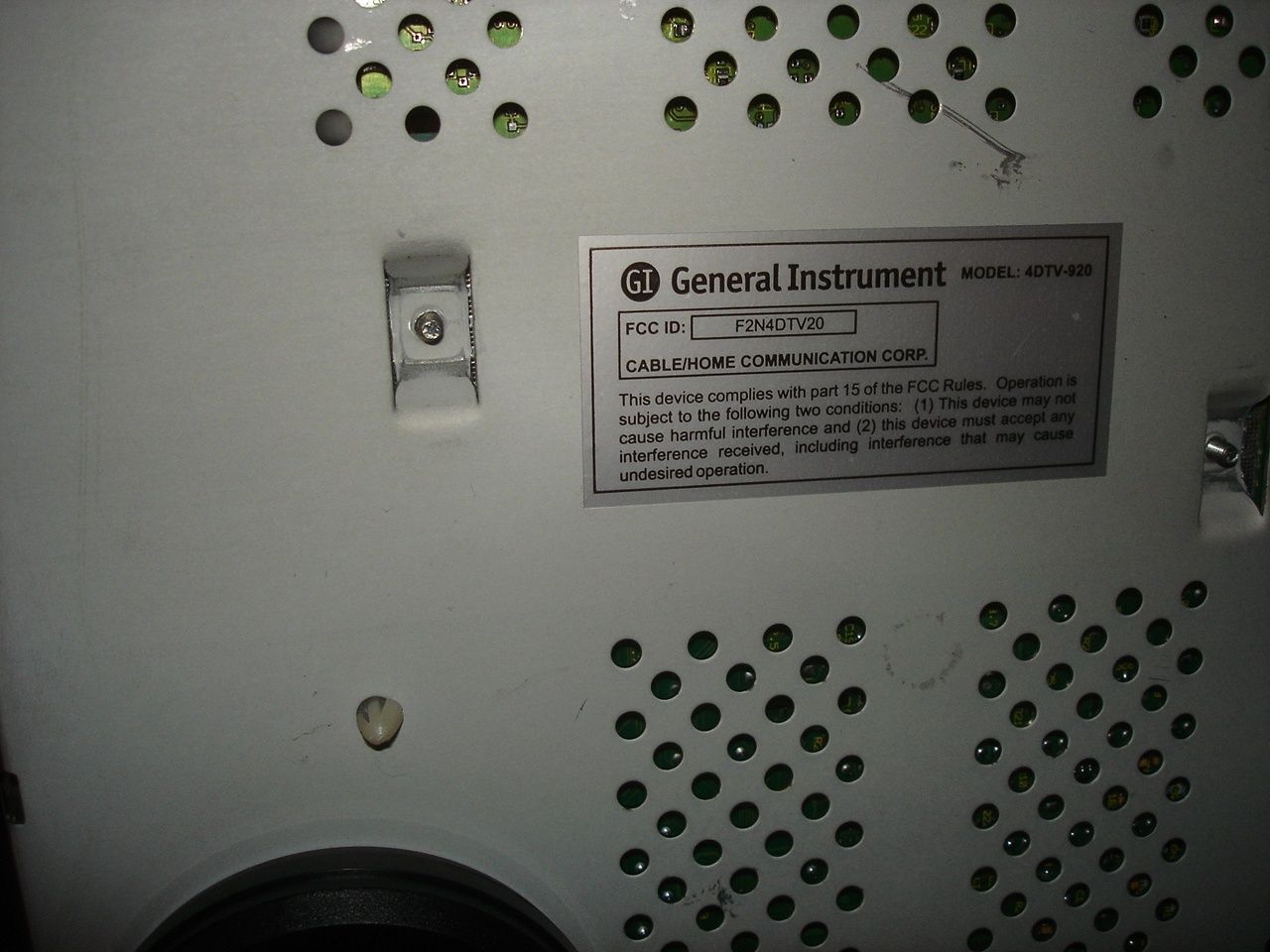

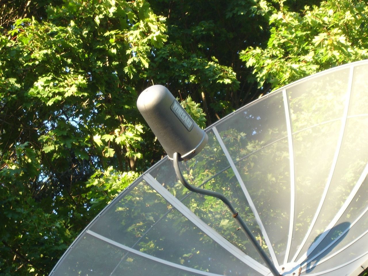

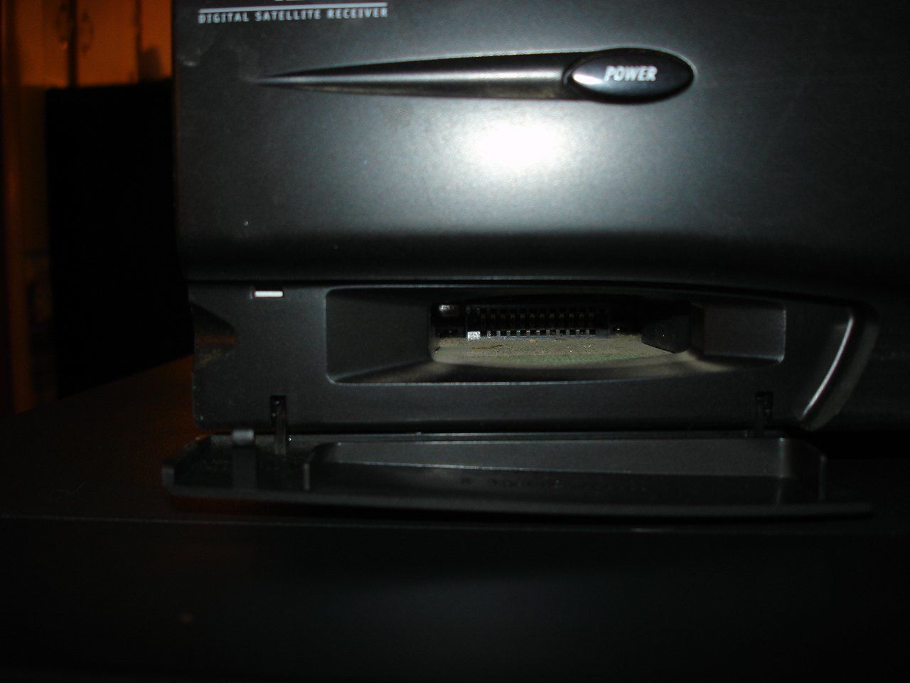

Sooo... I was wrong about the size. It's about a 15' mast ;). I'm trying to attach photos. I'm a little lost about what I need to do to make it all work. I tried putting a channel up on the receiver, but I kept not getting anything. The dish btw is pointed at about 250d, and the receiver said something about G0 and G1.

Now I'm really getting confused ;). I've got a dish, I have (I assume!) some sort of LNBs somewhere (not sure where they are located) and a 4dtv receiver. I already know I don't have the HDD200, I don't guess I have the VCII+ board since I can't figure out what it is or where it would be, and I'm not sure what a slaved DVB box would be either ;). I'm starting to think I'm in way over my head!
There is only one way to describe your setup......SWEET!

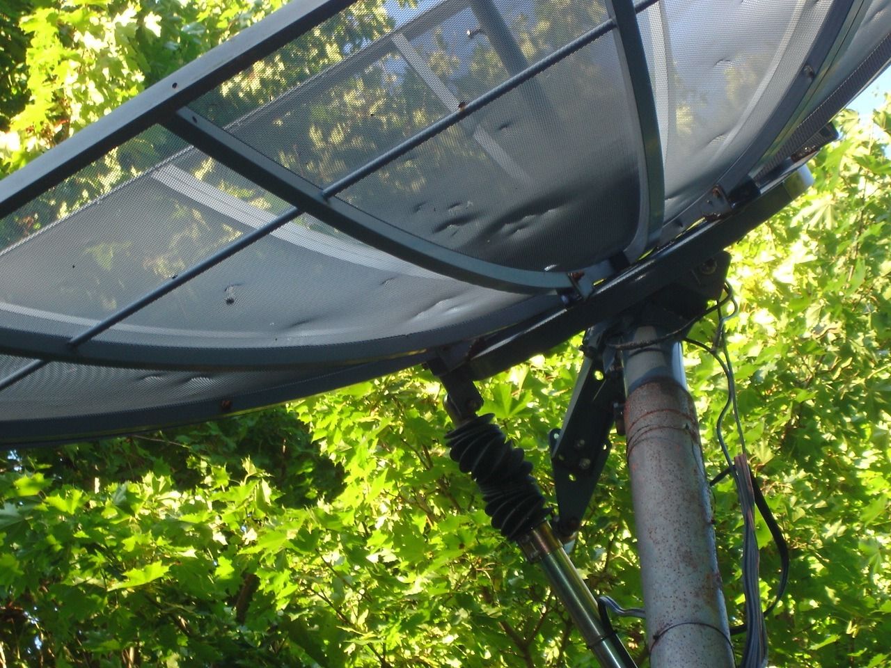

That Wingard dish is premo brand. Alitte hail damage it looks like--I don't think you will have a problem- tdti and the other guys might know more about that.
Your dish is capable of C band and KU band, if both types of lnbs are on it. I am sure there are cause it looks like a newer setup.
You are inheriting a great setup. Makes me jealous. :)

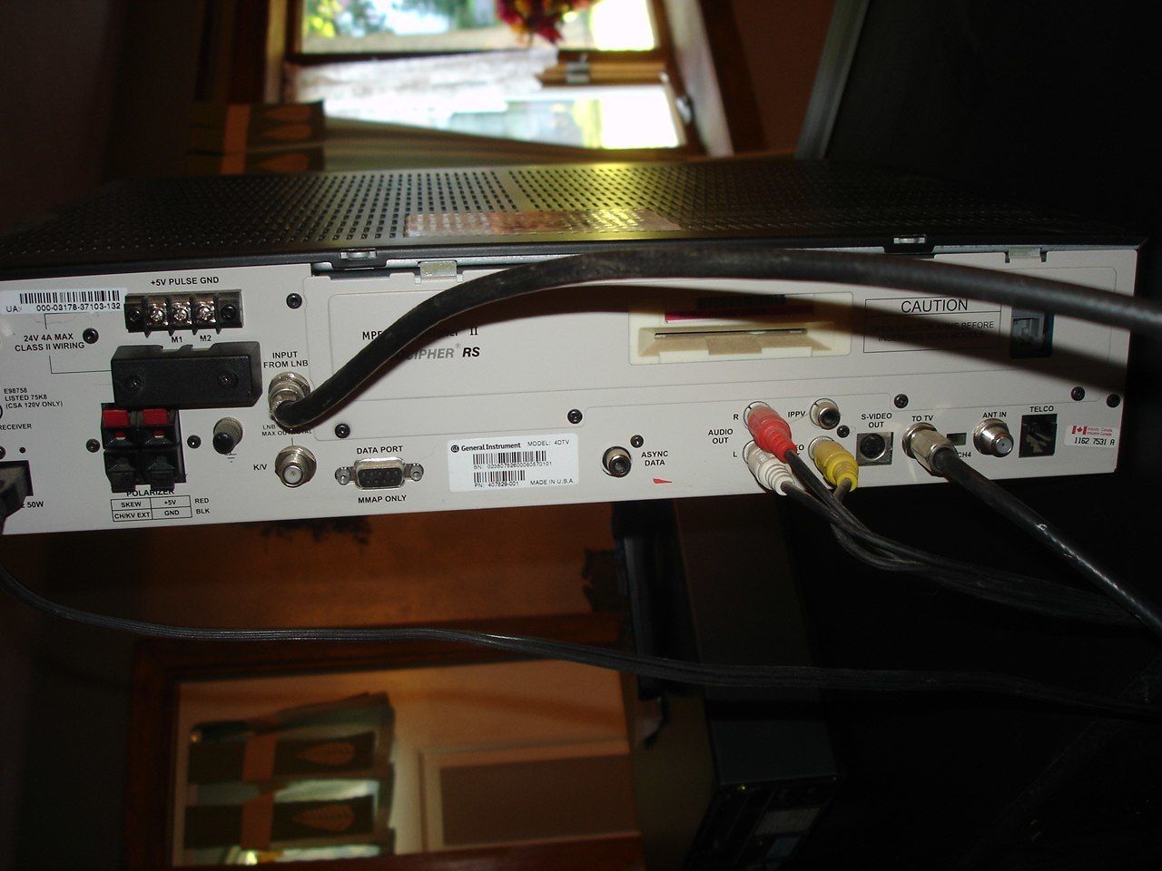

You can see if you have c/ku by looking behing the 4dtv and see if both the c and ku inputs have a coax connected (first set of coax on the left of the 4dtv)
Well I looked at you pics and you do not have Ku-band connected, so I would guess the setup is C-band only. (very easy to upgrade)
