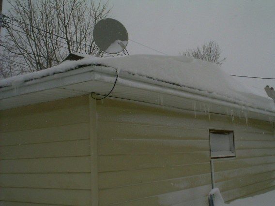

Just braved the "ROOF" to try the above out for ya! :devil:
It did indeed seem to effect the positions, but under USALS I hit "Go to Reference"
And all the positions are correct :) knew there was a way round this :)
I aint going on my roof until the snow stops and I use the snow rake to get it off there :)
Dont blame ya!
Pete,
That pic looks my roof most of the winter. Will you folks please keep the snow out there, we are almost thawed out here (roof is clear) and really dont need any more snow. Puts a damper on playing with my roof mounted dishs.
