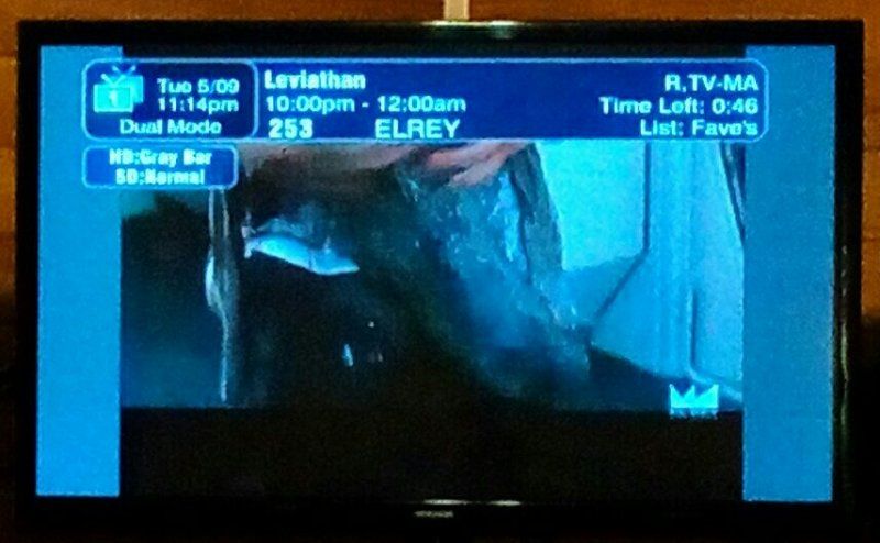

Here's a pic of ElRey with the gray bar option working and in the correct aspect ratio:

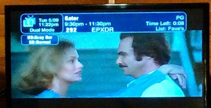

To contrast, here's a pic of Epix Drive-in (292), set to gray bar (not working & aspect ratio wrong) taken a few minutes later:
What I find weird is that that elrey and laff (which work correctly) are on the same satellite (61.5) and transponder (9)...
Epix Drive-in is on satellite 72 transponder 15...
Does anyone know if Dish has done any channel/transponder "switching" within the last 3 weeks..?
Could this have anything to do with my predicament..?
I have to conclude it's a 222 thing since both yours are not changing aspect correctly but I can change any SD channel correctly that I have tried and I see no one else showing pics that they can not. Perhaps there was an update that either caused a setting change you are not aware of or the update itself is the problem.
Reactions: Stormy_2021
Yes, a bunch of standard-def channels were recently moved from 61.5 to the 72 satellite, so it might not be a coincidence.
