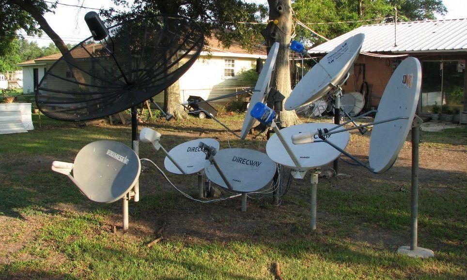

More dish fun
Ouch! Well, that IS a bummer.
Like the picture. Looks like the big dish had lots of kids.:)
Wonder what you neighbors think of all those dishes?

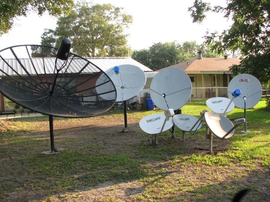

Well I added in another Directway dish last week.
It was one of the batch of dishes that was recently gifted to me by a very kind individual.
There was an old pole in the ground that had nothing on it. I just couldn't allow that situation to continue!
I went through the stuff and found the parts to put together a complete Directway dish. I aimed it at 89w for the ABC stuff.
One thing I have decided, the dishes are all too close together, some of them are overlapping, most are so close that it limits where I can aim them.
It's a mess. So this fall when it cools off I'm going to dig up all the poles and re-plant them in a pattern that's not so stupid and not totally random as these are.
I've also got to get those bleepin trees cut down. I'm extremely annoyed that I can not get that Canadian satellite with that Dallas channel, HOT TV !!! :mad:
I wish I had another C-band dish that I could plant in a better place to avoid the trees. :(
Oh well. All in good time..
Now if I only had artistic skills so I could paint them up nice like Chapelrun did.. :)
