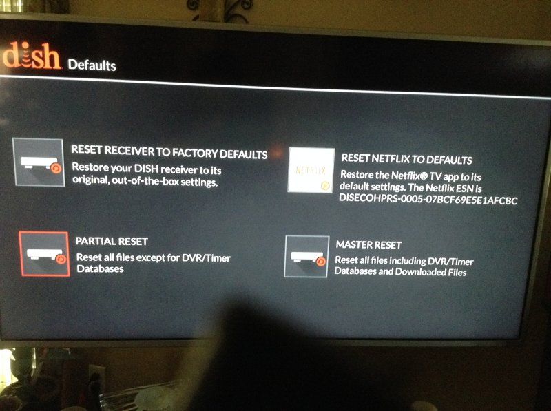

If you hit "reset to factory defaults" then the following screen comes up. Select PARTIAL RESET.

Of course today the program didn't record even thought it was in the scheduled list I stood there for a minute into the program to see if it would but it didn't. I pressed record and it started to record. I guess you have to do a partial reset every morning. Come on dish. Get your stuff together. :mad:

Yeah I see that screen except I have 5 options... Mines goes like this:
Reset Receiver to Factory Defaults, Reset Netflix To Defaults,
Reset Youtube to Defaults, Partial Reset,
Master Reset
So it seems I have a Reset Youtube option that you don't have. Wonder why everyone has a different Defaults screen if it's the same version of the software.
