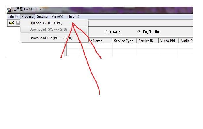

Save your .UDF file see attached screen grab.
I tried to replicate that once with mine and could not get it to go into a reboot cycle, gonna try again later or tomorrow though.
Yes save you .udf file that is there now, before reloading firmware.
