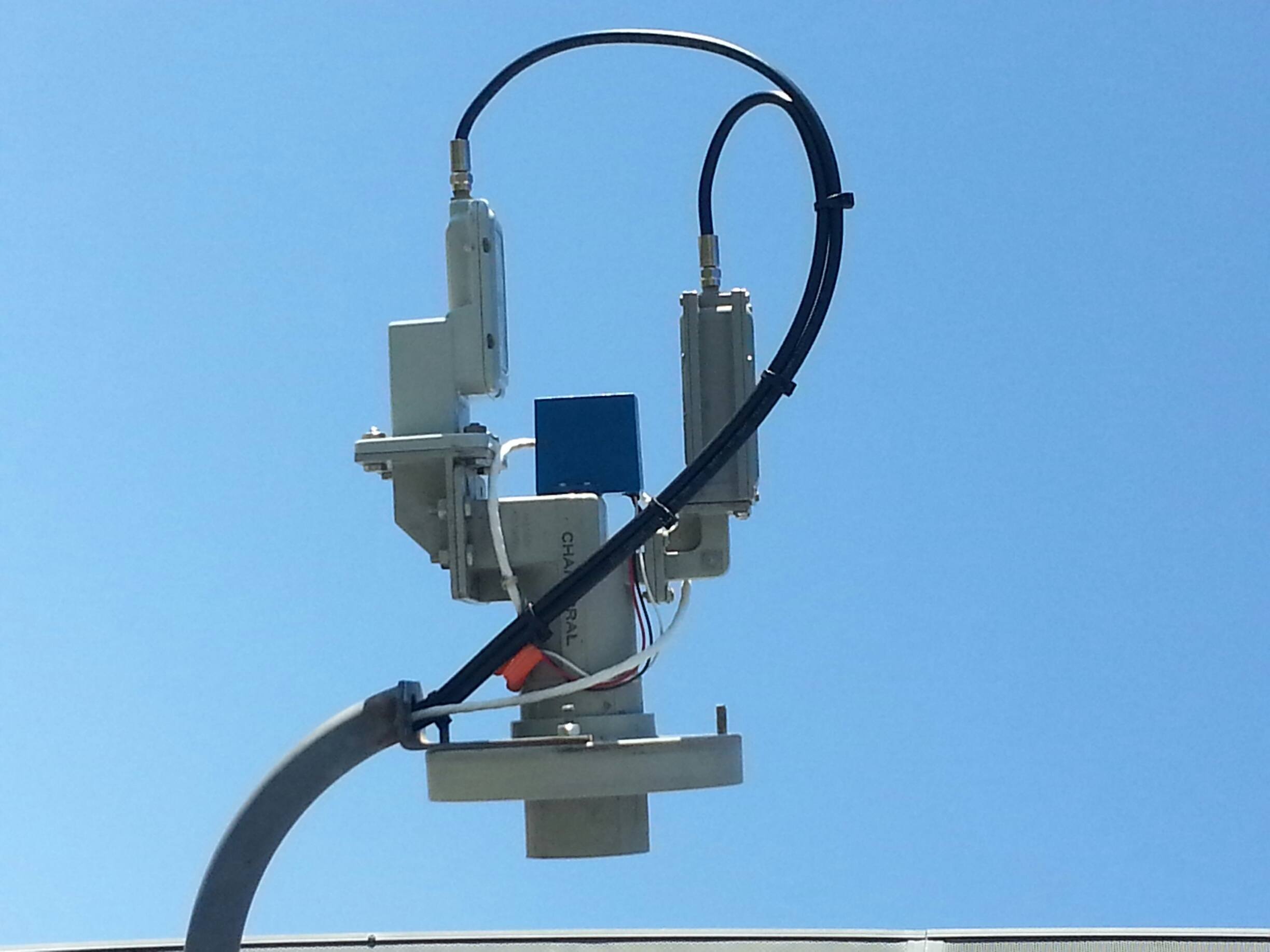

Prime - Thanks for the info. Yes, getting the right F/D set for the Pinnacle does make a difference. My Chaparral Servo Horn wasn't set up correctly for the dish. Once I set it up correctly (1.25" from the face of the scalar insted of .800", there was a noticeable increase in signal strength. I sent a message to Pendragon asking him a few questions. I have a button hook instead of a quad support. So, that (could/or could not) be a good thing. No worries about the Dual Band Orthomode feed, I put my GeoSatPro 90cm dish with HH motor back up. The Pinnacle was way to rickety to maintain reliable signals on Ku Band (at least in my case).
It would be easy to put some spacers on the button hook. However, it looks to me like the scalar on the Chaparral Dual Orthomode feed would not be able to be slid back far enough to achieve the 1.25" distance from the front surface of the scaler to the tip of the horn. The 1.25" was achievable on my Dual Band Servo Feed (see picture). I didn't see as big of an increase as Pendragon did. I got about 5% more.
