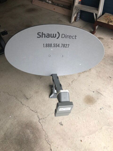

Do you have the 75cm dish? You'll need it in AZ.

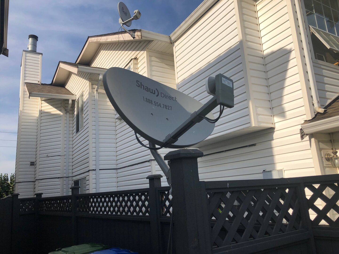

I'm not sure but here is a picture of it. Could I just remove the LNB and bring it with me and get a dish down there that would work? Or a larger one if that is what is needed?
Read the back of your dish and see if it is labeled 60-E or 75-E. If it is 60-E, leave it alone, and locate a Shaw Direct 75-E with matching XKu LNBF from a Canadian source before heading to Arizona. You should use a matched set for ease of alignment and maximum signal, even if you are only using it on one satellite (Anik F2).

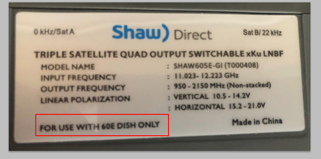

So what I have is a 60E, here is a picture of the LNB decal on the back.
Mellaby I see your offer for help. That is very nice of you and if possible I will take you up on that. I am in the Mesa area, are you around there?
So do I need to get a new xLNB as well? If so I will just contact Shaw DirecTv and get them to change it out. Would I need to bring the dish down as well or is this something I can purchase in AZ from you or others?

That dish and LNB is good for up in Canada. You'll need the new 75cm dish and 75cm xku lnb to match it. Bring that down to Mesa along with whatever receiver you have. I'm winter in Mesa. I'm not sure where you can get the equipment up here (maybe a ShawDirect installer).
That's the 60 cm dish. You need a 75cm dish and xLNB. Bring that down to AZ, and I'll help you out.
