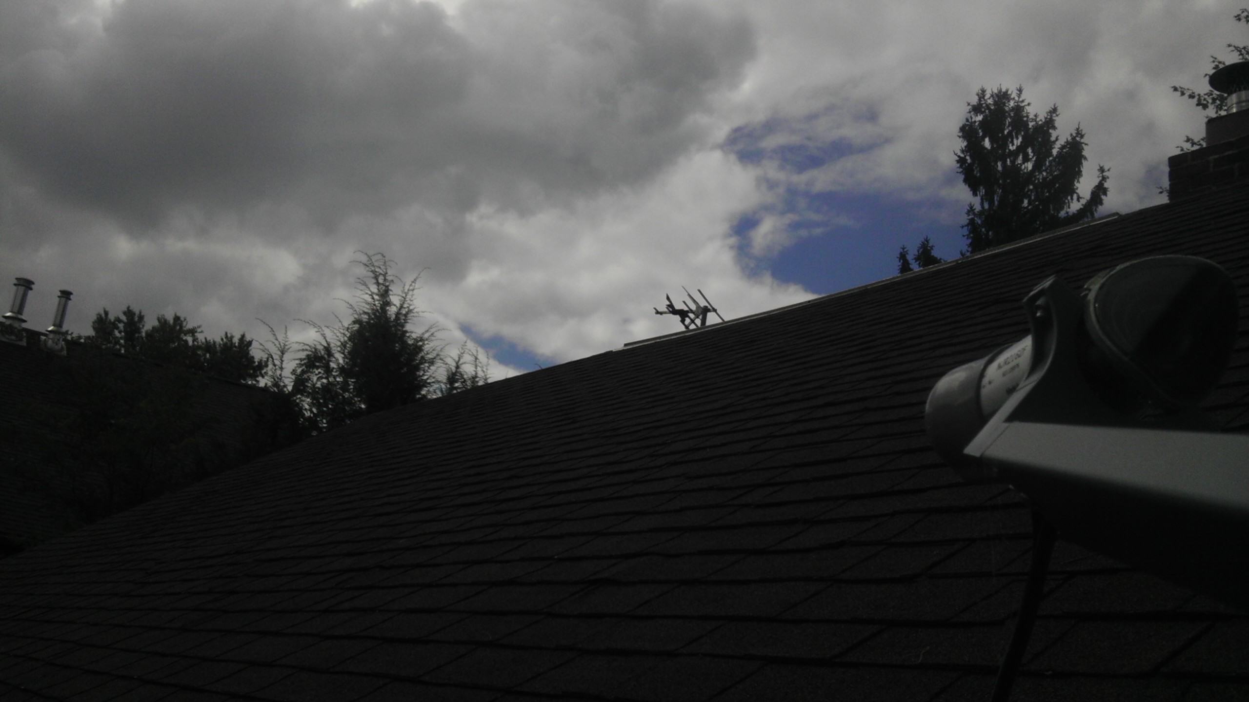

the angle of my roof is shown in the pic for 123 West.

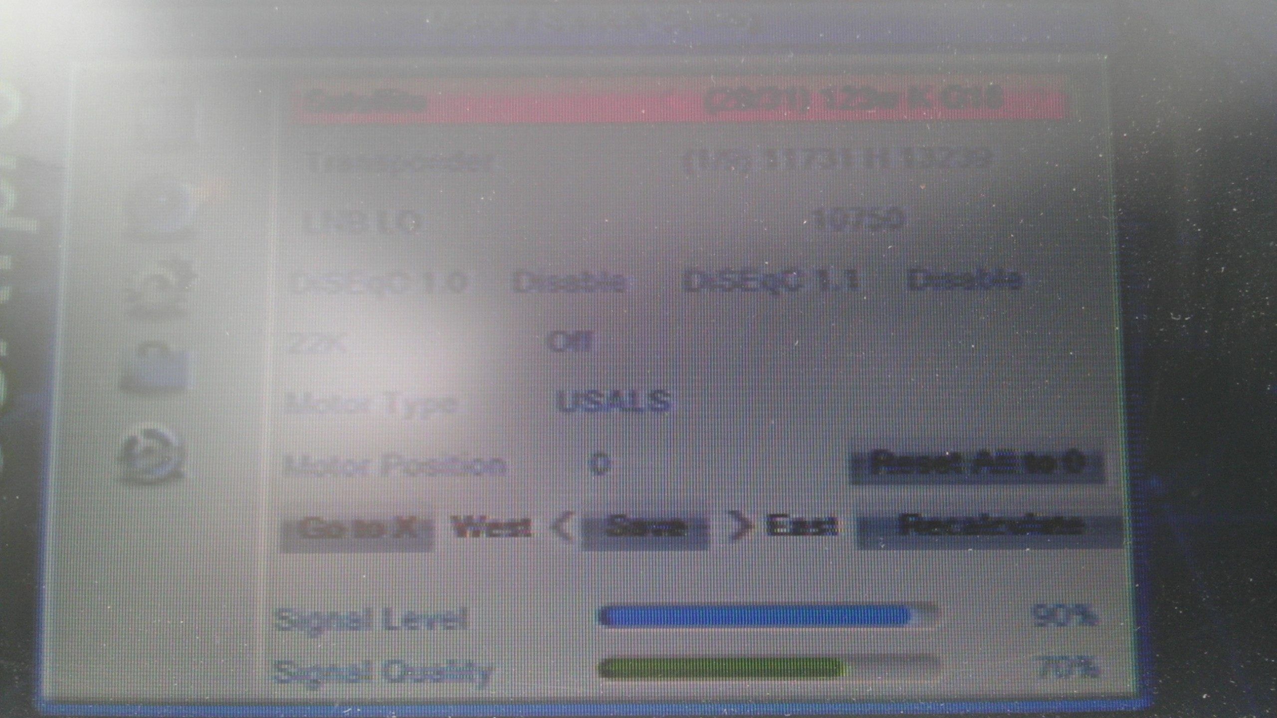

123 West - 70%.

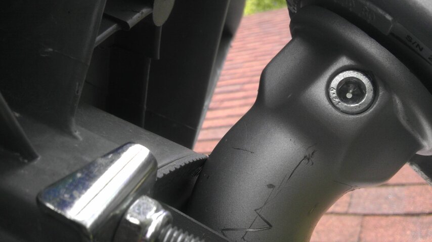

Mechanical limit of dish elevation - it is up as far as it can go.

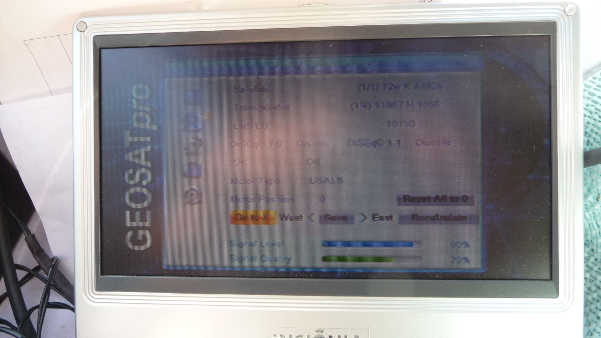

72 West - 65%.
Another view at 123 West, with my roof.

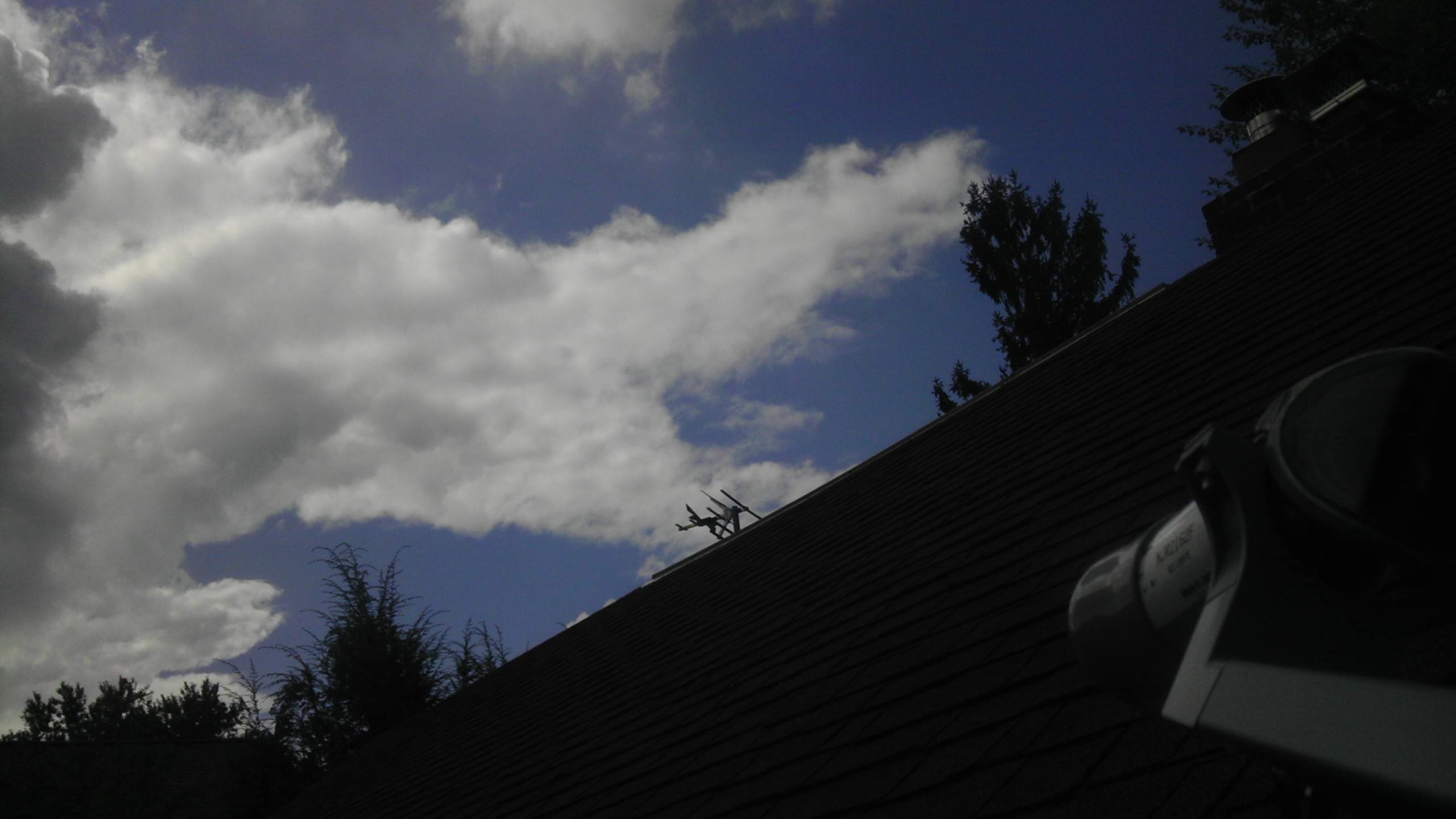

The picture of the sky at 72 West.

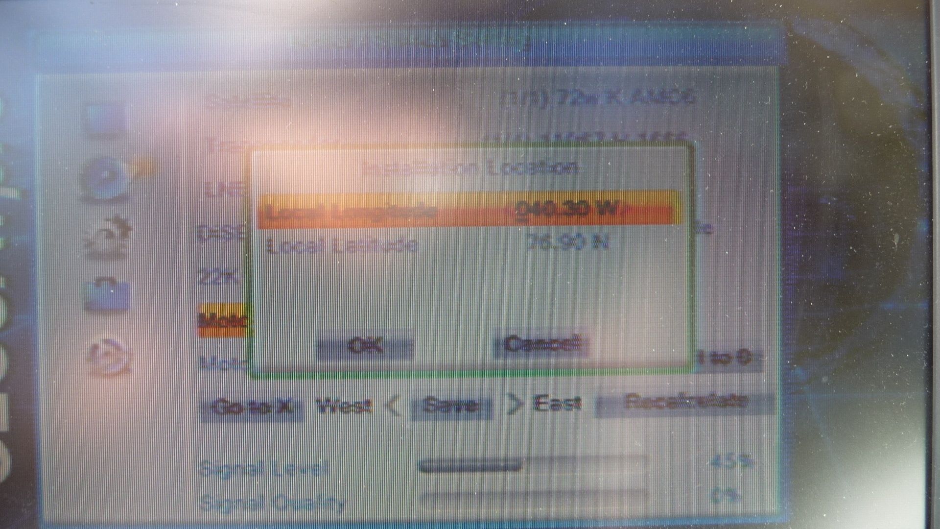

Okay, now that I've got some time AND it's not raining, I tackled this again. My latitude and longitude are 40.3 W and 76.9 N (Harrisburg, PA). I reset the receiver and motor, and when I try to use USALS to drive the motor to 72 west from zero, it moves it to about the 35 hash mark on the motor. That's way too far, and I can't figure out why it's doing that. I can see signal strength from 72 when I have it at zero, and also on 83 when it's at zero.
It's so frustrating--I had it working and now it isn't, and I can't imagine why the motor would drive WAY beyond where the next satellite should be. Any idea on that one?
If you have 40.3W and 76.9N entered in your receiver like you posted, there's your problem.
Okay, I swapped those numbers in the receiver a minute ago, so now my local longitude is 040.30W and local latitude is 76.90N. Is that correct or am I way off base? Because it's still going some thirty ticks on the motor from reference point to try to point at where it thinks 72 should be, instead of just a few ticks.
GOTO 0, (Reference) . Does the motor shaft align with the "0" mark? If not, reset motor.
Is receivers location set to Latitude 40.3N, Longitude 76.9W? Double check.
Is the satellite location set to 72° W?
I did reset motor after driving it with its own button (as opposed to using the receiver) to 0 earlier. I won't be able to check again until tomorrow afternoon.
Receiver is now definitely set at longitude of 040.30W and local latitude of 76.90N.

76 N Latitude and 40W Longitude. You are in Northern Greenland?
I think you meant 76.9 W Longitude and 40.3 W Latitude -- at least that would put me in Pennsylvania.
Double check :)

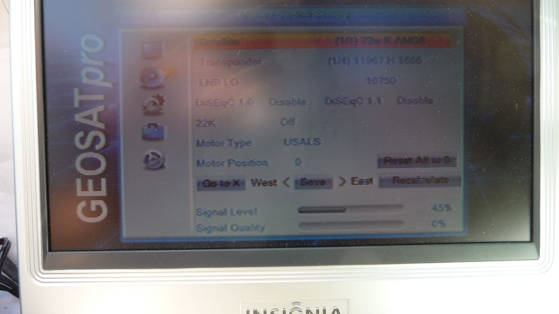

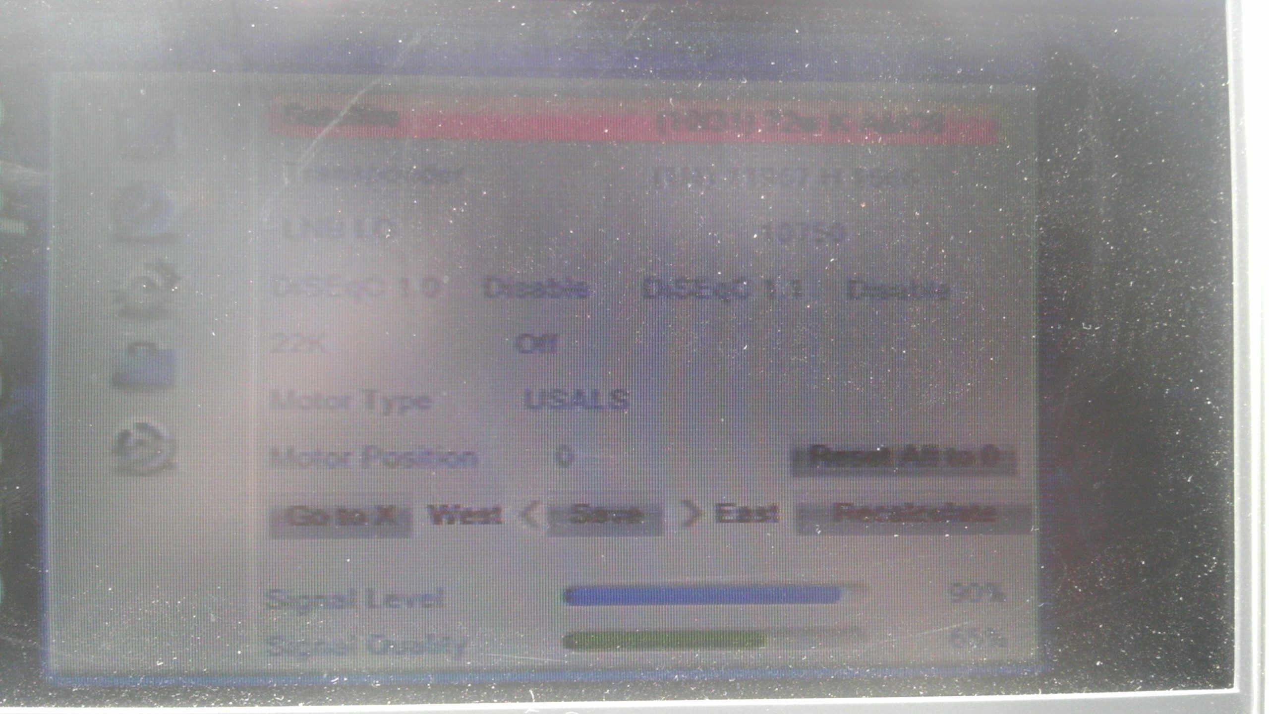

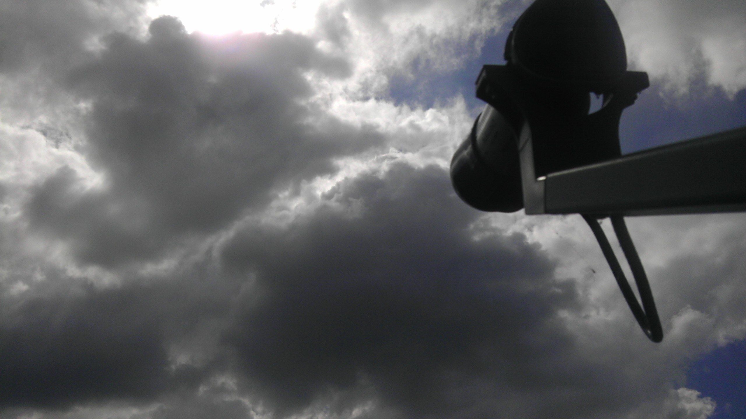

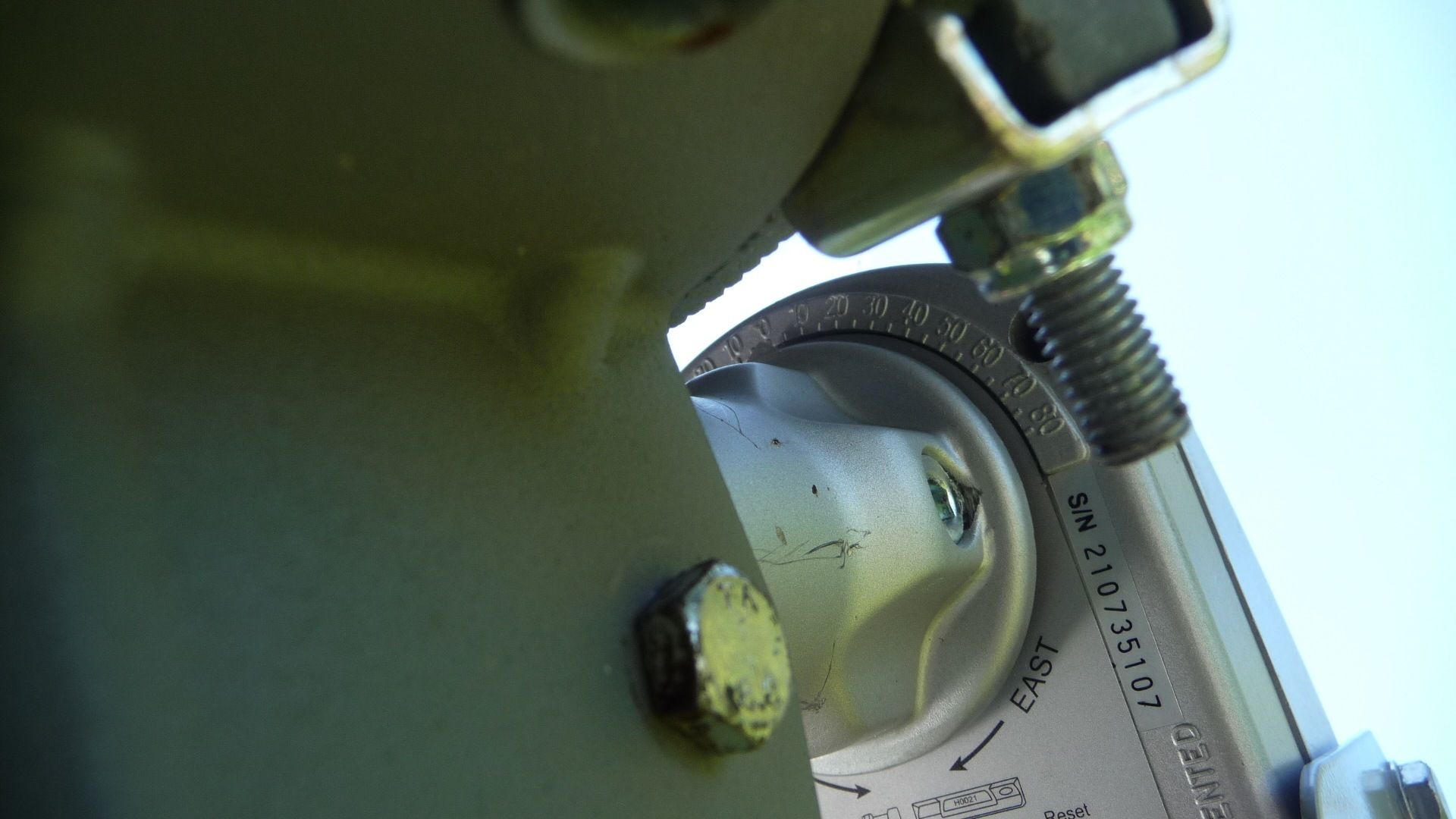

I'm still stumped as to the motor moving way beyond expected point. I just went out again. Reset the receiver to factory settings, drive motor to zero using its button, reset motor, and add a single satellite to the list. This time, I tried 97W. It moves from 0 on the motor to around 60, which is way too much. I added 72W, and the motor moves to approximately 30 degrees on the motor. It's the same problem every time. Edited to add photos:
My USALS coordinates:
A strong reading for 72W, which is at my reference point since I don't have anything viewable at my true south of 77W. I'm 99% positive that when my setup was working as intended, I'd peaked on 72W and used it as my south.
When USALS takes over and moves the motor to where it thinks 72W should be, of course I get zip:
This is the reference point, and I get 72W with high quality here.
When USALS takes over and moves the motor to where it thinks 72W should be, this is the result. The motor hash marks are at about 35.
