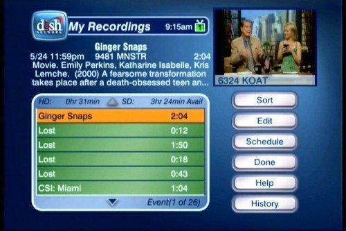

I ended up with 4 losts last night out of 2...
