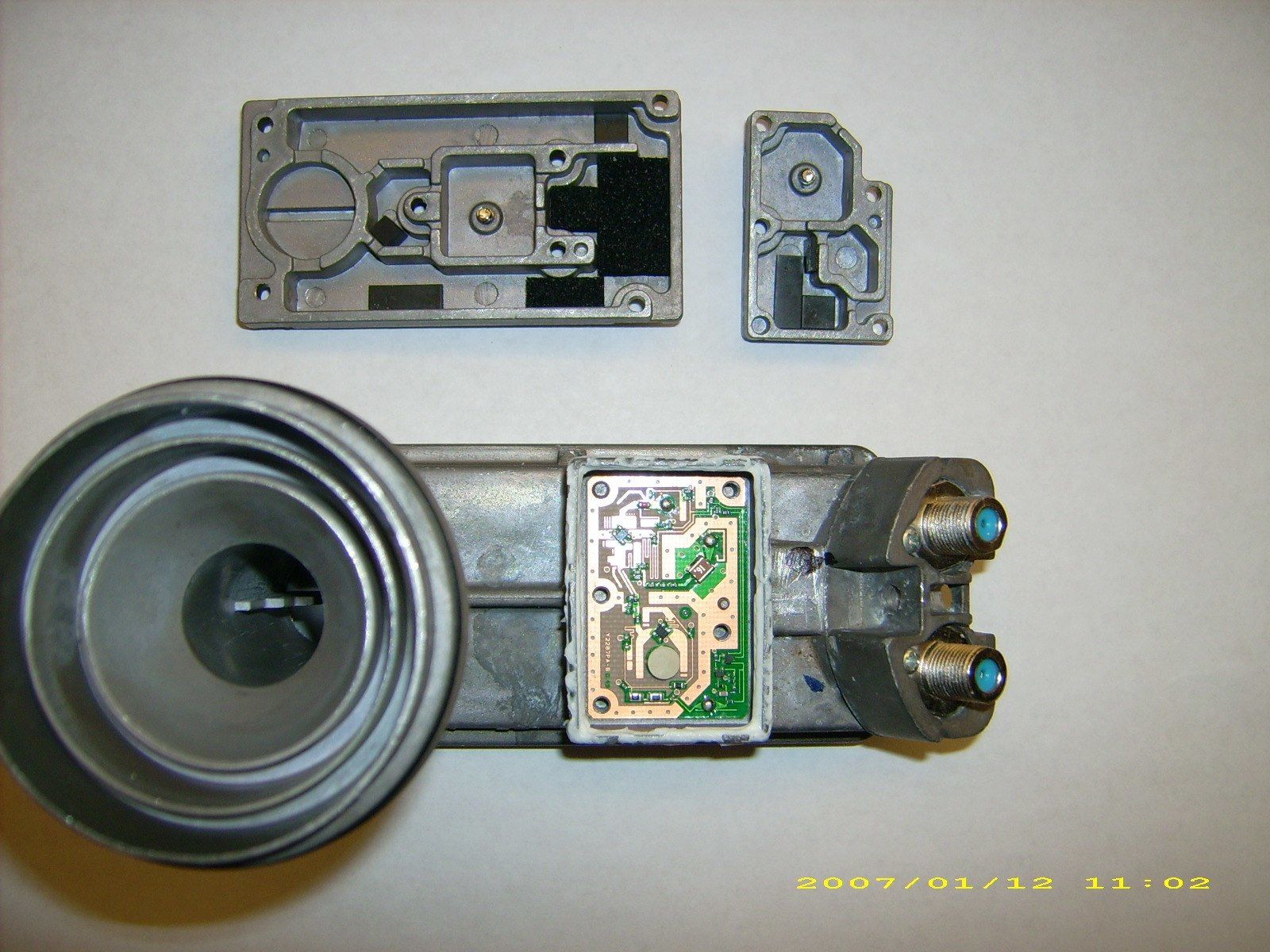

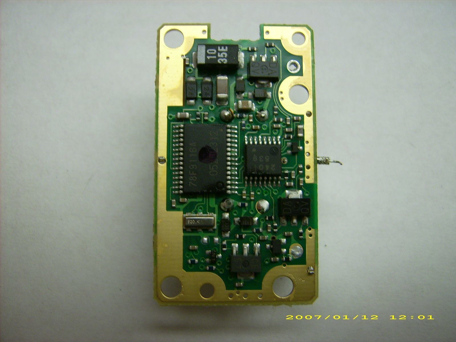

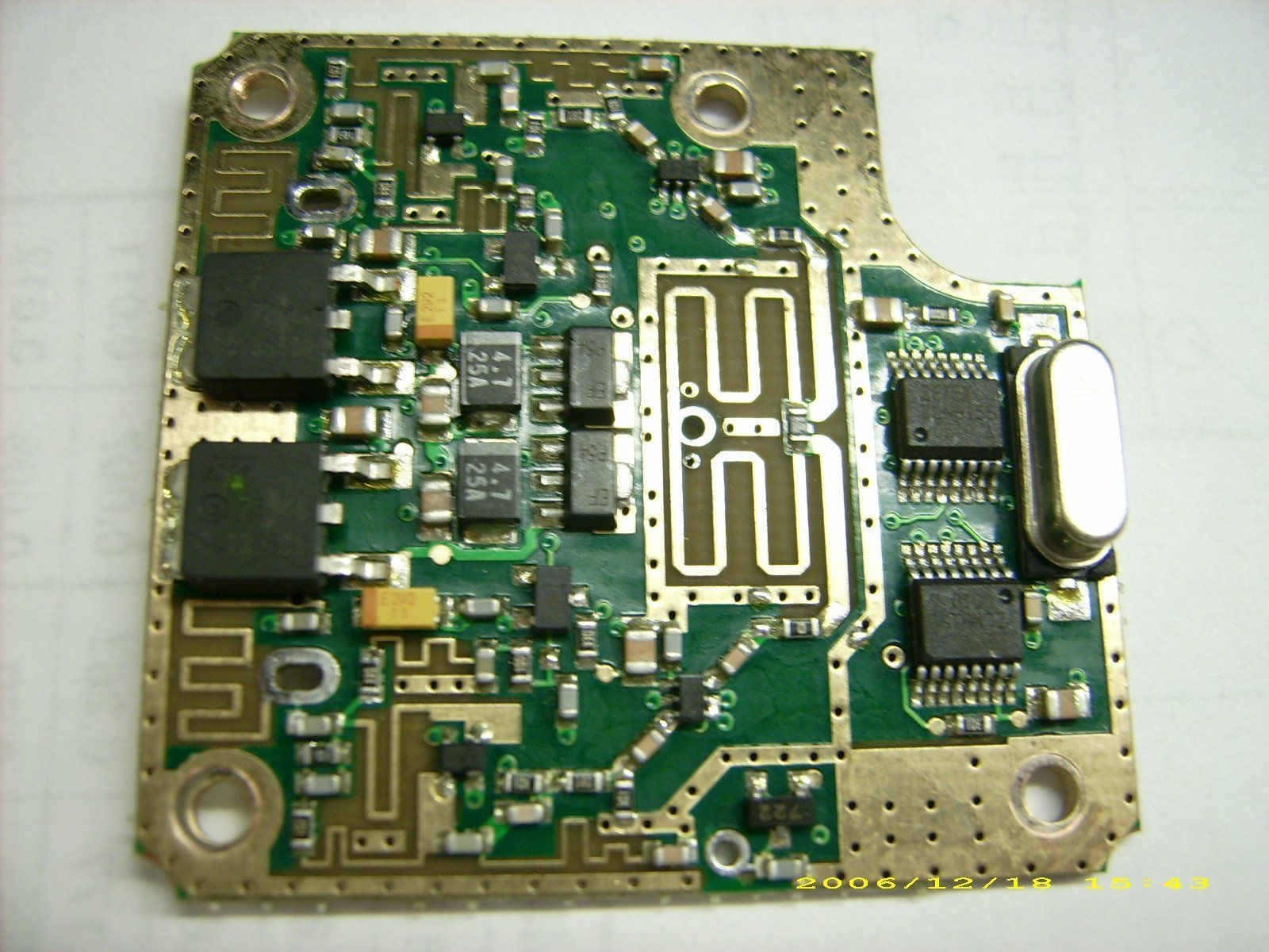

some pictures inside DP LNBF
sort of other type of mad scientist ;)

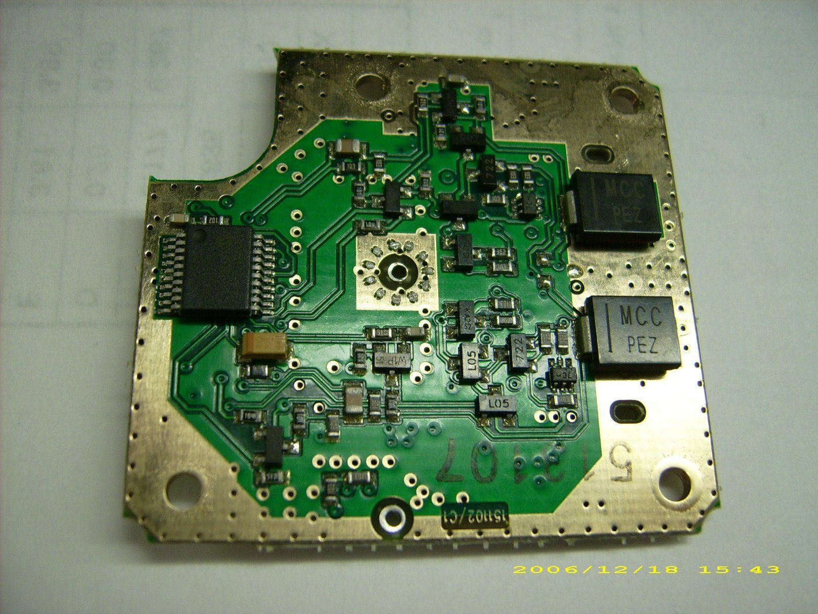

On top you can see two multiplexor control ICs (ZLNB155) - one for each output;
on buttom - Motorola custom processor processing Dish DP (DiSEqC) commands and 2:2 mux matrix.
(First picture - bottom side)

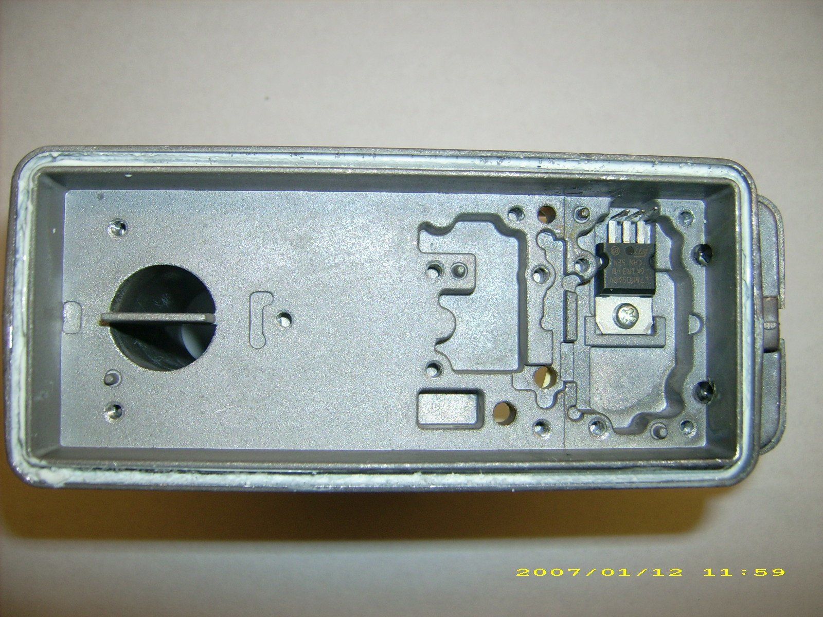

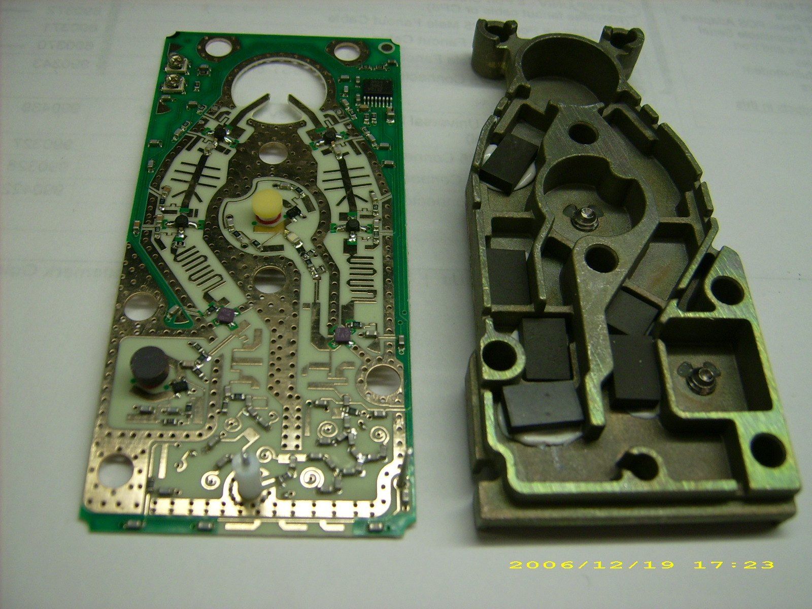

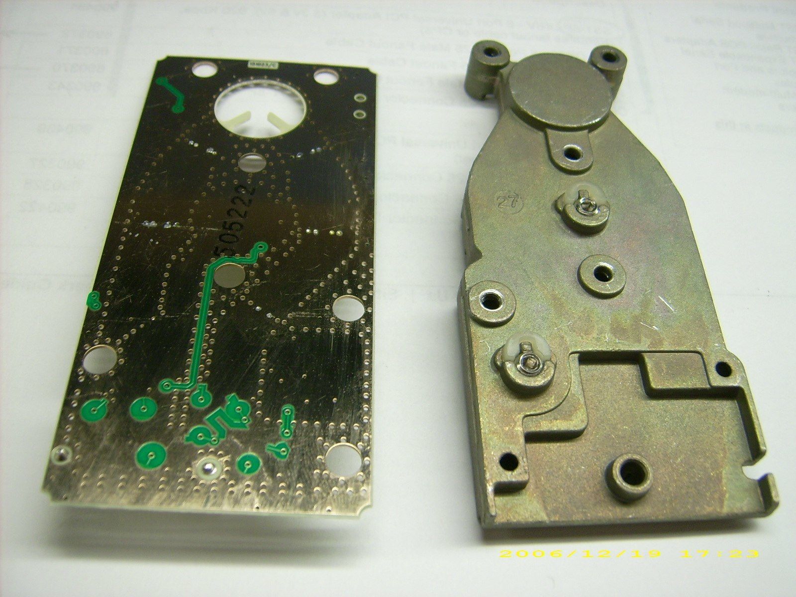

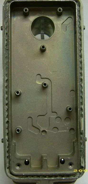

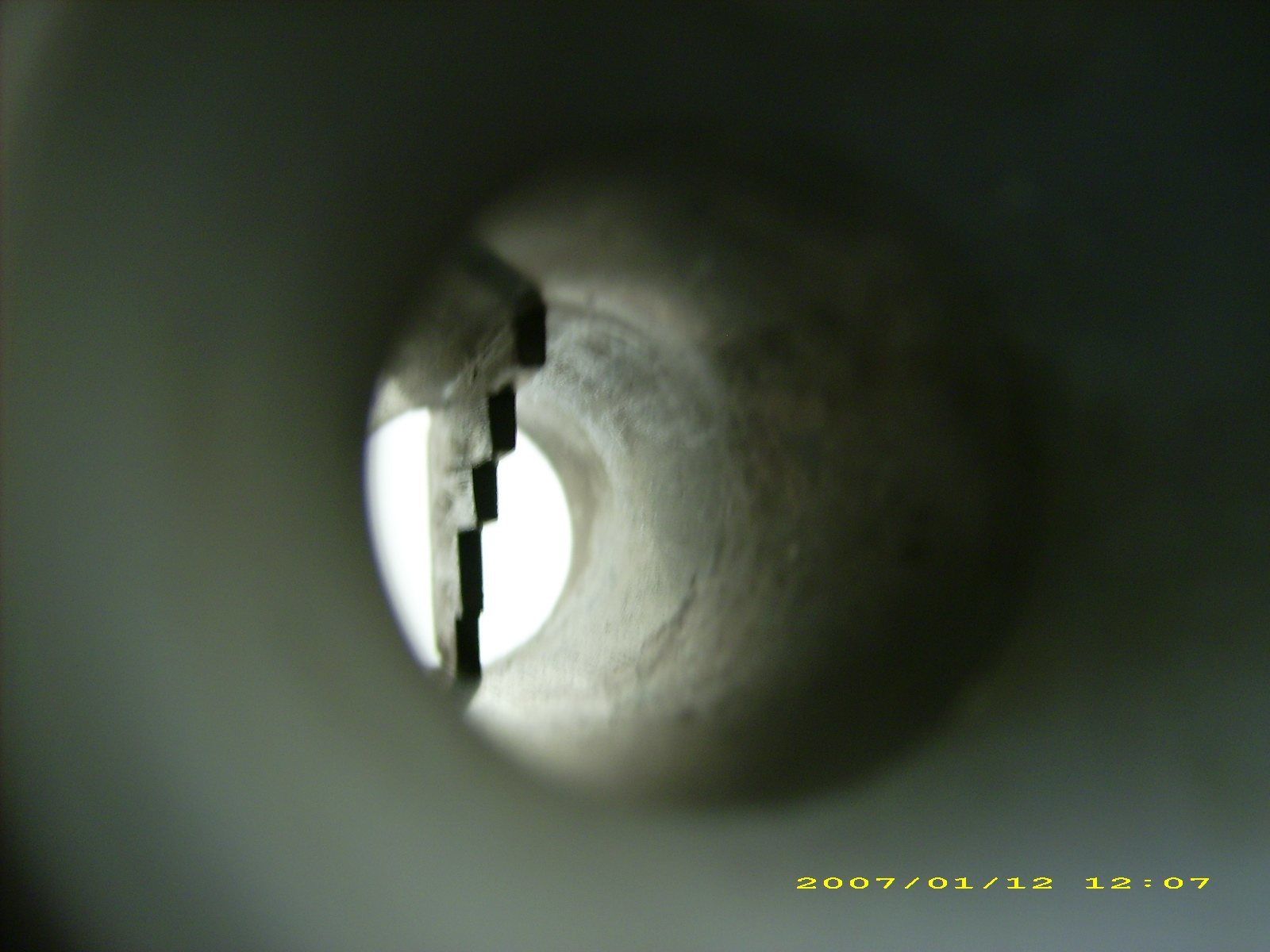

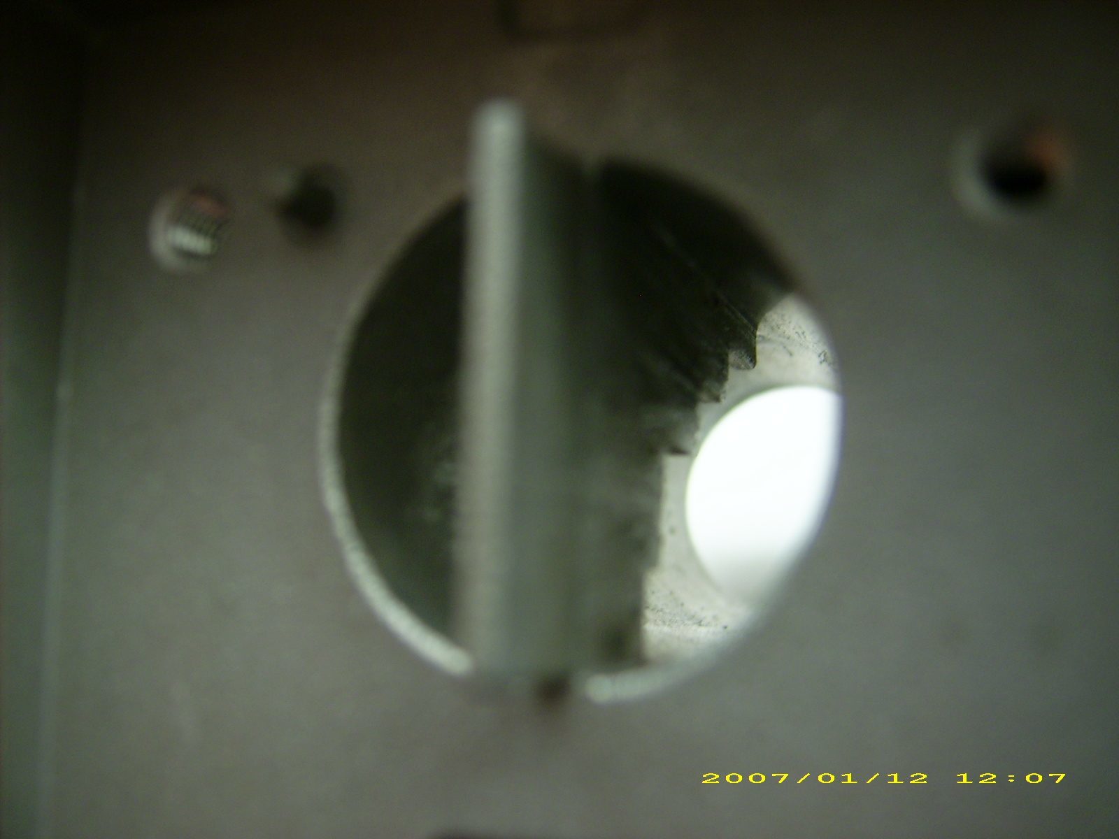

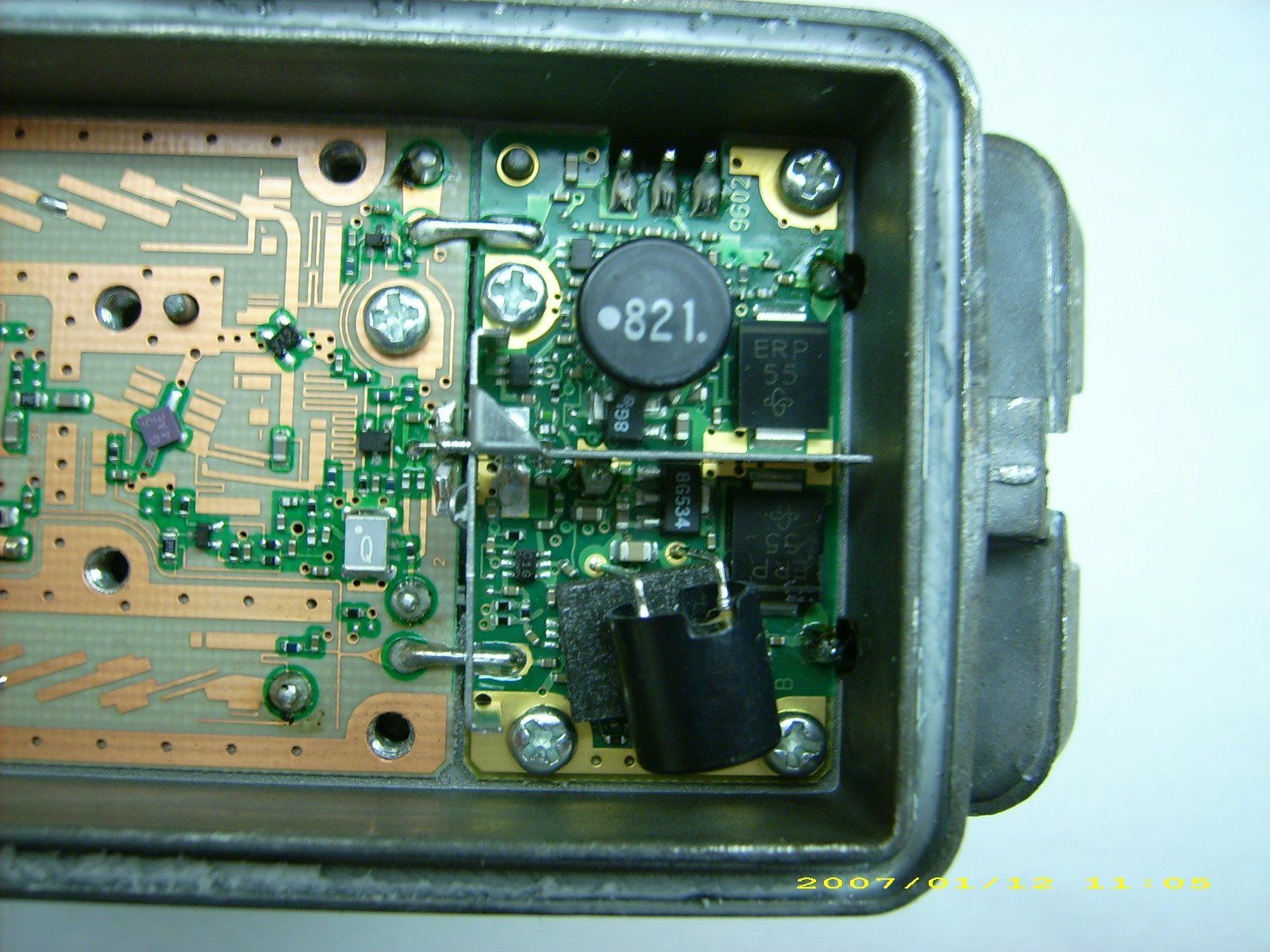

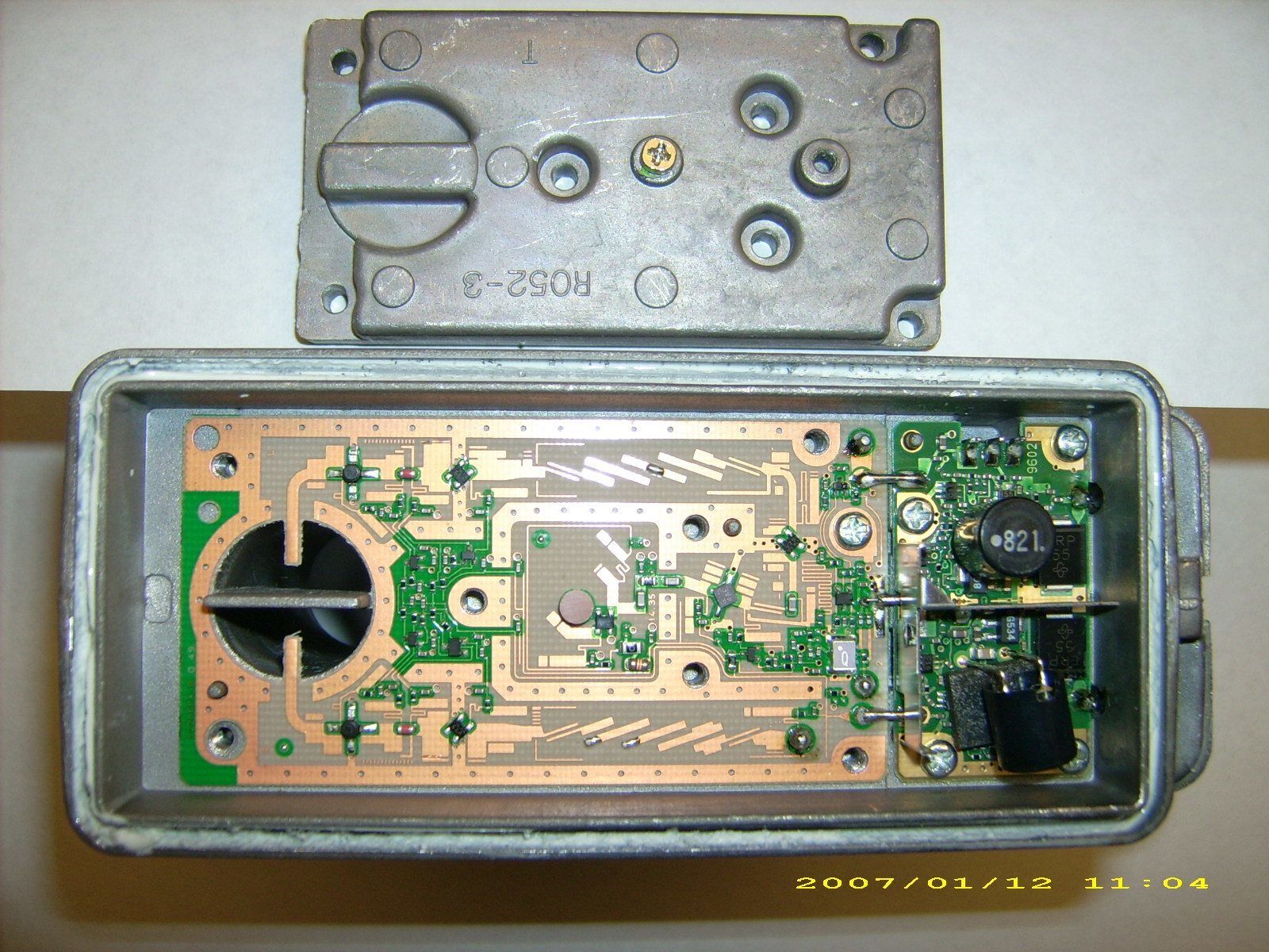

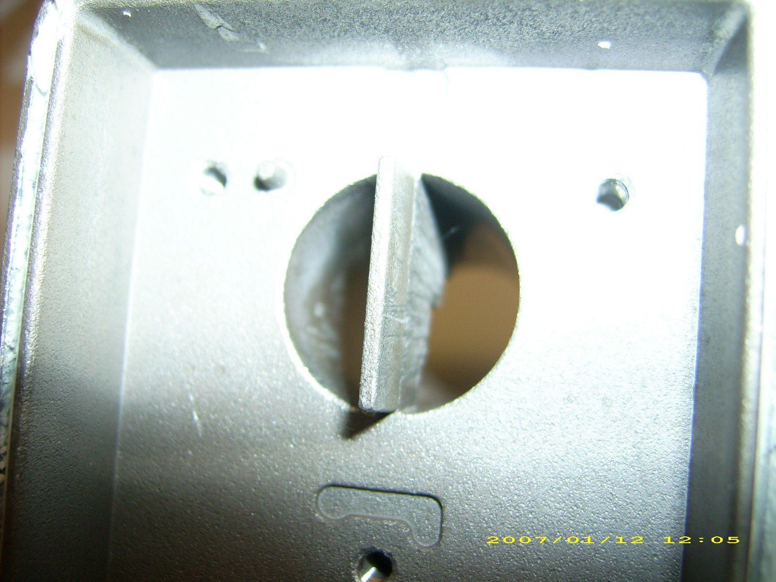

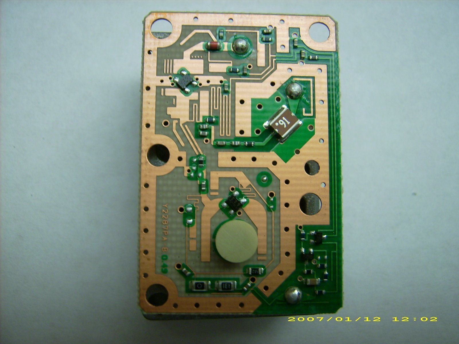

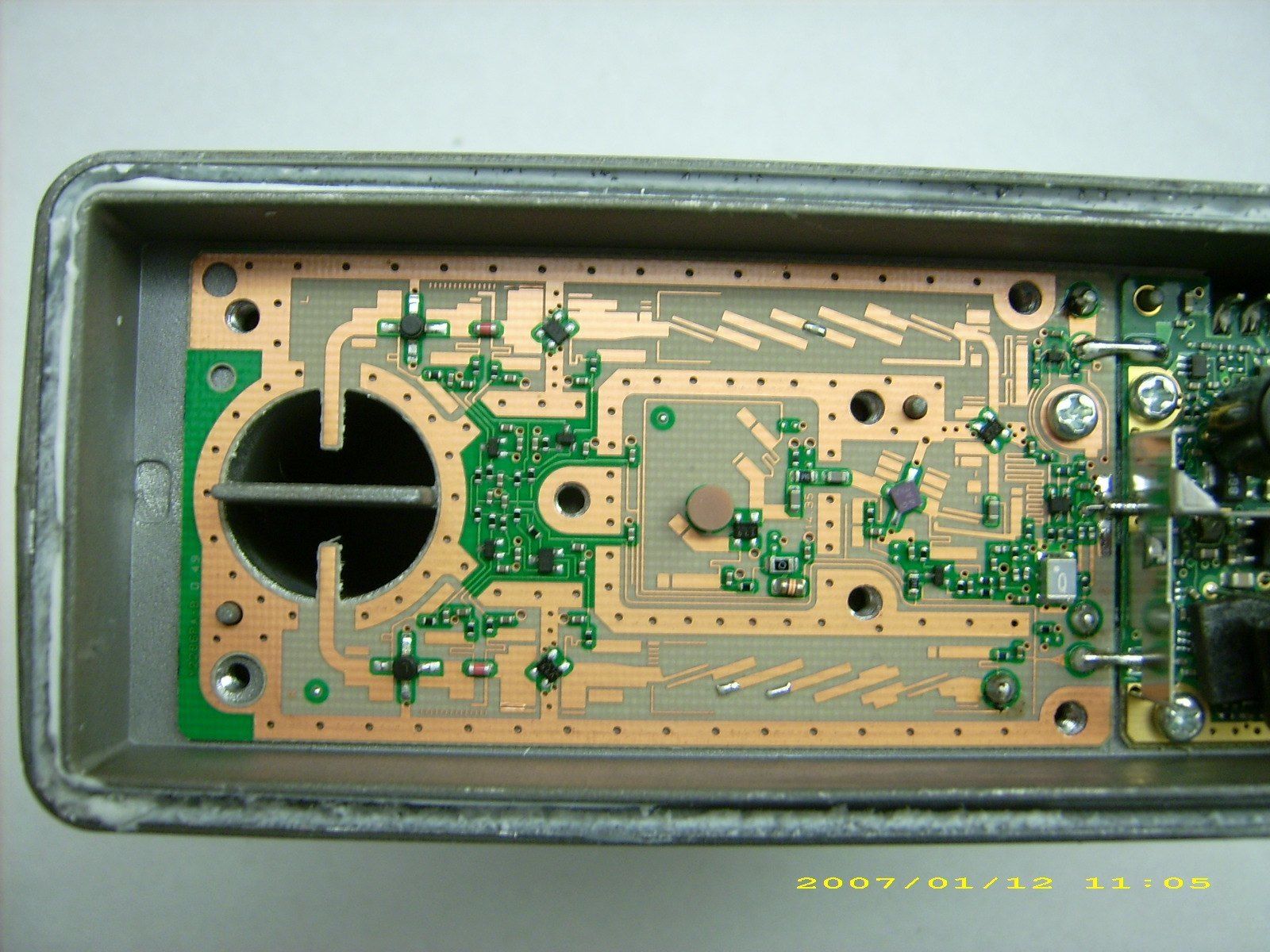

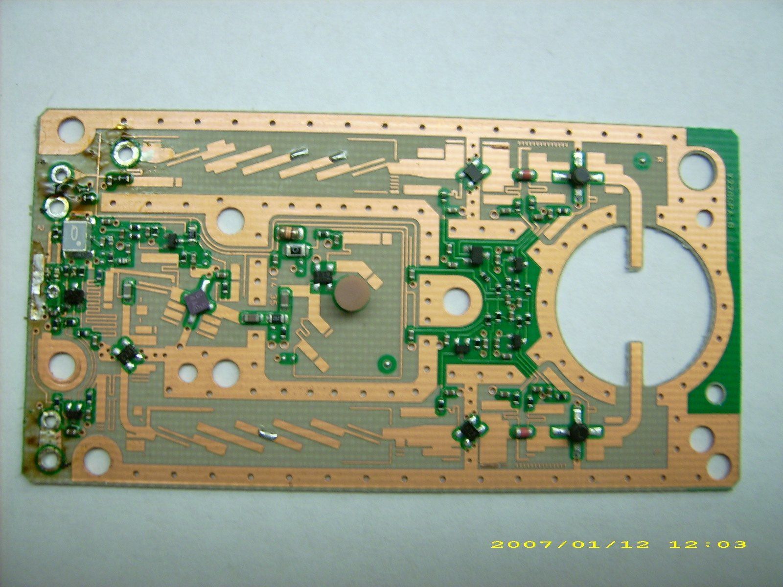

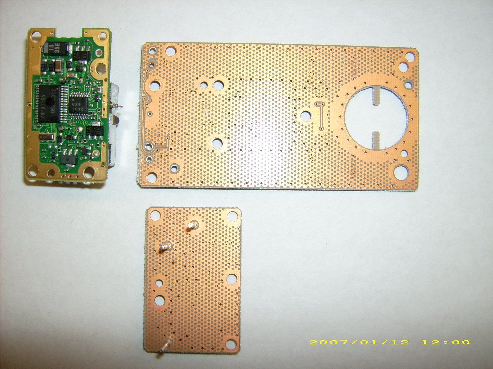

other model DP LNBF teardown
A few pictures before desoldering PCBs.
And after.
Check out how differently done the "de-circularization" mode - used different shape of throat's insert, now it's staircase metal type and V/H probes located under 180°, not 90° as in previous model.

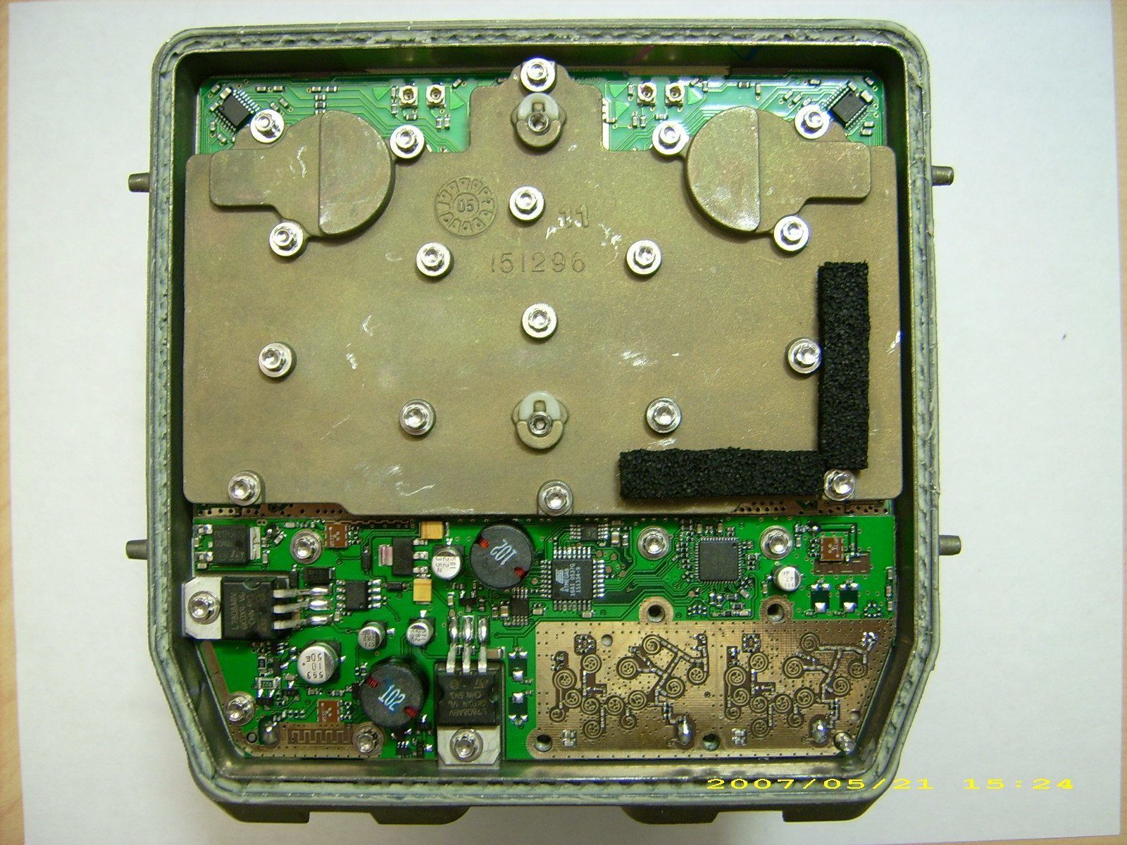

Got bad DPPlus Twin LNBF
and made a picture of internal guts.
Symptom is no signal coming out from both LNBFs, I'll check it to see if I can fixed it.
I'm looking for fix the DPP Twin LNBF; I connected it to lab PS, it show 0.34A load with 19VDC input.
Could someone test good one for the current ?
Next question would be tough one - I measured VR 7808 in a middle - looks good and provide +7.8V output; but at left side same type 7808 doesn't have any voltage on IN and OUT legs. Is it special one and does regulation by switching signal ?
Or I found fault part ? Actually, I think not - it could be input voltage disappeared by other reason.
Any help with schematics of the DPP LNBF would be appreciated.
