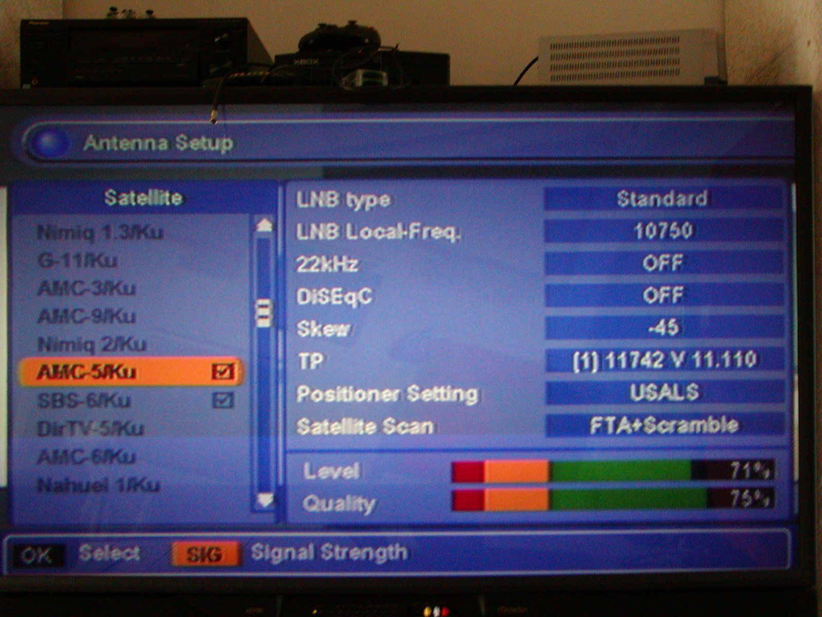

I'm lost :eek: set up my system = pointed at amc 5 - level 71% quality 70 to 75%

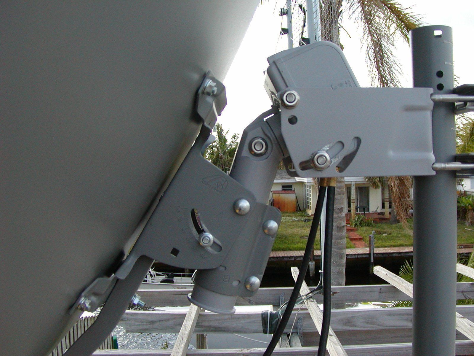

TP 11742 - USALS positioner - when i move the dish with the hh90 motor i can't lock on to any other sat. except sbs-6 with low quality 20-30% I have included a couple of pictures. If anyone can help, that would be great and thanks.:bow :bow
Maybe I just can't use this motor with this dish PC90P. any Help ?

Your dish / motor combination should work fine. There are many adjustments to fine tune to using a motor that can seem to be a pain to adjust before you have it peaked. First, with a motor your LNBF should not be rotated any, as you have it in the picture. The angle of the motor on the mounting pole takes care of the skew of the LNBF automatically for you. The LNBF should be adjusted either closer or farther away from the dish for maximum signal quality. (remember it is signal QUALITY to adjust to not signal strength) When on your true south satellite, try very slightly rotating the motor on the mounting pole for maximum quality. You also have to adjust the angle of the dish on the motor arm for maximum quality. Once this is done for the true south satellite, then move to another satellite, in your case SBS-6 and try pushing on the dish to see what way it has to move to increase the quality. Make small adjustments of the dish and motor, and then return to AMC-5 and check there again. You Generally, the motor angle on the pole (your latitude setting) should be ok once initially set, but you may find that you need to tweek this setting as well. Once you have it set again for AMC-5 again go back to SBS-6 and tweek the adjustments again. Once you have these two set, then venture to another satellite and continue going back and forth to your south satellite tweeking your adjustments. Periodically, go through the list of the satellites you have adjusted to and see what is not lining up again. It is a lengthy process, but once you have it done, you will have maximum signal on all your satellites.
Your HH90 manual on page 10 under fine tracking shows what to expect if what adjustment is off.
The Stab HH90 user guide can be downloaded here:
http://www.fortecstar.com/estore/storefront/default.asp?ProductID=75&CategoryID=10
Look for the link "DownLoad User Guide" at the bottom of the page.

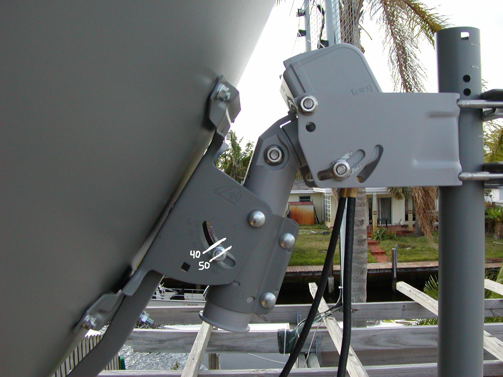

Judging by your pics, Wired, it seems like your dish is set at the wrong elevation. Your dish should be set at between 40 and 41, and from the pics it appears to be set at 50. Couldn't tell from the pics, but what is your motor elevation set to? It should be the same as your latitude, which is 26.

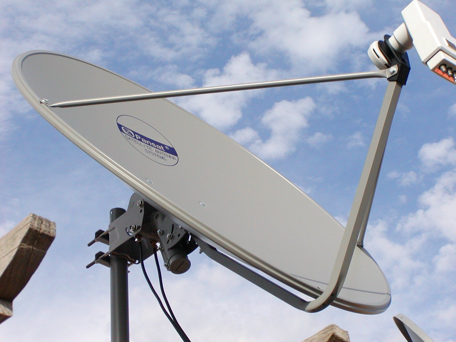

Hey all, I'm still lost with my motor set-up, I have followed everything to the letter. long, lat, elevation, pole level, members advise etc... If someone could take a look at my pictures again and advise, would be great. The only thing i can think of is that the mounting brackets joining dish with motor are wrong causing an improper arch. I did try and re-adjust the placement on the motor arm/pole with no results. I have not found any pictures with this type of dish/elevation to motor bracketing to compare. I am able to pick up a few Sat's but the arch still seems wrong.

Please reread Tron's post. We both looked at your pics and even talked about it over the phone. If your elevation is still the way it was in picture #1 it looks like that is probably the problem.

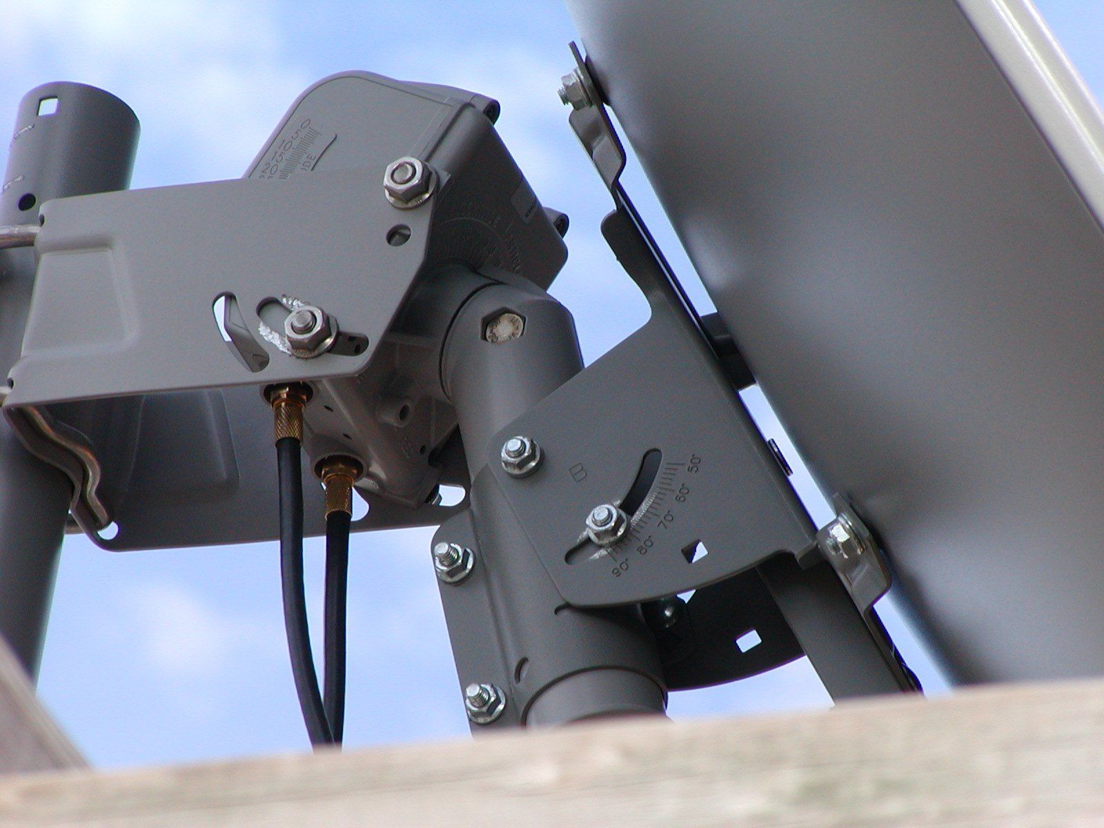

Thanks for your help. i have posted a new picture and my question is should i set the elevation at/thru bolt or on the leading edge, which is what my instructions for the dish note. again thanks for your time in looking. :up

My advice would be to try it at both settings (the bolt and the leading edge), and try tweaking it at both settings a little up and down. The marks are not always entirely accurate.
As Digiblur said, try to mount the dish without the motor. For the time being, try to hit a powerful transponder (such as G-10R's 12114 (V) transponder at 123w). This will give you a good idea of the accuracy of the elevation markings without the motor being involved in the equation.

Thanks digiblur and Tron for the advise :bow I did notice an increase in quality when i elevated dish slightly higher to 42-43. I have set up fixed dishes - dish network, directv and the old VOOM (i miss there complete package) anyway, it seem like its a game of trial and error, rinse and repeat etc.......

I also like the look. But i still have not found any info on dish to motor bracketing to compare to satisfy my curiosity if it works. I am still going to play with it and hopefully I'll get it to work properly. everything else works fine - pansat 3500s - hh90 motor. Just can't get the son of a bitc... to arch correctly. :eek:
Keep trying. I was about to run over my cheap Winegard 76cm and clone motor with my truck when I decided to give it one more shot. I had already managed to peak the dish to IA5 and other birds without the motor and was determined to dead-reckon the installation. I was also inspired by seeing another clone motor's manual say "40-degrees minus declination angle" instead of 30-degrees. First I hooked the motor between the LNBF and receiver without mounting it to make sure the signal still got through the motor (this is a cheap clone motor remember) and got the same signal quality I had without the motor inlined. Then I disassembled the mount and re-plumbed the tube, which I must say wasn't as plumb as it should have been (and is the bane of motorized dish users!!). I then re-assembled the motor on the mount and mounted the dish on the motor. After that I decided I'd cheat the math and deduce the elevation, instead. I turned on the tuner and set the motor for reference position and peaked the dish on the same satellite I had peaked before I had the motor. Then I set the tuner to position the dish for that satellite and watched my perfectly peaked dish move away. Then, I moved the entire mount back and re-peaked the bird I just had and peaked it. The elevation changed slightly and I almost forgot to rotate the LNBF back to verticle (no skew) and the signal was stronger than before! Then I repeated this process with various satellites of interest at extreme ends of the visible arc in my area, and then a few along the arc. I only needed to re-adjust one more time.
I now 'see' everything available on this cheap dish and no-name motor and am very pleased. Only problem is that I mounted it in a temporary position. When I move it I will make a note of the satellite and transponder it's currently looking at and peak the dish to the same satellite and transponder in the new location. I have to pay special attention to plumbing the tube--that is the single most important thing to do with a motor.
