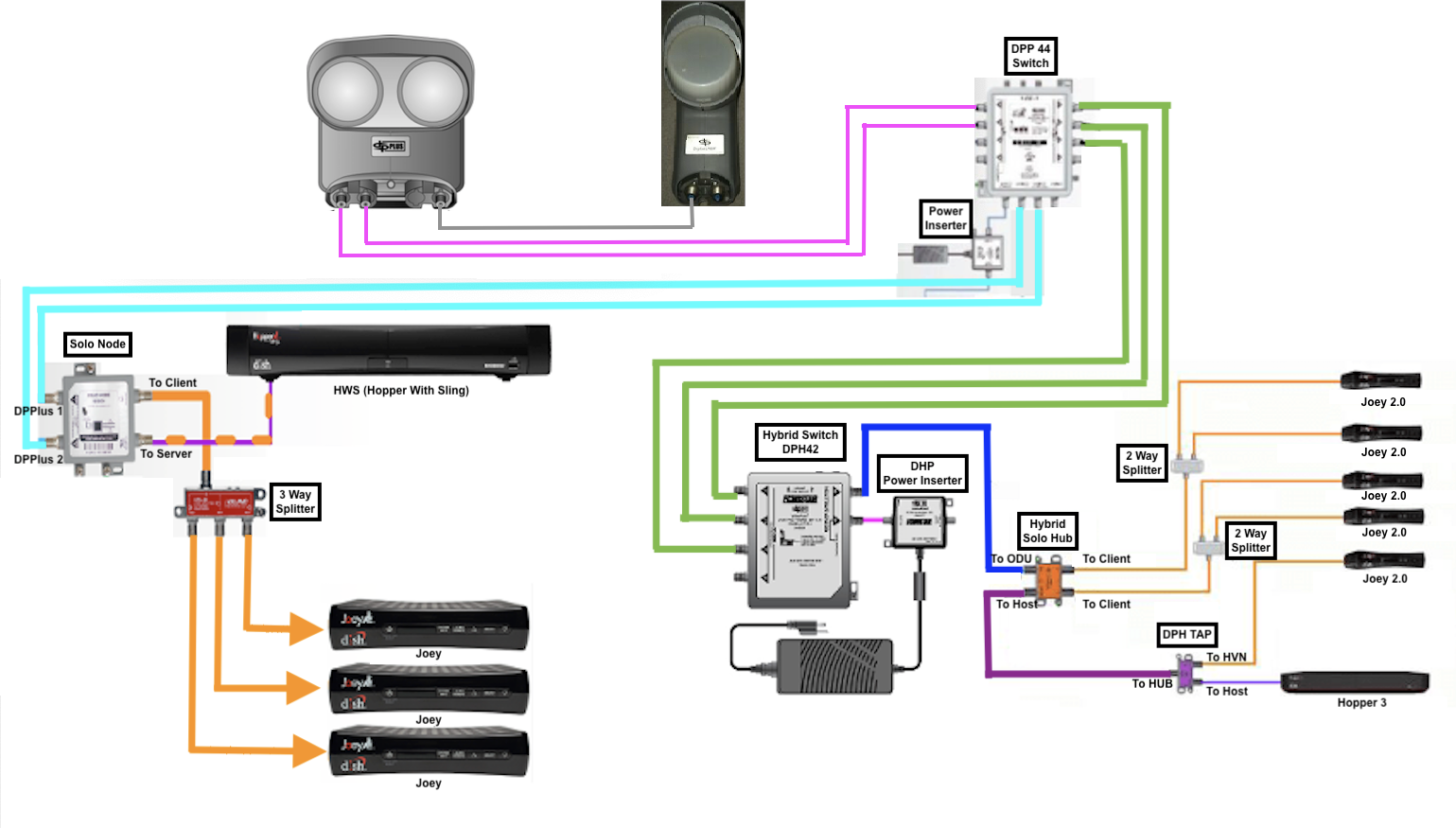

Only one problem with your chart, a DPP LNB will disable its LNB IN port when connected to a switch, so the cable from the DP Sngl/Dual needs to go to the DPP44 directly
Sounds logical....because the DPP44 is locking feeds from the LNBF's and the Twin's internal switch should be activated only when hooked directly to a receiver......
This should work, you also could also use single DP LNBF per orbital slot to use full gain (whole surface) of your (1.8m) off set fed antenna to feed the DPP44:
This is the set-up i have now. all works till 77 changed... hurricane grace is coming but after i will look at levels. At one point last week tech told my husband needed a 1 meter dish (he would use for 110/119) and put 77/72 on the large 1.8 meter channel master (FYI i have VIP 222 to test - that is what i had before i switched to hopper3 - but they no longer let you switch old old not working 222 boxes for another they want you to be on hopper3...) anyway i really appreciate the help. The dishes have been threw 7 hurricanes never had to realign even after wilma cat 5 - i'm hoping Grace is an easy one... again thanks.

Remember there might be options before aiming to Eastern Arc. Also I don't understand why your tech aimed to 119°W & 110°W with the 1.8 m channel master....I think you have more HD content out of 129°W than 110°W so 129°W & 119°W should have been a better option....
if at the end you have to aim Eastern Arc you'll have more content out of 61.5°W than 77°W therefore the larger antenna should give you more aimed to 61.5°W & 72.7°W. FYI if you get eastern arc 61.5°W & 72.7°W there is no need for 119°W & 110°W

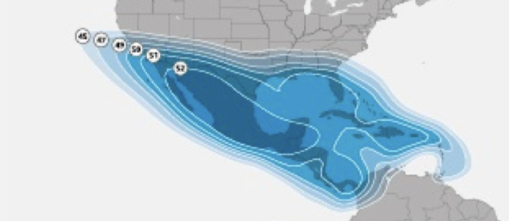

Keep in mind that while Cincinatti locals are now on 72.7, CONUS, that will probably change sooner rather than later. At that time there will be few, if any, locals that are not on spot beams. You will up a creek at that time because I don’t believe any spotbeams anywhere in the USA will reach as far south as you are.

There is one, Cuba. 110 transponder 25 spot 48. Carries about half of PR locals albeit in SD. Only covers a small piece of the southern Mexican states (Cancun seems like a really good place to be if you want to get it).
However, with 110 getting changed out sometime next year, most likely going to be gone soon anyway.

Ok Hurricane Grace (cat 1 but huge surge) is past no electric till today. dish is up and working. On why the large channel master dish is pointed at 119/110 is its a old system 20+ years and when set-up we got locals from 119 (nyc & la).. i think he just never changed. So if I'm reading this correct - I'm out for changing address for 77. and what your saying is i ask the tech to align the big dish to eastern arc (61.5 & 72.7) and no dish for 119/110??? by the way i really don't care is sd or hd just want my shows. FYI: even though i don't get 77 (cinn) i still get on Demand Locals (so must be on 119/110?) and if it come down to it i can watch that way....but because of that maybe its wise to use the 1 meter dish for 110/119???
