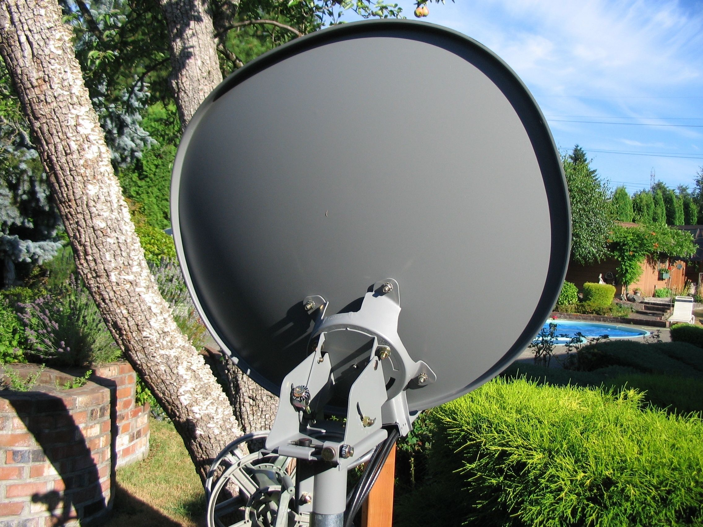

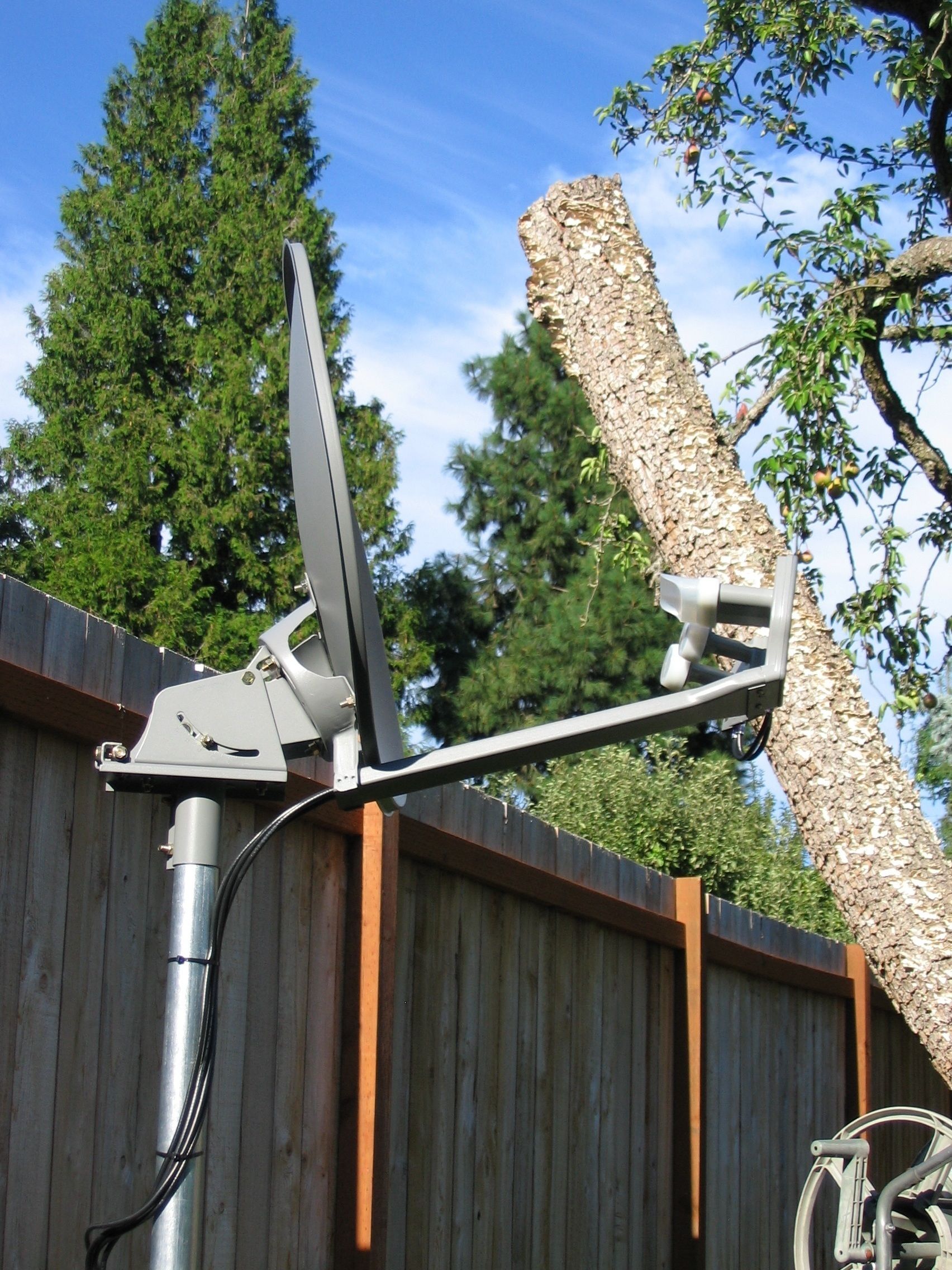

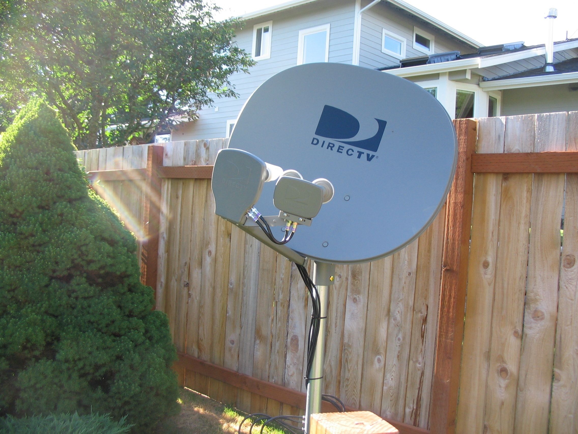

Oh we NEED photos of that!! It MIGHT be the slimline everyone is waiting to see. Please post ASAP!
Pictures of the new dish
here are the pictures you were asking for.
Darn, no smaller; its the same dimensioned AT9. Thanks for the pics. This is what the "slimline" dish is supposed to look like. It will more than likely have the same or slightly more reflective surface (gain value) by being wider and not as tall. Maybe not metal either; so lighter weight. The photo of the prototype appears to have a metal dish.

How do you know??? :confused:
He said it was a little smaller than the AT9, (unless I was not understanding him correctly).
His photos appear to show the exact same AT9 make, assuming he had the AT9 5 LNB dish before as he said, he has the same thing now. There are not going to be any spec differences on the same series dish run, even between factories; they use a DirecTV provided pattern, to ensure that the dimensions and gain values/surface reflection area remains consistently the same. Exactly the way all the makers of the PhaseIII and the original 18" dish did before.
