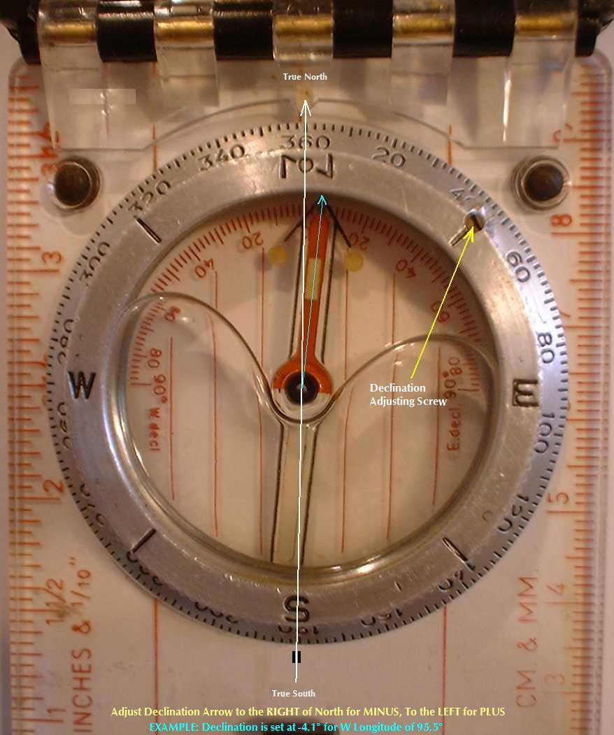

Wyr
Declination – True, by Compass.
This is the procedure how to set the Magnetic Declination (MD) on a Compass and subsequently find True North/South.
First of all, you will have to “find/know” your MD, and the easiest way I know to do that, is to go to:
http://www.topozone.com/
Type in the City Name, and select the State, then when the new screen appears, click on your City which is located under the word “Place”. Sometimes there are multiple selections, so choose the one that is closer to the place you want the MD of.
Then, you will see the Map of the location. At this time, you should look to the Right Column, where you will find a selector for how you want the location displayed in Geographiametrics.
Select:
UTM,
Decimal: DD.DDD, (most popular)
Degrees & Decimal Minutes, DD.MM.MM or
Degrees/Minutes/Seconds.
IF you wish, you may enlarge the Map for a clearer view, and page up/dn/R/L, to select a specific area of the City to display. This will only change your MD about 0.1°, unless the City you’re locating in, is very large.
Once locating the specific area if chosen, look down on the lower right side of the page, and see your MD displayed in a small Avatar which has Arrows and Letters. The amount of MD is displayed in/with red, and "M =" is the value of the Magnetic Declination in Degrees, of the location highlighted on/in the Topo Map, indicated by a Red “+”.
Example: If you had typed in “Houston”, then selected “TX”, then when the next screen appeared, you clicked on Houston which was under the word “Place” on the next screen displayed. The MD you would see would be a (minus) – 4.06° (+/- 0.1°).
I offer this so you can check if you’re looking in the right place for the MD. Then back up to the first screen, and type in your location of interest.
Now, please refer to the Attachment. Houston13.jpg.
First, please notice the Adjustment Screw, identified in Text and the color line in yellow.
This rotates the “Arrow/Declination” plate, inside the Compass Ring, where you set the MD, for Plus or Minus.
If you need “Minus” MD, the Arrow Point should be moved to the RIGHT side of North, in the amount indicated on the Topo Map.
As you can see, the picture displays the Arrow to the Right of North, and though it’s hard to see, it IS set for – 4.06°.
If you live in the Eastern US, you would set the Arrow Point to the LEFT side of North, to get a “Plus” MD.
There is a scale on the Plate, and you would set the amount of MD directly at/under the mark which indicates “N/360°” on the Compass Ring.
Once this is set, use the Compass as it’s instructions state, by rotating the Frame to place the Cursor inside the Arrow, and True North/South is indicated by the “White” center line of the Compass.
