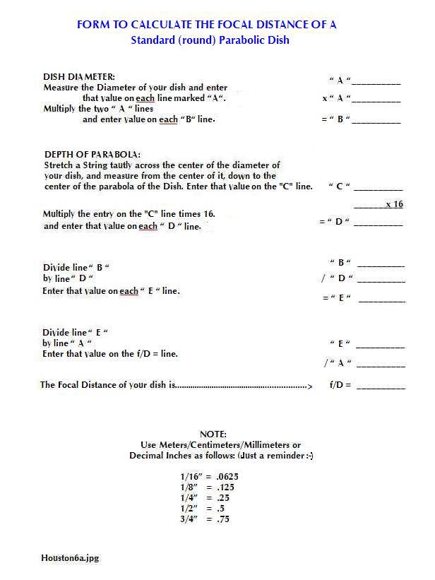

Subsequent to my original Post in this thread, I still have not been able to verify that my LNB is in the correct location, as described in the attachment (Houston1.jpg) on Pg1 of this thread. I appreciate Global10's offering of the information located at http://www.vhfcomm.co.uk/otypka.htm. But, that's WAY over my head, and I'd appreciate it if someone who has had Algebra a bit more recently than me, would read it and see if the measurements can be verified.

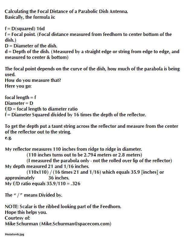

In the course of attempting to understand the formulas and apply them, I encountered a written description of calculating the Focal Distance of a STANDARD (round) Parabolic Antenna see (Houston6.jpg).
I appreciate Mike Schurman's contribution, and I hope he will appreciate me giving him credit for it, but he has NO idea that I've used it! It was on the Internet, so surely he won't mind. ;-) I tried to Email him, but it bounced back.
I have made a "simple" Form (Houston6a.jpg), which is my understanding of the application of math that Mr. Schurman used in his description. Please feel free to copy/use the form, it may be of some value to you or others.
Hay, I'm retired, what else do I do with my time :)
I unfortunately, have not run across any "simple" explanation, OR form, to help me out. :(

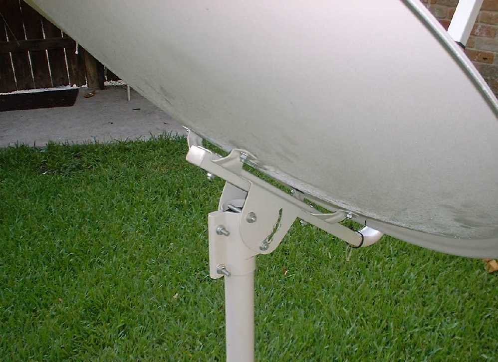

Thanks for the reply, but, since my Dish would slide up on the Motor Shaft (then bolt through it) I just can't imagine how that works! I reviewed the pictures you posted on Pg 2 of this thread, but, they didn't actually show the Dish Clamp connection, to the Motor Shaft. Once I see it, I'm probably going to be embarrassed, seeing how simple it is, but, until I do, I'm still in the dark about that. Am attaching a picture of a (PM-900.jpg) motor (courtesy of www.JustFTA.com), and I see where the Dish Clamp slips up on the (typical) Motor Shaft. So, how do you slip a 40mm Clamp, on a larger (by a lot) Motor Shaft? Please look at (HotDish75b.jpg) which is my Dish. I just don't see how I can use it with those type Motors!?
PSB,
Given what I just wrote to Iceberg, the site you referenced, led me to see the installation diagram for the HH100 Stab polar mount alignment and set up. They've turned the Motor over! Your Avatar and every other example I've seen of an installation, shows the Motor Shaft pointing downward! Seems like that may "mess" with the DiSEqC, or does the Receiver care just what position to remember for a certain sat? And, wouldn't the Arc be reversed? However, given the cramped assembly of my Dish (HotDish75b.jpg), this approach may be the only way I can get it on a Motor!
iammike,
I checked out the url you posted, and I have seen that before, much appreciated though. Sure wish it had as many free channels as the numbers list, and I have downloaded several of the individual pages, where I can see just what I can get, Thanks.
Tron,
I'm very fortunate to have (accidentally) bought a home, in just about the highest place in Houston. Am at about 75ft, which is above the 500yr line. I hosted (a friends family) when Katrina hit, understanding how they felt, having to leave everything behind. As materialistic as I am, I think I would have died, or died trying to stay, I don't know which. The problem here is getting to and from my house, I'm on an Island almost, when the water gets real high. I really put the emphasis on lots of drinking water containers and fuel for cooking outside (IF that's possible)! Main problem here, is Electrical Power. Learned my Cooler (Ice Chest) lesson back in 1983 with Carla (I think it was). I didn't know I could get that much stuff on the Grill, it was thawing out faster than I could cook it! :)
But, being pretty high like that, is why I wanted to really have a "beefy" system, experience the stronger winds because of that (height). I understand not to rotate it when the wind is really whipping, Iceberg mentioned this too, I just don't want to give up the "viewing", or, get up on the ladder and mess with it, while they're updating to a higher Category. Got a 2 story house, very seasoned tall trees and can't put the Dish on the ground, got to get it up on the roof. Have designed a really sturdy roof/eve mount, which is adjustable for Level/Plumb, and just wanted to get the toughest motor available.
The way my Dish is made, IF I had to disassemble it, it wouldn't be all that complicated. Just has four (4) ¼" bolts, holding it (reflector) and the LNBF beam has two (2) to the Ele Pivot. Remove those and the RG6, and leave the Motor and Pivot up for the duration. But, the basic design is intended for a Cat 3. Have some drawings of the mount (Roof & Eve) applications, which I'll post at some point, when I've reviewed them again.

Unless the shaft is HUGE, you should be able to loosen the back bolts on the dish (the ones to clamp it to the mast) to slide it up the shaft of the motor.
I was able to get a 1 5/8" mount on a 2" mast…it was a bugger but I got it to work :D

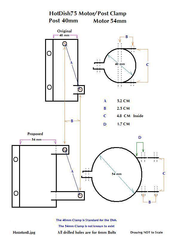

I've either got to find another Clamp that moves that Dish out away from the Bent Post, or, use it as a Planter and get myself another Dish that really works.

PS: Am attaching a drawing (Houston8.jpg) of the Clamp I need, not that it exists!
