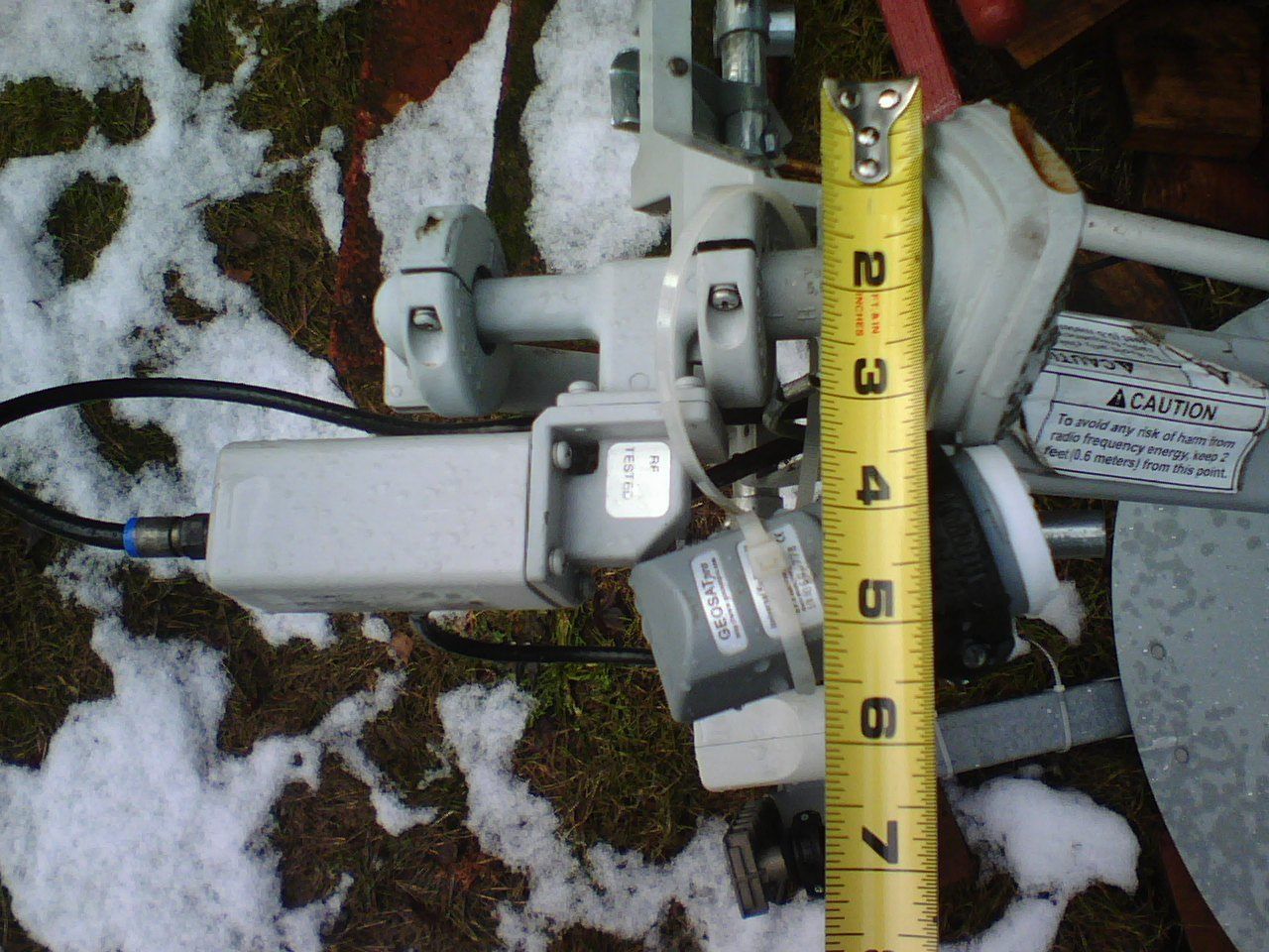

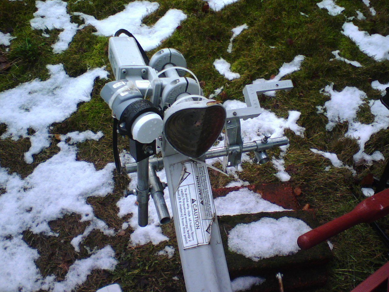

What I found when I was tinkering with the Tx/Rx setup is that the pipe had 2 lines indicating H and V but after trying to pickup transponders I found that to be the reverse. Look at how the first picture has the H with all of the Skew lines around it.
It's as though the H/V lines were for the Tx polarity and the Rx was automatically opposite.
To pick up Vertical channels the setup needed to be set to H and vice versa.
These pictures are from last winter. The dish was aimed at 123W to pick up RTN, later Equity (which are/were Vertical) until I started to move on. The Geosatpro LNBF is aimed at 129W for Whitesprings TV.
If I really need to I can go haul out the whole getup if that wasn't clear enough
this post clearly states (and shows) exactly what I was trieing to say. I'll not bother to post my photo as it is just like the first one here. Starband does indeed refer to polarity sort of backwards.
